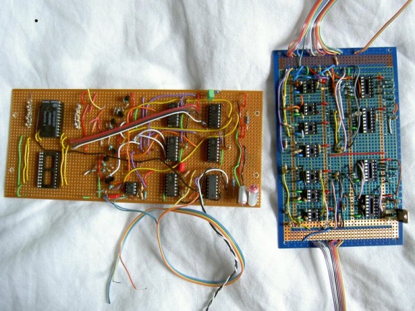

Hi,I find Ken Stone is the master of CMOS.
I've built his Pulse Divider with three 4017s and instead used a 4520 to do the 2,4,8.It does 2,3,4,5,6,7 & 8.As a fixed divisional system.I constructed on veroboard,with added 4093 clock oscillator and an added 4011 touch stop start switch.
There's no reason you couldn't incorporate further divisions with a 4040 or even /10 /11 /13 etc with strung 4017s.Chips wise it's easier to patch AND gates so for instance it only pulses when the 5 and 6 go high to give you /30.
With automation in mind his two votage controlled dividers are interesting devices.I've just completed both.
Jurgen Haible has a VCdivider too,but it was a little over complicated compared to Ken's designs.Both fire comparators to interrupt gates.
Here's the two boards for size comparisons....
Vero board left is post hack pre installation tidy....adding on 2 big 4067s to use the other side of the 4520.
Hence the long wires Shocked
Other chips Lm358,4011,4093 across the bottom.3 * 4017 and one 4520.Output transistors all 3904.
RS board on the right ,second generation VC divider above red long wire,first gen below.
Using a LM311 to fire out at the bottom.
I prefer to use thick Valve (6A 1000V) coloured single core so i can see what's going on.With the ultra slim wire that these boards were used with in the 70s,it looks beautiful but is harder to trace.
When i run out of these RS boards which were given to me (£25 a piece!) i intend to order the similiar Futuretech boards that Scott likes.Much cleaner finish than the spaghetti vero even counting the dozens of cut tracks underneath.I've had enough of vero...including the blisters from holing them!
Hope helps!
Robert
