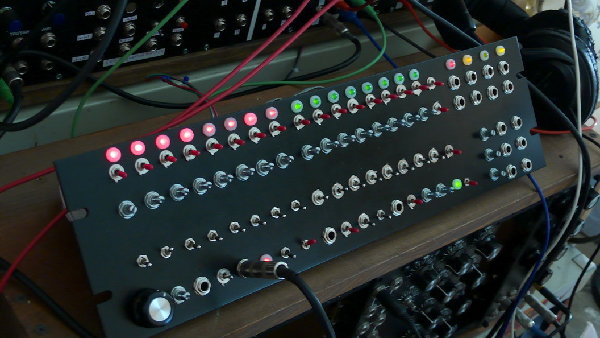

Ok, this has been quite a project! I am very happy to be done building. Everything looks like it works. My Klee is Kleeing and Klonking happily. Now to calibrate and learn how to program it. I love what I hear so far. Stay tuned for a youtube video soon. Fun fun fun!
A big thank you goes out to all who contributed to this awesome project.

The LED bezels worked out great. They disperse the light nicely.

Nice job....like the light combinations.

Is that a 3 high rack panel? If so, that's fairly economical on space.
I, too, like your LED arrangement.

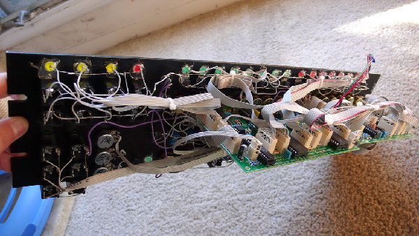

Very nice job. To build something like this is quite rewarding, isn't it. Look forward to hearing what this sequencer will do.
Posts: 2756
PostPosted: Mon Dec 03, 2007 7:49 pm    Post subject: Reply with quote  Mark this post and the followings unread
Great job. I like the use of the ribbon cable as it is very space efficient. Very Happy I agree also, great use of panel space .....

Thanks guys! The rack panel is three spaces. Its took a bit of planning to make everything fit. I used Fonik's old rack panel as reference. I actually have a tiny area to fit a few extra bits in the future, in case folks come up with some mods. Check out the video, I just finished uploading it earlier today.
