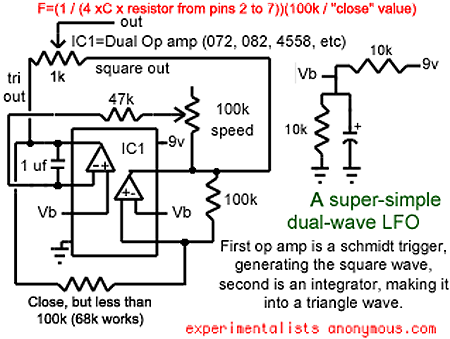

I was looking for some mini-LFO, (in matter of size of the PCB, and complexity) to put it into mini-modular-audio processor. With such simplicity i could put 2 of them. But they would be useful to me only having simple triangle modulation.
For my n00b electronic knowledge if i connect together saw and ramp i should get triange, right? If now, where else should i look for these simple 0-5V tri LFOs ? Its a simple question, really.

sine tri ...
http://www.elexs.de/sinus1.htm
replace the 0,1 µF whith a 100µF elektrol Cap
u can turn a saw in a triangle wave,
imagine cut the positive and the negative part of the saw in 2 pieces
mirror the negative to positive --> u got a tri wave
Select neither, that is, use a switch with a center off position. Or omit the diodes, switch and R1 altogether. But that MFOS circuit runs on +/-12v. For a single-supply LFO you could use the one in the DS-7. It runs on 5volts and uses half an LM324, so you could get 2 out of one IC.
Here's another simple one that might work at 5volts.
