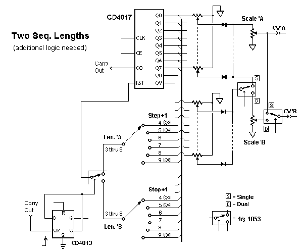

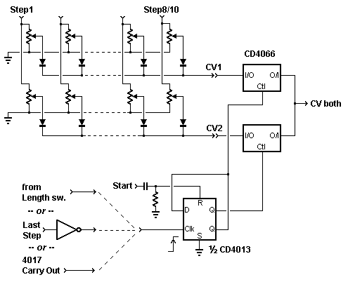

The basic idea is to use the end of the last step, whichever that may be, to toggle a flipflop to switch between two sets of pots. Call 'em 'A and 'B. Should be applicable to both 4017- or shift register-based sequencers.
One shortcoming I forsee is if there's no Start button or switch then which set of pots "goes first" could be unpredictable. Also, only an even number of steps is possible: a Length of 6 or 7 would give 12 or 14 steps, but there's no way to get 13 or 15 steps.
The two remaining 4066 switches could toggle between 2 gate/trigger busses.
Instead of a 4066, a 4053 triple 2-channel AnaMux©, having an Enable pin, might be more versatile.
These are just ideas.

nice idea!
Guess you could and the reset with one of the flip flop outputs to get a choice of a reset on an odd step in the first or second run ... grmpf I cant get line breaks in here with firefox 6 on a mac ...
I thought the same at first but that significantly changes the operation as the 4017 will always run to the end on the first pass if you qualify reset with Q. Maybe that's how you make it work though, the flip-flop output is not symmetrical, the 4017 output 10 always clocks the flip-flop and reset for sequences of 10 or more steps is qualified with Q. The flip-flop and 4017 resets are tied together and that solves the random bank problem...mostly...I think there's still an issue with a count of 20 where you don't have a reset.
Trying to think this through as I type.
What if you interleave the outputs rather than have sequential banks? The input clock goes to the flip-flip clock, not the 4017, the flip-flop outputs control the 4066s and /Q clocks the 4017. Resets are tied together again. Might work. Still would need to AND the step out and Q to get odd count sequences.
richardc64
Joined: Jun 01, 2006
Posts: 649
Audio files: 26
PostPosted: Sat Sep 17, 2011 5:16 am    Post subject: Re: Faking 16/20 steps possible?
Subject description: There may be glitches...
Hmmm...an interesting thought. Meanwhile, I thought of alternating between two "Length" selectors. When in "Dual" mode the B length is disabled; there'd be two CV channels (A & B) of up to 8 steps. In "Single" mode longer sequences, including odd, (by selecting, say, A=8 & B=7,) would be possible.
But it's already beginning to get unwieldy, and I haven't even begun to think about alternating the Gate outs. It might be simpler to build two Baby8's reset and clocked together for two sync'ed 8-steps, with the chaining circuit discussed here http://electro-music.com/forum/topic-49549.html switched in for a longer single channel.
Perhaps the whole "alternating" idea is better suited for a counter plus decoder(s) -type sequencer.
