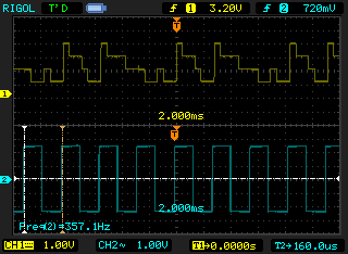

I'm not 100% sure if this is the right place, but since I want this for my lunetta-projects, I though I ask here...
Since manufactured PCBs are not a luxury anymore (under 1$ per piece for 5x5cm boards) I thought It would be pretty nice to have a custom prototyping-board for cmos chips. Cool
I made a layout for such a board:
It fits on 5x5cm (the cheapest size in most boardhouses),
It is somewhat similar to a solderless breadboard
it has 4 mounting holes for m3 screws
Vss and Vdd connections are prewired for 16 pin CMOS chips, but 14 pin CMOS or something like a dual opamp will fit too...
I will add a silkscreen on the component side to make it clear which points are connected.
What do you think?
Would you find such a board to be handy?
What would you add/ make differently?
(keep in mind that this a picture of the bottom layer... so it's the wrong way around...)

I really like it! It looks like it would be very easy to use. I'd make the horizontal row that connects to V+ also square though to stop confusion.

Looks good!
I'd take it to the next level and start thinking about connectivity with other boards of the same design.
Maybe add a "power port" or something where you've got one pad for ground and one for VCC right next to each other on the edge of the board, just so that it's easy to hook up.
Maybe a 4-pin header with a signal in / signal out plus power? I know you want to keep this board generic, so maybe that's not a good idea.
How do you hook up potentiometers? Other common off-board circuit elements that you use? LEDs?
But don't overthink it either. It looks great, and I'd get a run of them made first, and then play around with it and see what's right to change.
With prototypes like this, I've always gotta get the circuits in hand and build some stuff with 'em to see what works and what doesn't.

All good Ideas!
but yeah...I guess I'll have a few made and then see what I need...
I also think that adding more specialized options would be a better fit for a a bit bigger board (5x10 or even 10x10).
Maybe it would also be handy to panelize 2 boards on to 1 board with drill holes.
They could share the power lines and be separated or used together as needed...
this it what it would look like with added silkscreen layer:
(Of course I'd be happy to share the gerbers or DipTrace files if anybody is interested...)

nice layout. I would personally not make those (horizontal) connections for the powerpins of the IC's fixed,
which would make it a bit more universal but for CMOS it does makes sense. (although CD4049/4050 uses pins 1 and 8 )
I'd also connect both power rails from top to bottom, so the 'squares' aswell.

Yeah...I'm not sure about connecting the power-pins too...
Also because it would be a nice board for a quad opamp too (even without a third power rail)...
...on the other hand I could just order 10 with fixed power connections and 10 without.
I think I will follow your suggestion of 'connecting the squares'.
