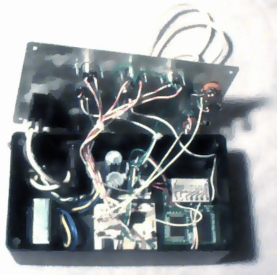

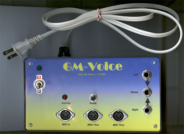

Attached are two photos of my unit. I only have a $25 digital camera, so the quality is a bit punk. but you'll get the general idea. The whole thing is about the size of a brick and looks very nice.
Okay Antman, care to jump here?
Thomas Henry
Front panel of the GM Voice
 Filesize:  47.73 KB
 Viewed:  71665 Time(s)
Guts of the GM Voice
 Filesize:  40.82 KB

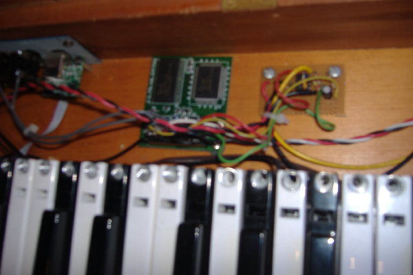

1. Interestingly enough, Thomas has created a desktop module. When we started 10 years ago, I was going for the desktop mounting and bet Thomas he couldn't resist a rack panel due to his track record. So I went ahead and built a 1u rack panel! It still resides proudly in my main rack.
2. I am in the process of building 2 master midi keyboards: a 4-octave unit with pitch and mod wheels and a 5-octave one with a joystick. Both will contain a Gm Voice. The 4-octave one is complete and I wrote it up on the DIY forum. That unit has the same card that Thomas has. The 5-octave joystick unit will have a Yamaha db50XG board.
3. Thomas added the reset button because his unit had trouble a couple times with the RC reset. I've never had any problems and do not have a reset button on my 3 units. I did notice that i used a 47uF cap instead of the prescribed 10uF one.
4. Searching for a card on ebay....a little harder than a normal ebay search. My best finds are just searching for a "soundblaster" under computer desktop peripherals and examining the posted photos. The cards are daughterboards, so if you see a soundblaster with a board stuck to it, you're in luck. Quite often, the seller doesn't even mention it.

PostPosted: Sun Nov 11, 2007 5:36 pm    Post subject: Reply with quote  Mark this post and the followings unread
Dear Folks,
Here's some photos on my 2 Gm Voices. One is rack mounted and was built nearly 10 years ago when Thomas and I started this whole mess. It's the purple (yeah, I know Embarassed ) panel in the middle of the rack.
The other is built into my 4 octave midi controller. Note the daughterboard and the interface board built on perfboard to the right.
 Filesize:  702.93 KB
 Viewed:  986 Time(s)
 Filesize:  576.37 KB
 Viewed:  1050 Time(s)
