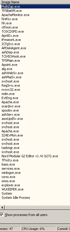

Blue Hell
Posts: 19590
Audio files: 116
G2 patch files: 317
PostPosted: Mon Apr 28, 2008 2:31 pm    Post subject: Reply with quote  Mark this post and the followings unread
so which ones am I going to kill ... I could do without the battery monitor I guess ...

Sam_Zen
Joined: Mar 08, 2008
Posts: 251
Location: NL
PostPosted: Mon Apr 28, 2008 7:10 pm    Post subject: Reply with quote  Mark this post and the followings unread
A nice list, Uncle Krunkus .. I'm obviously smokin' (anyway).
And lately I found a nice free tool for further trimming of the boot : Startuprun at Nirsoft.
Kassen wrote:
you can do all of what those programs do yourself with the management of processes and some registry editing and various settings.
I fully agree. I know my ways too in the meantime.
But if I'm uncertain about someone's skills, I will not quickly advise to poke around in the registry for example.
Talking about unstable. I once made the jump from 3.11 to NT 4.0 ...
2 Blue Hell
If using a laptop a battery monitor is quite useful, so that wouldn't be my first priority to remove.
That's more something like the clock.
If I look at that list I think I see quite some applications of which I suppose they have nothing to do with the boot-process.
Is 'MultiZap' really necessary ? Even FireFox is not part of the OS.
I don't think it's a matter of 'killing' anything, but just remove it from the taskbar at boot.
The programs are still available in some way if you like to activate them on a certain moment later on.
Do you use 'TFricKy.exe' all the time during a daily session ?
Of course services like 'svchost.exe' shouldn't be disabled, because things would go wrong.
But here the fact that there is a duplicate of this one in the list, starts being questionable, and probably could be removed.
Suppose you're working for hours on your set with some wav-files to make some proper mix for example.
What's the purpose of having loaded a browser all that time ?
In fact, when looking at services at startup, it's not only a matter of disabling or not, like in the Ctrl+Alt+Del dialog.
When going to Configuration/System management/Services one is offered 3 options instead of 2.
a) Automatic - it will be loaded at boot.
b) Manual - the service will be loaded on the moment the relevant application is activated.
c) Switched off - No load at all.
So mode b) is a possible escape to drastic decisions, to see if anything still functions well in the order of time.

Blue Hell
Posts: 19590
Audio files: 116
G2 patch files: 317
PostPosted: Tue Apr 29, 2008 4:52 pm    Post subject: Reply with quote  Mark this post and the followings unread
Sam, this is not the boot time list, this is with some software open.
Like multizap is my remote volume control for the sound card on another computer, the apache webserver is used for testing web stuff - I use it often, hh.exe was running because I had the PHP help open. There are four or five processes used for the wireless connection, some four or five for the virus scanner ... the tfncky thingy is used, I need it to brighten and dim the display, it needs to be dimmed at night at brightened during day time .. and that tool in turn needs the TCtrlIoHook thingie.
The various svchosts are running different network tasks, and they are started by windows as needed ... the battery monitor is not that useful for me as I run my laptops mains powered nearly always. I could kill a few others, not that many really.
A lot of this would not be needed for a music workstation that is not connected to the internet and that would be the main optimization thing IMO. Laptops tend to run more processes than workstations anyway, out of the box that is.
On the other hand there is not really a reason to worry too much about a lot of processes running as long as they consume little resources. My main resource hog usually is firefox ... which would not need to be running when making music. Firefox must be restarted every once in a while anyway ...
The other performance bottleneck is the hard disk, especially when it's well filled - keep hard disks empty!
This particular laptop uses no memory sharing for the video card, and that's a very good idea.
To go back to processes ... I'd like to recommend process explorer originally made by sysinternals, and although microsoft took over that company the tools are still available and not altered - it will show you the dependencies between the various running tasks. Like that System started smss which started crss which started winlogon which started services which started apache which started apache etc. It also tells me that on that same laptop there are 707 threads running using 11515 handles, what dll's are used etc.
I could use some tool to manage processes in groups, for instance when I don't need the wireless network I could kill like four or five processes, but once I did I have to think very hard which ones to turn on again to have the wireless link active again .. I could reboot of course, but why not dynamically manage such sets. Sort of hardware profiles, but then for processes and not for devices.
The whole idea of reducing he number of running processes seems to be based on the idea of using the computer for one purpose .. and I don't do that, I write software, I develop web stuff and I make music .. sometimes I need wireless sometimes not and it's just too clumsy now to reconfigure everything when I change my focus .. so I start up more.
