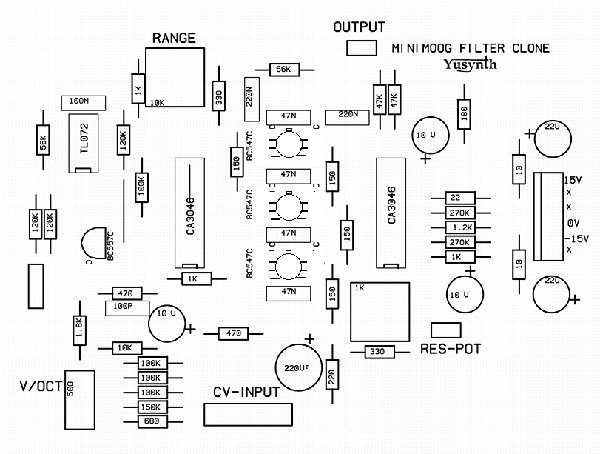

1. On the parts placement schematic, that is here:
http://yusynth.net/Modular/Commun/MOOGVCF/Moogfilter-layout.jpg
you see the vertical line of four 47n capacitors.
On the PCB it actually says 22n where those are in the pic. Should I just use the 47n from the component kit and that's it?

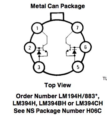

The 3 matched transistor pairs (BC547) that lie in between have in my kit been replaced with 3 round IC's that read: LM394CH while bridechamber says on their site:
"includes 3 SSM2210 for matched pairs"
The LM394CH looks allmost the same as this:
http://media.digikey.com/photos/Analog%20Devices%20Photos/505-TO-78.jpg
Are these used instead of the SSM 2210? How do i place them exactly? (pin up or down etc)
Cheers Smile

PostPosted: Fri Nov 28, 2008 12:33 am    Post subject: Reply with quote  Mark this post and the followings unread
it says 47n on the schematic so id go with that
lm394 is ok and pin 1 (should have a dot on this corner) should be in the top left corner according of each bc547 pair
check out the datasheet if you need any more info
just google lm394 datasheet
if you look at the bc547 you will notice the lm394 is just 2 transistors and you can match the collectors/emiiters up with the board pattern

Question 1:
both 22nF and 47nF are correct but I have found that I got a faithfuller minimoog sounding using 47nF, therefore I'd suggest that you go for the 47nF caps.
Question 2:
Yes the LM394 are there provided as substitute for the SSM2210 which are already substitue for the BC547s.
See below the layout diagram
LM394 metal can pinout
