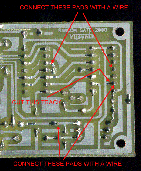

Hello Yves,
i got today my ICs, so i finished my two Yusynth Random gates,
but both have the same Issue: ( the modification of R3 and R4 was done )
There is no shifting, only one LED is blinking with trigger switch to on,
and lighting when trigger switch is off.
The associated trigger out behaves the same as the LED
I see no boobs, all Bridges are in.
I tryed with boosting the clock input to be shure that it is not cause of to low level.
ahhh, one thing:
the trigger switch is not wired yet , but this should not affect anything i assume.
It's such a simple circuit.........
but i forgot to "piep" the unpopulated PCbs to check for any shorts from etching. From Eye it looked good.
any Ideas Yves ?

Hi Funky40
Have you swapped the ICs between your two boards ?
Do you have a scope to check the signals ?
The behaviour you describe means that the clock in is working but the shift register doesn't shift.
Check that on pin3 of the 4006 you can see the clock signal.
With a scope check what's happening at pins 1,4,5 and 13 of the 4006 they level should change from 0V ro 15V at random rate. If not check that you have the right voltage on pin 14 of the 4006.
You should "pip" your tracks for this circuit remember what I wrote on my page
IMPORTANT NOTE : Don't forget the four straps. Also because some tracks are quite thin and located very close to each others, check thoroughly the PCB tracks with a looking glass in order to detect the possible copper micro-bridges (ill-etching) and track micro-cuts.
Yves

I gave some thoughts to your problem and also I had other returns from some people experiencing difficulties with this module.
It appeared that those other persons used different brands of the CD4006, in fact they were using HEF4006 or MC14006 which are given as equivalents of the CD4006.
I run some tests with my two built modules and I came to the conclusion that the circuit as is, works fine with true CD4006, but does not with HEF4006 and MC14006.
I checked the datasheet and noticed that these two late brands need a more stringent clock signal (in fact with a very steep falling edge).
Therefore I modified my circuit to improve the shape of the clock pulse and this is quite easy because I had two unused XOR gates in U3 (CD4070). I connected one of these gates with one input ( pin 13) connected to the collector of Q1 and the second input (pin 12) to ground, removed the strap between collector of Q1 and pin3 of U1 and then connected the output of the gate (pin 11 of U3) to pin 3 of U1.
And it solves all the troubles, it works perfectly now with both HEF4006 and MC14006. It works at high clock rates too !
I suggest you make that mod to your module and it should fix the problems you have.
I will propose very soon a corrected schematic and PCB on my site !
Yves

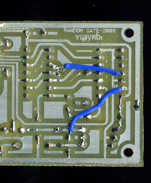

Hi
here are the modifications to the PCB: removing a strap, cutting a track and connecting two wires.
With these mods, any 4006 can be used either CD4006 or HEF4006 or MC14006. I have not tested other brands than those mentioned before.

I did the modification now, but it is not running anymore. Only one LED is lighthing, no shifting with a patched clock (pulse/saw )
I just used the pins of the removed strap for the two wires.
one going to Pin13/U3, then back from Pin11 to where the strap goes (pin3/U1), plus the wire to ground from Pin12 of U3.
This is correct i think, can't see any faults.
ahhhh, you cut a track ?
it is from the drawing not clear to me which track.
edit: have not seen the second picture. I have also the wire to Ground from Pin12/U3, but still can't see the track to cut
edit2: i just recognised Pin12/U3 is allready to ground by default

ahhh ok, you cut the track from Ground to Pin137U3. i try Wink

okydoky, the baby is kicking.
Very good feeling to debug respectivly modifie a module Very Happy
thank you very much Yves. Very Happy
gonna resolder the second unit now........and then i'm hungry. well, i'm allready Laughing
edit: ok, #2 is kicking too as it looks ( the LEDs are not yet sticked to the frontpanel)
