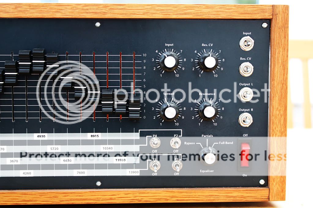

Here's some pix of my JH string filter with 40 sliders Shocked
I've gone for the vintage Radiogram look, still work in progress but 90% complete.

Awesome. Simply awesome. I wish I had the time to build a version like that. Well, I don't even have the space, and should rather think of selling some of my prototypes of various projects rather than building more. But anyway: It's stunning to see instruments built from my PCBs that surpass what I had actually in mind when I designed them. Love it!
JH.
Many thanks for the kind words Jurgen, I'm humbled. Embarassed
Your designs are truly outstanding and it is only this that allows us to build modules that go way beyond anything similar; keep up the good work!
Can't wait to get started on my Living Vocoder Wink

Wow, very impressive. I love sliders...though I can't seem to really source ones I like. What sliders/knobs did you use for that thing? I assume they're PCB mounted?

PostPosted: Mon May 17, 2010 4:35 am    Post subject: Reply with quote  Mark this post and the followings unread
60mm slide pots and matching knobs were from Rapid Electronics in the UK http://www.rapidonline.com/sku/Electronic-Components/Resistors-Potentiometer/Control-Potentiometers/Slide-potentiometers/65234/66-0140
They are 10K log rather than specified value (50K of 100K?), however I checked it out with JH and 10K Log work fine. The pots are not fitted to a pcb or matrix board, they are fitted inside a timber frame with a couple of removable retainer strips so that I can replace any sliders should they fail, they are all hand wired - lots of work! I designed this part first then designed the panel around the slider centres I ended up with. Certainly possible to fit them to a pcb but it would be expensive as a one off. Front panel was made by Schaeffer as a plain aluminium panel with cutouts, this had a glossy photo paper printed overlay which was glued on then sprayed with 3 coats of satin acrylic laquer for protection. I am lucky that I have access to a large format A0 size printer which prints to a roll of thick glossy photo paper Very Happy I have panel in Shaeffer/ front panel express .fpd format if you need it - obviously it will only work with the same pots I've used or narrower ones fitted to a pcb.

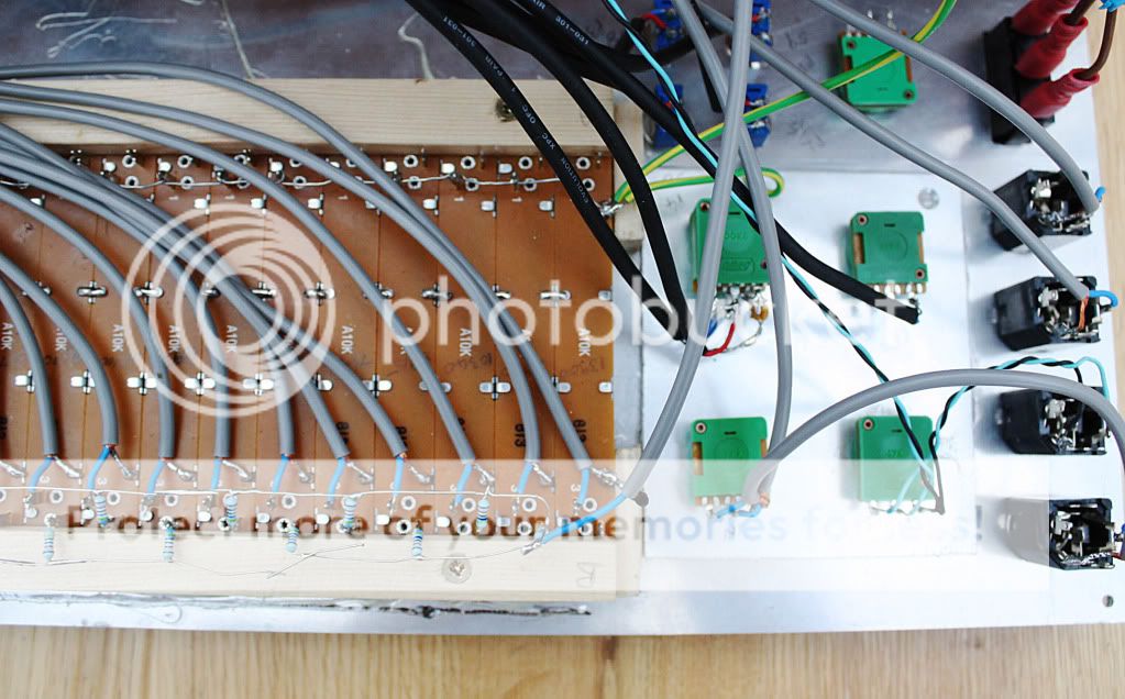

PostPosted: Tue May 18, 2010 11:56 am    Post subject: Reply with quote  Mark this post and the followings unread
2thick4uni wrote:
The pots are not fitted to a pcb or matrix board, they are fitted inside a timber frame with a couple of removable retainer strips so that I can replace any sliders should they fail...
The more I think about this the more I wonder...do you have any pics of how you did this?

PostPosted: Wed May 19, 2010 11:42 am    Post subject: Reply with quote  Mark this post and the followings unread
Hi Emdot_ambient,
Sorry for slow reply, my camera and String filter weren't in the same location. Couple of shots of the pot retaining arrangement as requested, the two wooden strips that retain the slider pots are screwed to two pieces of wood underneath which are bonded to the aluminium front panel, hope this makes sense.
All cables are shielded, not sure if it's necessary but I just wanted to keep the noise floor as low as possible. The resistors you can see are just temporary, testing different mixing arrangements at the moment.

PostPosted: Thu May 20, 2010 9:45 am    Post subject: Reply with quote  Mark this post and the followings unread
Awesome. Yes, that makes total sense. Thanks!
