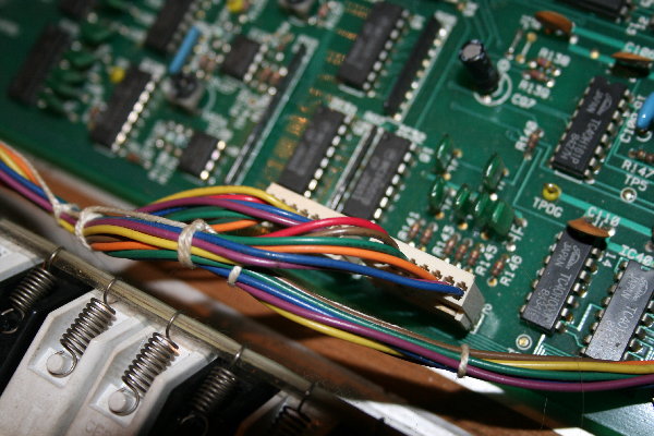

While disconnecting everything, it is very wise to also document where the wires and stuff go...
