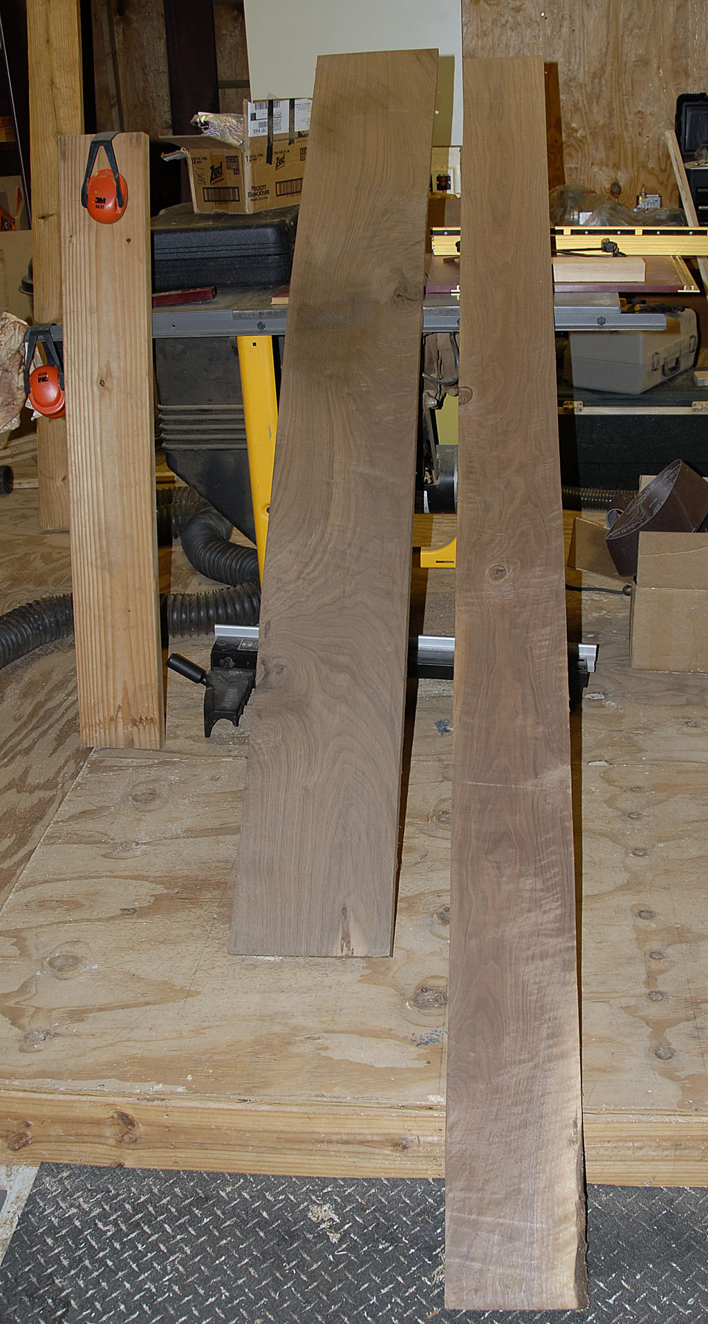

After digging through the wood stash, I've decided to use some 1" walnut boards for the casing (final thickness will be 0.75").

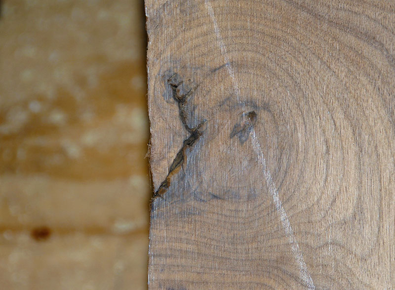

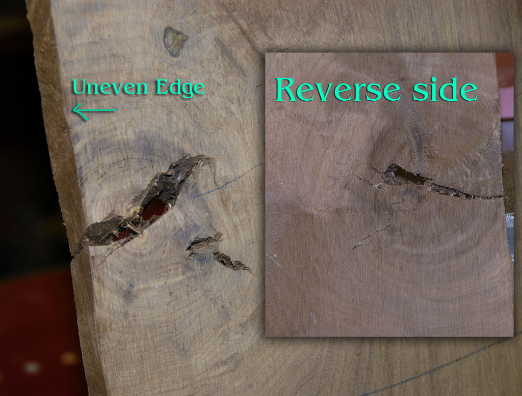

I love knots. Some people want nothing but clear wood, but I think they give the piece character. Unfortunately, they also cause a piece to come apart messily when using a jointer or planer on them (the blade 'grabs' the knot, or the edges around the voids). So the first thing I'm going to have to do is stabilize the wood so it can be surfaced.
Normally, I'd joint the rough edges smooth first thing, but as you'll see below, that would likely end badly.

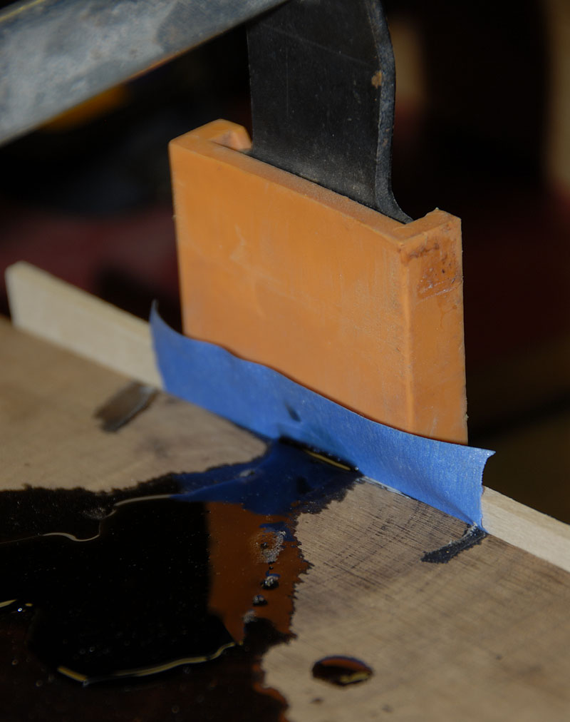

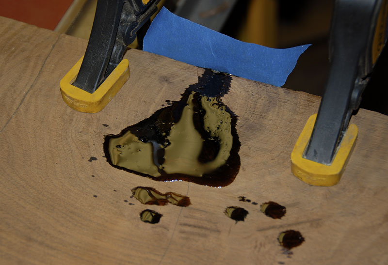

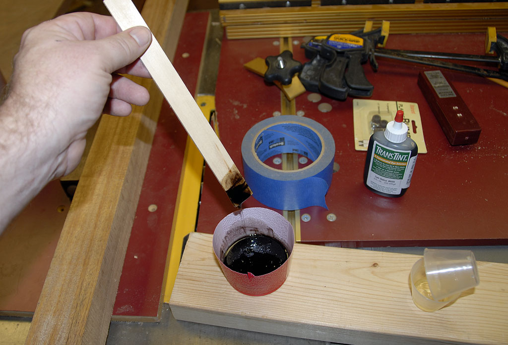

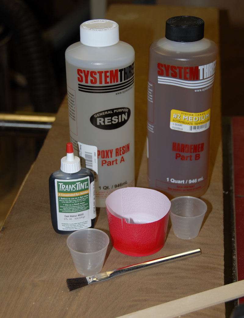

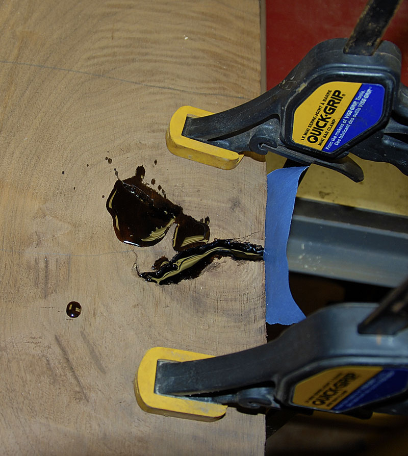

Here's my fix for knots in Walnut.
Slow-set two-part NON-SHRINKING (that's important) epoxy tinted with analine dye (1 drop is plenty, I use Dark Walnut color).
Because of the rough edge pointed out earlier, I know that it's going to take multiple passes -- the first one will hopefully stabilize the edge enough to be jointed.

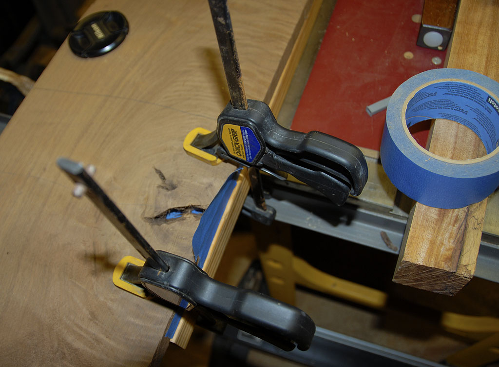

I put blue painter's tape on the bottom and side (make a dam), and clamp it hard to another board to reduce the amount of seepage I get.
Mix the epoxy (1:1), plus a drop of the dye. It's nice and runny (to fill small gaps), and has an open time of around 30 minutes @ 77 degrees F.
Pour some in, let it settle.
Keep topping off. Let it cure overnight.

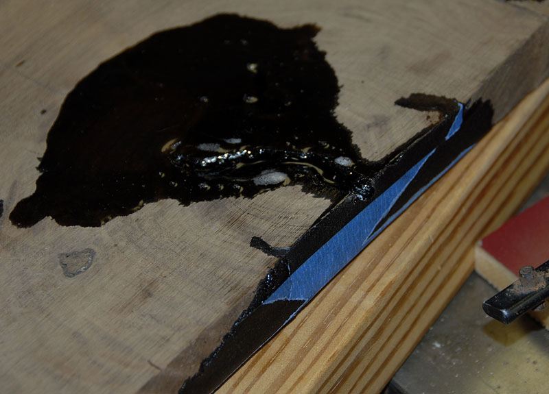

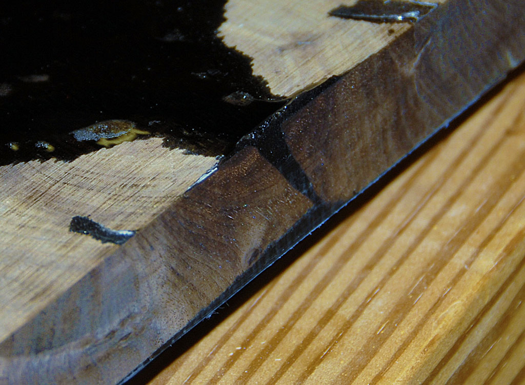

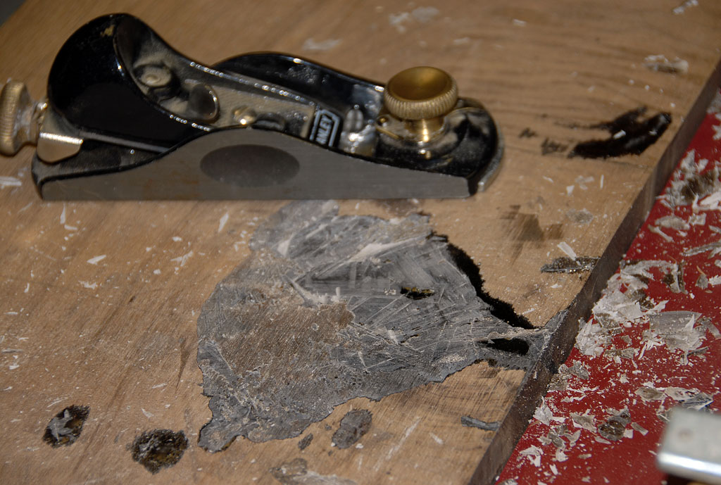

So, as expected with the rough edge, a bunch of the epoxy seeped into the side.
It *did* stabilize things enough that I could joint the edge, giving me a smooth surface for the next round of epoxy. For this second round, I clamped a piece of scrap behind the tape to make a stronger dam.

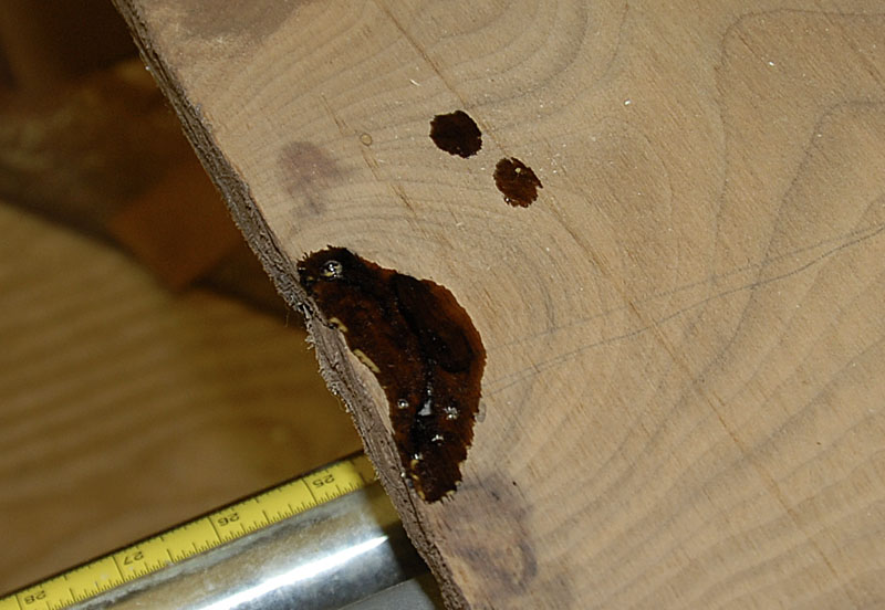

So here's what the edge looks like now that it has been stabilized and jointed. The hard epoxy can be rough on blades, so I use a small block plane to remove the bulk of it (it's a whole lot easier to re-sharpen a block plane blade than it is the blades on my 13" electric planer...).

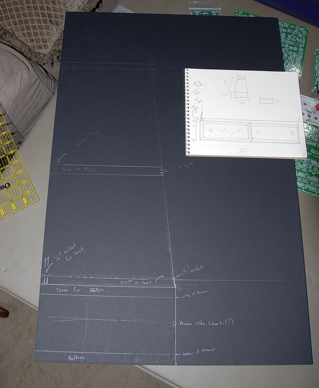

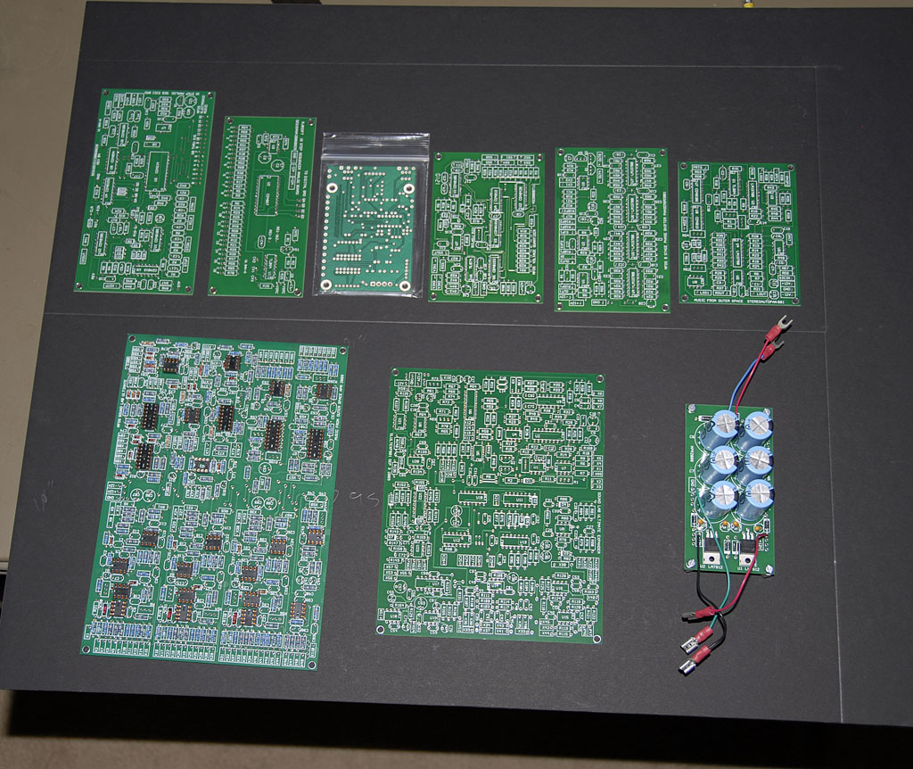

If you followed my calibrator build, you know I'm a fan of foamcore. Black foamcore is my layout tool of choice -- it's already square, and pencil writes and erases on it really well. It lets me do life-size drawings and test component arrangements.
This is my initial sketch (on paper) and my layout. After remeasuring the boards I'm using, I ended up shrinking the width at the top from 8" to 7".
This shows the layout of the PCBs -- I wanted to make sure there would be enough space for all of them (I've since swapped the quantizer with another 292c filter).

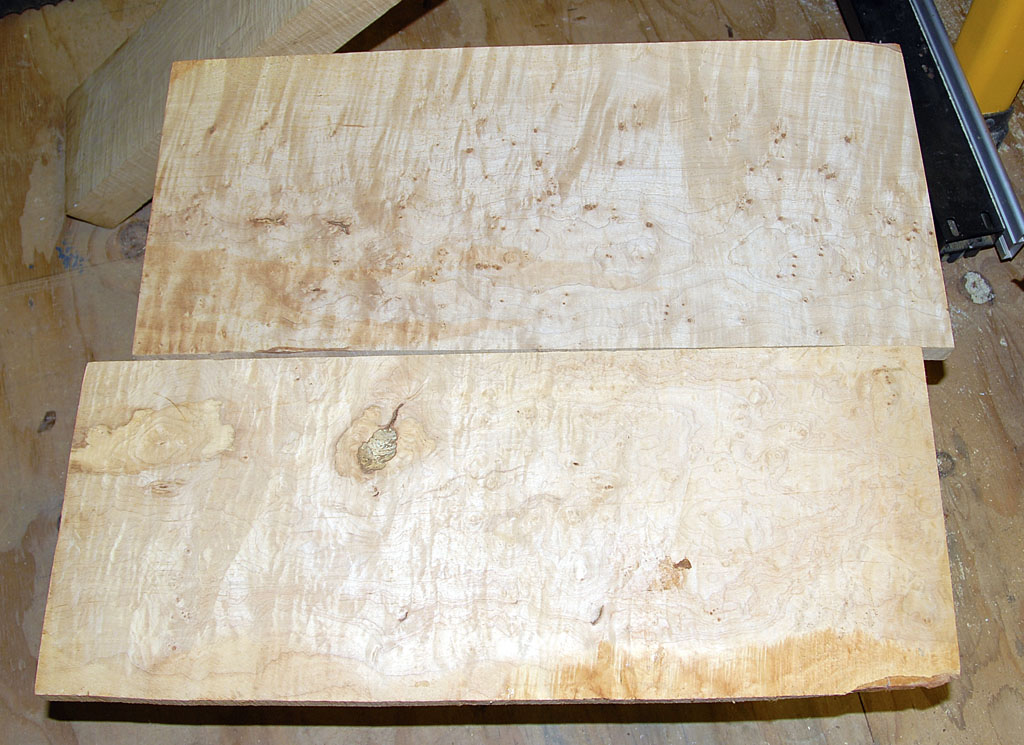

PostPosted: Fri Oct 08, 2010 5:38 am    Post subject: Reply with quote  Mark this post and the followings unread
Here's the birdseye maple I'm using for the sides of the second case, and the curly maple board (2.5" thick!) of curly maple I'll resaw for the top and bottom.

PostPosted: Fri Oct 08, 2010 5:56 am    Post subject: Reply with quote  Mark this post and the followings unread
What a lovely bit of wood! Cool
Looks lovely. Keep up the good work!

PostPosted: Sat Oct 09, 2010 11:12 pm    Post subject: Reply with quote  Mark this post and the followings unread
ah birdseye maple my all time favourite timber, will be a great contrast to that walnut Smile

PostPosted: Tue Oct 12, 2010 7:45 am    Post subject: Reply with quote  Mark this post and the followings unread
Yeah, I love birdseye maple. Machining it down to thickness sucks though, it likes to tearout.

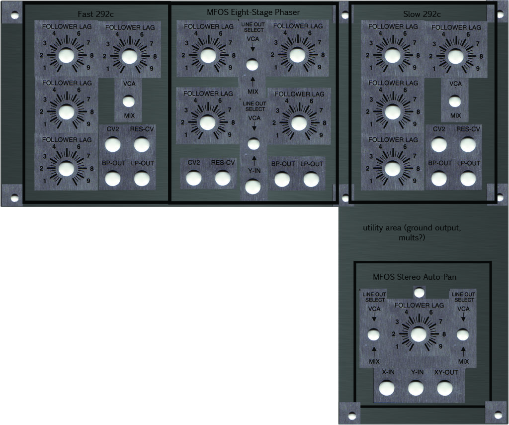

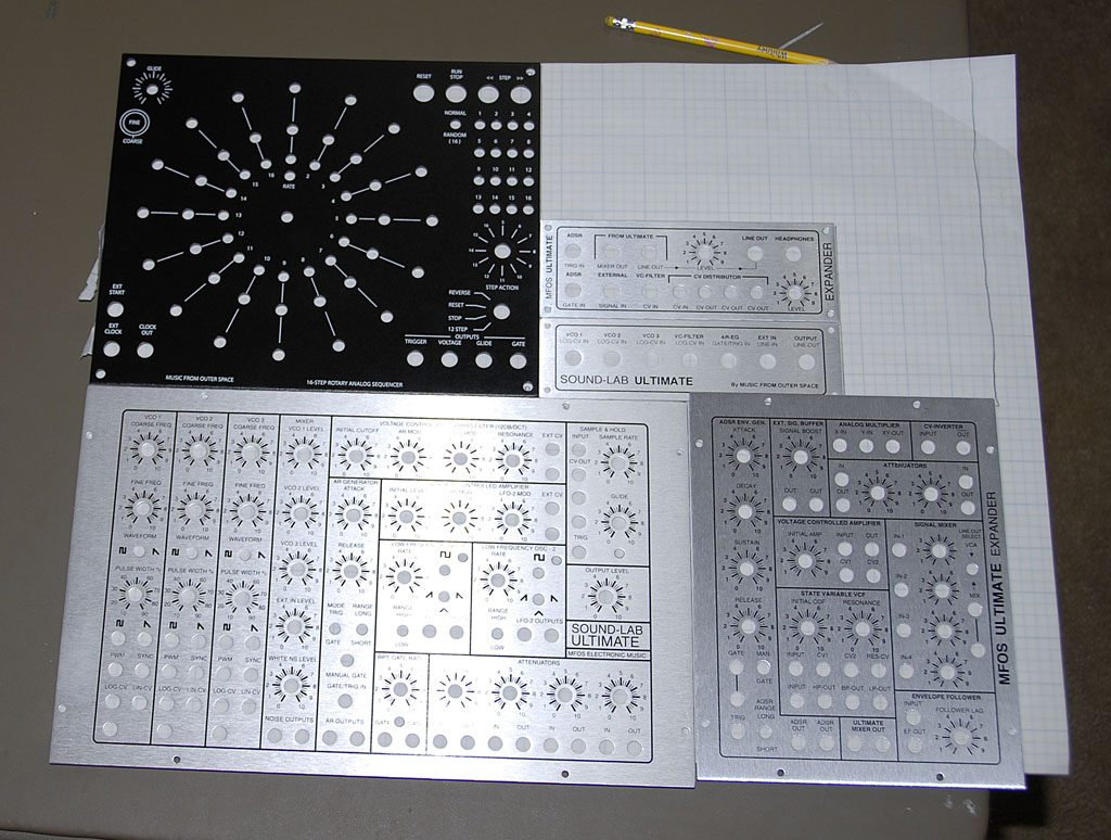

Here's how the front panel is going to end up playing out. The second picture is my Photoshop mockup using a scan of the Expander front panel to get component size/spacing correct. Obviously, the labels are wrong, but the number/type of controls is correct for each module.
I created the shape in Illustrator and imported the resulting DXF into FPD Express. The next step is actually laying it out in FPD.

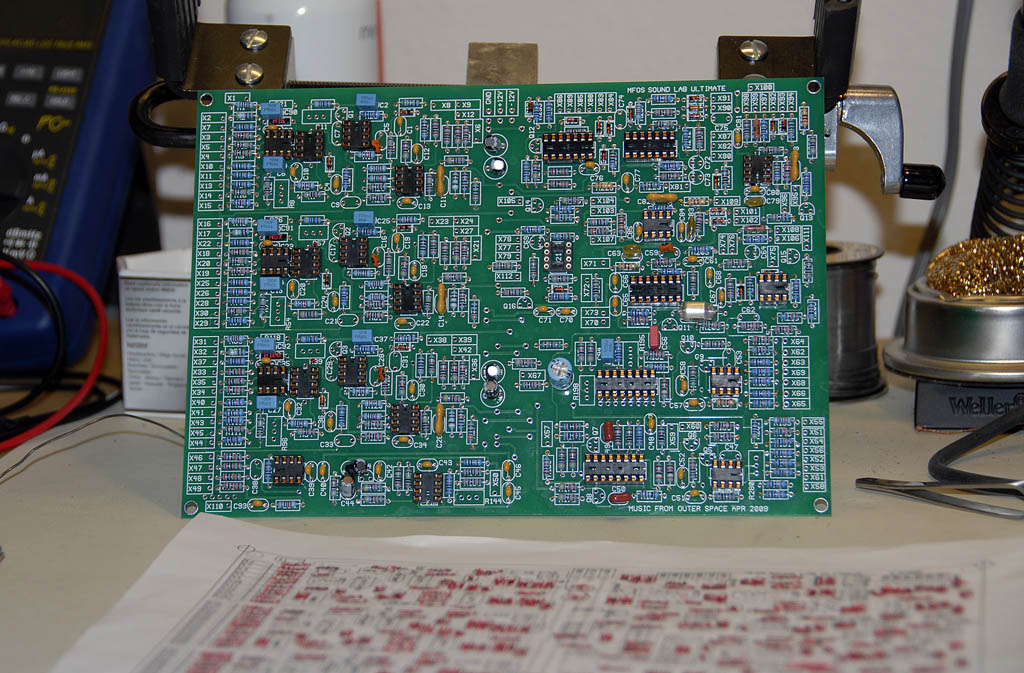

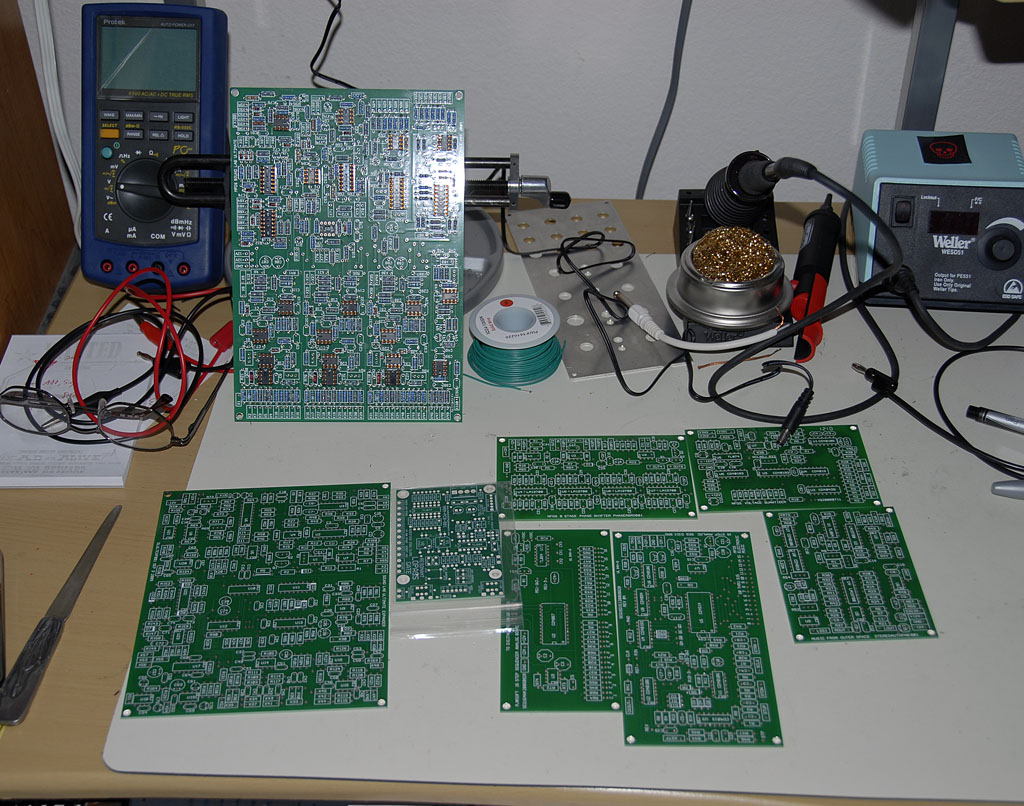

Spent some quality time with a soldering iron the last couple of nights. All resistors are done, and most of the caps, for the Ultimate PCB.

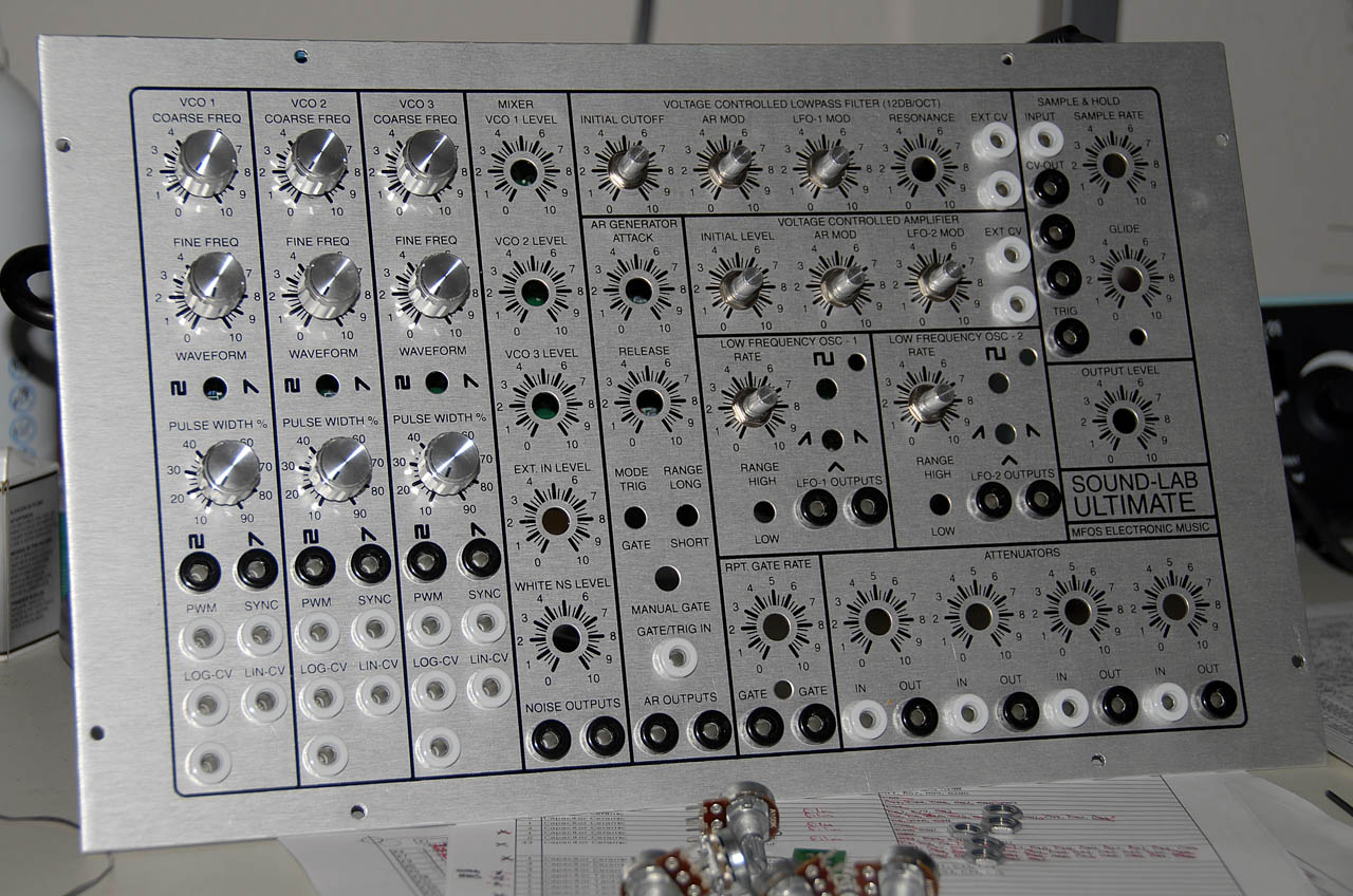

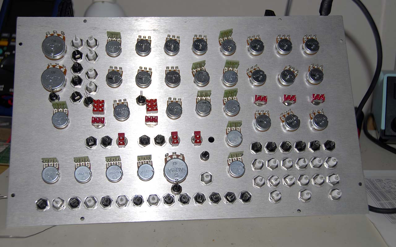

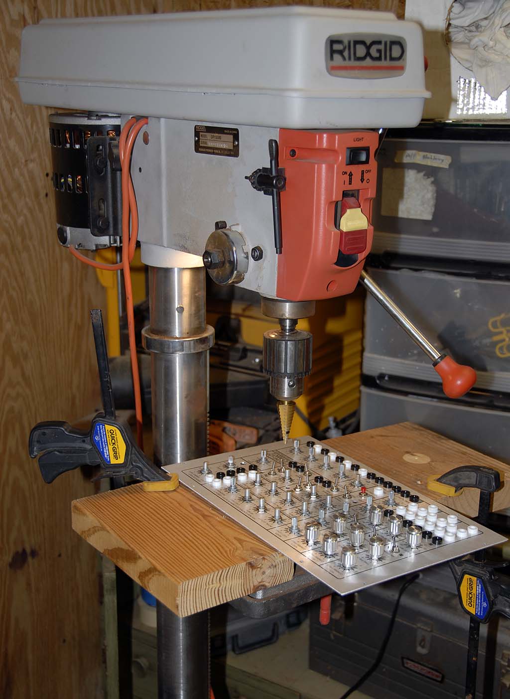

Yesterday I started sorting out the front panel for the Ultimate. I'm probably one or two evenings away from having the PCB stuffed.

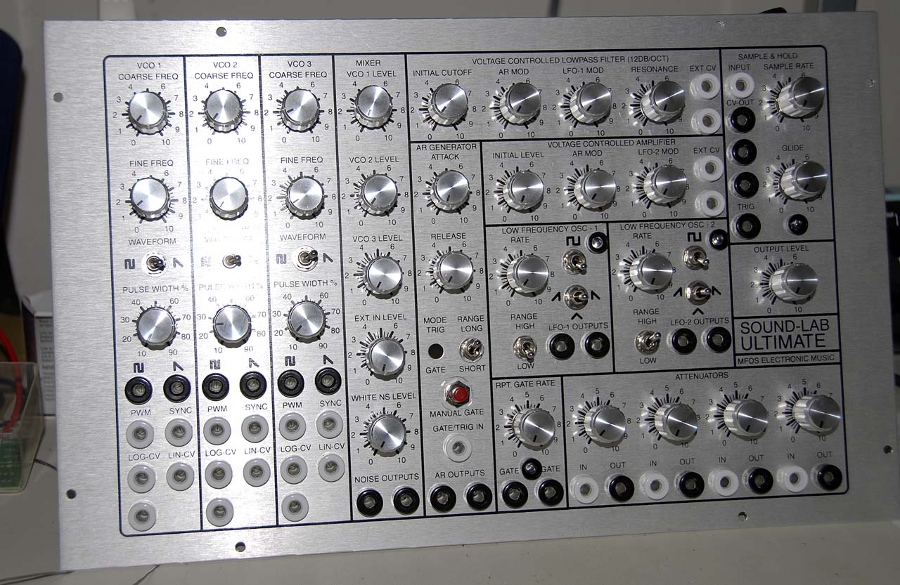

So, the time to notice that your LED bezels are too big for the holes in the panel is *not* when they're the last bits you need to install Smile A little careful work with a stepped drillbit and they mounted fine...
The front panel is stuffed except for one switch. Apparently I used my only DPST switch somewhere else. I need to do a mouser order anyway...

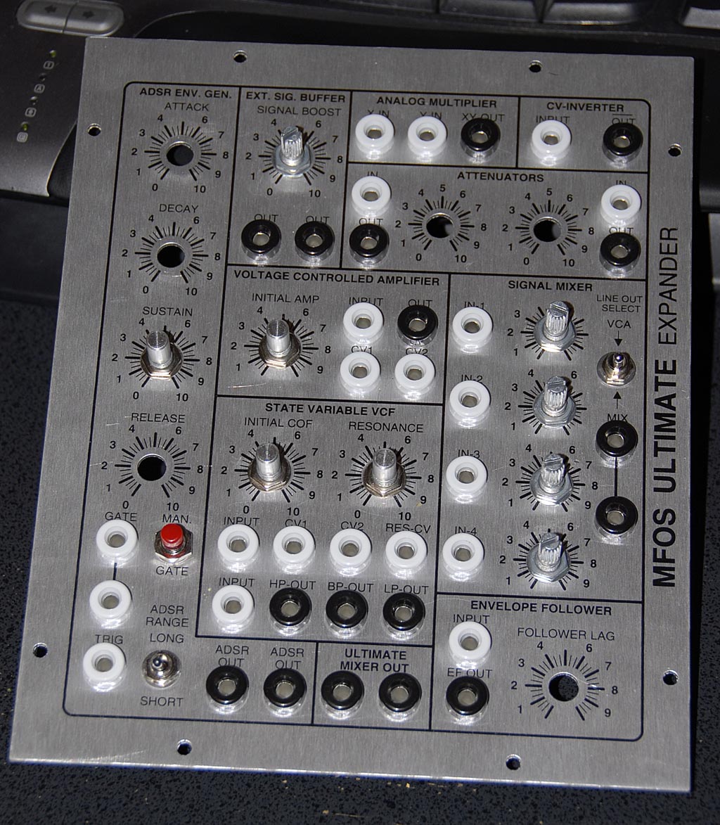

Still, I spent some time working on the Expander front panel -- I'm going to have to make a Mouser order for some missing parts for the Ultimate, I figured I should try and get some idea of everything I need. It turned out to be a good call, as you can see by the empty spots on the panel Smile
