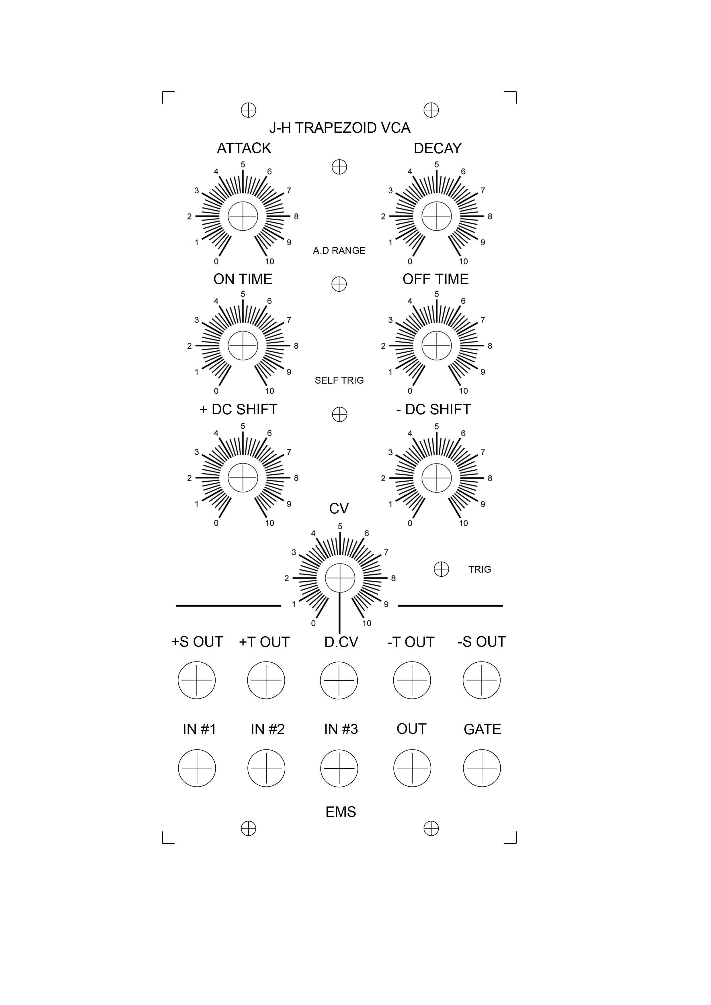

Anybody got an idea for the frontpanel (5U?)

My partner in synth-building is working on one. I hope to have something worth showing soon!

Hoping someone doesn't mind clearing a few things up for me.
1) What exactly is the "switch trigger" input? Is it there in addition to the push-button input to give you an extra spot for easily connecting with the "audio trig" connection"? Would you want to put a jack here? If so, what input would you expect here that's different from what you'd feed into the "gate" input?
2) EDIT - I believe I understand the audio trigger - the summed input audio is converted into a trigger which you can feed into switch trigger input (or I'm guessing anywhere else in your modular you can use a trigger).
3) Just to make sure, the push button input expects a normally-open momentary switch, with the 2 lugs connected to the 2 pads, right?
jhaible
Joined: May 25, 2007
Posts: 2014
PostPosted: Wed Nov 03, 2010 1:24 pm    Post subject: Reply with quote  Mark this post and the followings unread
Yes. Smile
Switch trigger is used by old Korg and Moog synthesizers. Not a gate voltage, but a switch closing a contact to GND.
Pushbutton and S-Trigger have the same function. And you can use on to connect with the Audio trigger output, to get some weird self-trigger function. (Emphasis on weird).
Gate is an ordinary 5V positive-going Voltage Trigger ("Gate") input.
JH.

Hi JH,
Looks like the value and taper of pot for InitGain is missing from the schematic - what should it be?
jhaible
Posts: 2014
PostPosted: Fri Nov 05, 2010 5:24 am    Post subject: Reply with quote  Mark this post and the followings unread
numbertalk wrote:
Hi JH,
linear
JH.

And what value? 100K?

Anything between 10k and 100k will do.
Recommended: 10k
JH.

here is my small contibution its the front panel in dotcom format 2U 222x108 mm

Just a hint:
In a system with input attenuators (most modular concepts) you should add an input attenuator potentiometer, or better a reversible attenuator, for the Decay Time CV.
In an EMS-like system, where there are no input attenuators, you should have an *output* attenuator for each output, typically a 5k log potentiometer.

Hi Jurgen, i made a new front panel with the attenuator pot,would you tell
me what do you think about Wink
