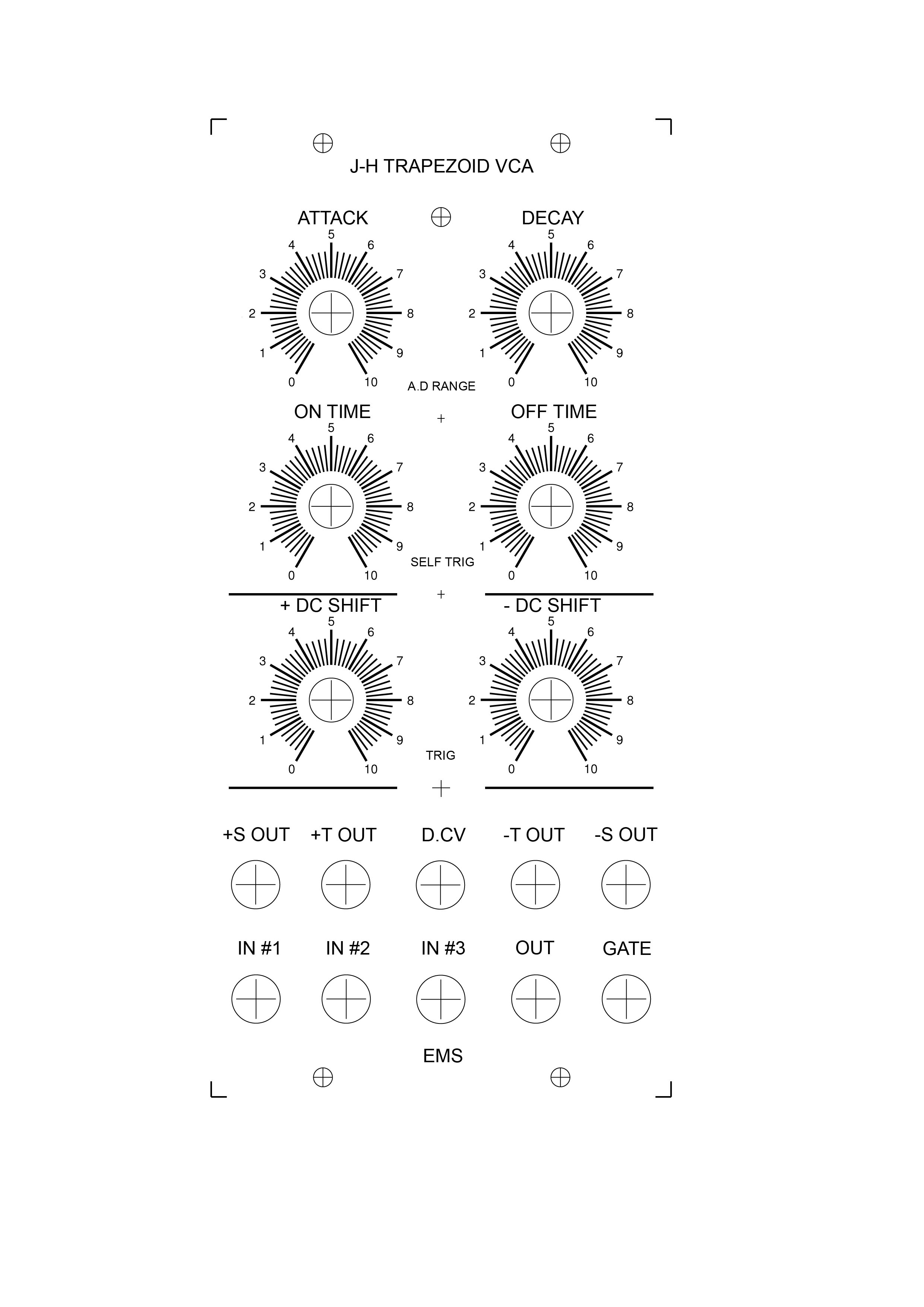

Anybody got an idea for the frontpanel (5U?)
My dIY - http://diy.czmok.de
Film/Music - http://gfm.me
MR-808
Joined: Sep 30, 2010
Posts: 28
Location: Portland, OR
PostPosted: Tue Nov 02, 2010 9:22 pm    Post subject: Reply with quote  Mark this post and the followings unread
My partner in synth-building is working on one. I hope to have something worth showing soon!

PostPosted: Thu Nov 25, 2010 10:15 am    Post subject: Reply with quote  Mark this post and the followings unread
here is my small contibution its the front panel in dotcom format 2U 222x108 mm
 Filesize:  552.39 KB
 Viewed:  410 Time(s)
jhaible
Joined: May 25, 2007
Posts: 2014
PostPosted: Thu Nov 25, 2010 2:38 pm    Post subject: Reply with quote  Mark this post and the followings unread
Just a hint:
In a system with input attenuators (most modular concepts) you should add an input attenuator potentiometer, or better a reversible attenuator, for the Decay Time CV.
In an EMS-like system, where there are no input attenuators, you should have an *output* attenuator for each output, typically a 5k log potentiometer.
JH.
zarko
Joined: Mar 25, 2010
Posts: 22
PostPosted: Fri Nov 26, 2010 11:47 am    Post subject: Reply with quote  Mark this post and the followings unread
Hi Jurgen, i made a new front panel with the attenuator pot,would you tell
me what do you think about Wink
 Filesize:  505.04 KB
 Viewed:  291 Time(s)
