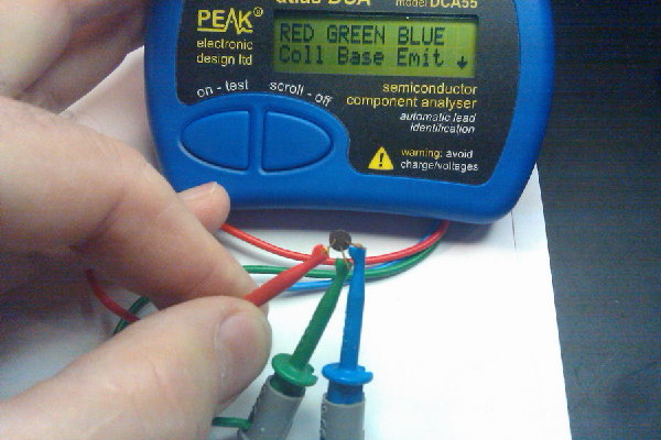

Got around to putting in the last components in the Steiner VCF yesterday: the parts had just arrived from USA after the normal long postal delay.
But then...a mystery. My PN5138 and 2N5172 are not the normal TO-92 packages but are vintage ones: the former looking like water towers and the latter having a kind of skirt. So I am not at all sure of the orientation or even if they have the same pinout as the TO-92 packages which have datasheets. (The pins are in a triangle, not a straight line).
Does anyone know what I should do? (I tried the 5172 in various orientations in the HfE measurement socket on my multimeter, but didn't get anywhere.)

Back in the day... (early 1970's) Smile If you looked at a transistor from the bottom, oriented the Base of the transistor south, the Emitter was East.
(Base is the one on the bottom of the V shape of the three leads.)
I used that with TO-5, TO-18 and TO-39 packages I think - maybe a few others...
I don't know how universal it is/was - but it worked for me back then.

The 2N5172 has an BCE pinout (top view, flat away) and will install in the PCB by lining up the flat as indicated on the PCB. If you are using them in the spots labeled for the SSM2210s, you will have to twist the leads to get them installed, use one of the discrete transistor silkscreen as a guide.
For the 2N5138s, Ill double check my stock when I get home, but looking at the top of the transistor with the base of the triangle away from you, the pin on the left is the emitter, middle base, right collector. (I had it backwards earlier...)
see attached photo and this page on the website:
http://www.xmission.com/~dingebre/Transistor_photos.html
This is one of an old 2N5138 which I bought in 1974.
I'll try to post a couple of photos tonight.
David

Brilliant! Thanks so much for that

...base is south...emitter is east. Go figure Wink
