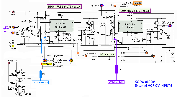

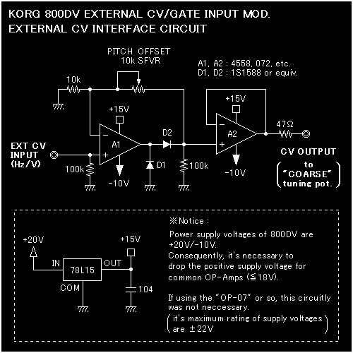

There was a Japanese webpage that had excellent instruction for adding CV and gate inputs to a Korg 800DV. Judging by your picture they are similar vintage and both V/hz. so I guess the circuitry will be about the same, but the connection points may differ.
I will post up the info from the original site, seeing it seems to have gone.
Actually, the VCF one is probably from somewhere else. Well done to those responsible!
If these prove useful, let me know, there are a few more

andrewF wrote: | There was a Japanese webpage that had excellent instruction for adding CV and gate inputs to a Korg 800DV. Judging by your picture they are similar vintage and both V/hz. so I guess the circuitry will be about the same, but the connection points may differ.
If these prove useful, let me know, there are a few more |
These are very helpful! I haven't yet started the project. I'm waiting to see if I get a good offer or trade, it seems a few people feel it's a sacrilege to modify something so rare. If no offers are made, I will go ahead with the mods in the near future, in the meantime, I'll collect as much data as possible and draw plans ready.
Again, thanks for this, and if you have more, I would love to see them!

I don't think the nord will be much use - isn't it just Midi( just an assumption)? you could get a midi2cv converter (try synhouse - midijack herz so good) but more expense.
it is not much use adding CV and gate inputs if you have no CV or gate sources.
Maybe just check out what the trimpots do, especially the ones on the filter board, if they seem to have a good effect, replace the trimpot with a pot mounted on the panel.
As for modding an old synth...my 800DV was battered, several broken switches and keys, so I had no qualms about removing the keyboard and giving it all the CV and gate inputs. If it was in good condition, i don't think i would want to mess with it.....well, an extra pot or switch on the front panel and a couple of CV/gate jacks on the back wouldn't hurt....

andrewF wrote: | Maybe just check out what the trimpots do, especially the ones on the filter board, if they seem to have a good effect, replace the trimpot with a pot mounted on the panel. |
I already have, check the opening post. The Q (resonance) makes a lot of difference, as it is off as standard, I actually thought it was a non resonant filter until I went inside.
andrewF wrote: | As for modding an old synth...my 800DV was battered, several broken switches and keys, so I had no qualms about removing the keyboard and giving it all the CV and gate inputs. If it was in good condition, i don't think i would want to mess with it.....well, an extra pot or switch on the front panel and a couple of CV/gate jacks on the back wouldn't hurt.... |
To be honest, I don't think it would hurt to add CV/Gate sockets to any synth with no external control, as it makes it ultimately more useable.
Thanks again for the latest diagrams, very helpful! |
