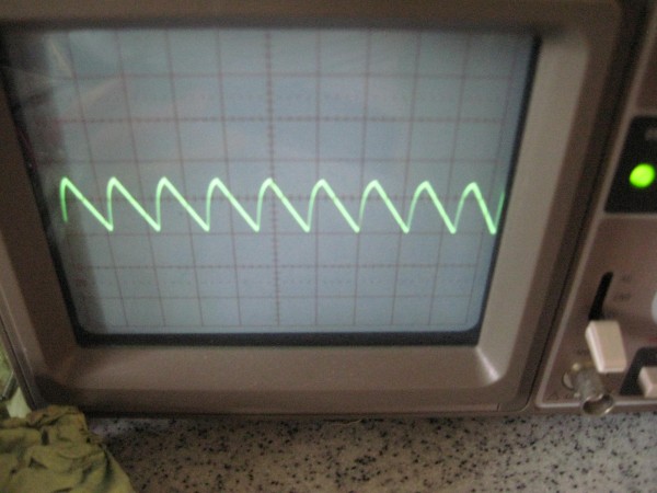

PostPosted: Wed Oct 12, 2011 5:22 am    Post subject: Reply with quote  Mark this post and the followings unread
looks OK until then, can you post scope views of the signal at pin 7 of U6 for various frequency settings
Yves
Ali M
Joined: Sep 01, 2009
Posts: 83
Location: uk
PostPosted: Wed Oct 12, 2011 5:53 am    Post subject: Reply with quote  Mark this post and the followings unread
All the percentages are aproxomations.
It was one of those cases where you wish you had a third hand!
0% or 100%
 Filesize:  841.68 KB
 Viewed:  62 Time(s)
20-30%
 Filesize:  738.09 KB
 Viewed:  61 Time(s)
50% (Best it gets!)
 Filesize:  785.47 KB
 Viewed:  64 Time(s)
Around 50% Distortion
 Filesize:  834.59 KB
 Viewed:  61 Time(s)
The highest frequency I can trace before it flattens
 Filesize:  780.4 KB
 Viewed:  62 Time(s)

PostPosted: Sat Oct 15, 2011 5:42 am    Post subject: Reply with quote  Mark this post and the followings unread
OK the waveshapes are weird and interestingly the amplitude depends upon the frequency. These are clues and I will try to figure out what's wrong there.
