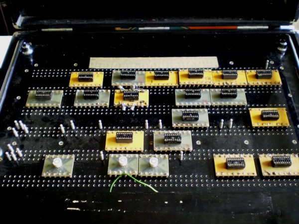

PostPosted: Wed Nov 23, 2011 5:35 am    Post subject: Sealectro Matrix board.
Subject description: are you VARIACably viable?
It has now arrived!
I have inspected the inside and the components look to be in not bad shape being approx. 43 yrs old except for a chipped colour banded cap and some white powdery substance on the pots. The mains wire is cut so I'm won't be plugging it in right away!!!!!
I've been advised to pump power into the circuitry slowly building up from 0V using a VARIAC transformer so as to Reform the capacitors. I would like to know if anyone has any experience of this in old long time unused circuits. I've bought old test equipment before ( Advance SG66 wavegenerator), skymaster communications reciever, mullard scope etc but never had to do this...?...

Things you should do.
If the collectable sat on a shelf value of the piece is dependent on original parts use a variac or if you find yourself in the 1970s when electronic components were very expensive against the average wage use a variac.
Otherwise protect your eyes and ears and apply 10 secs then 20 secs then etc.
Expect an explosion. Be a hawk.
Use a 1A fuse in the plug.
Watch for smoke etc.
Then when it seems to be working check all the voltages are as expected.
If the caps stay loaded on power off bleed them before poking around unless you enjoy a sharp prod up the arm.
I consider damp the main problem; some sellers don't keep the equipment in dry storage that fks connectors and can cause shorts in transformers.
Some may say you must use a variac but if you need to be an_l about it break the power circuits up post the rectifier and post the capacitors and test individual parts - which you'll have to do if the fuse keeps blowing; wire in a known supply to the circuit etc.

PostPosted: Thu Dec 08, 2011 5:07 am    Post subject: No sparks or smoke and and other uses for an umbrella.
Subject description: Fit and working again...almost.
Well I finally got around to wiring her up to a plug and just went for it. The grille above the patch panel contains green lights that give out the same eerie kind of light as Magic eyes found in 60's reel to reels (Grundig TK23 etc..) which dim slowly when the voltage is turned up via the voltage dial.
??!??. Also on the back of the matrix board is an odd looking green 32 or so pin connector (see pic.) Everything seems to work except I'm not sure about the best way to test the meter and the pulse gen's frequency pot needs replacing as it is as unstable and crackly as hell. Another problem was with the jumper leads. There were only 3 so I set about finding a way to make some nice connectors for jumpers. ( Smooth, not abrasive to the matrix contacts) and after trial and error found that Pound shop Umbrella spines fitted perfectly. :s.

mubase
Joined: Mar 24, 2011
Posts: 117
Location: London UK
PostPosted: Fri Dec 09, 2011 5:43 am    Post subject: Rainbows in air. Reply with quote  Mark this post and the followings unread
Ribbon cable is an excellent suggestion (Thanks P.) but
as for the interface,
It's connected to "Nothing"! Its just sitting there disattached and sad.
( Maybe it's got something to do with the "Patchboard system" sockets??)
I think they are either "Logic" or Voltage level states indicated by the lamps. If I place a jumper wire into a patchboard system socket and touch the tip with my finger the lamp lights up slightly.. A voltage reading with a DVM gives 0.10V. Also I notice something odd about the voltage supplies. There are 2 with ranges between 0-10 and 10-20V each.
The leftmost + and - give DC readings but if I try measuring voltage using either a + and earth or a - and earth I get nothing.?.
The second voltage supply seems to do the same and give readings in both AC and DC...

PostPosted: Fri Dec 09, 2011 6:44 am    Post subject: Reply with quote  Mark this post and the followings unread
A floating arrangement piggybacking one supply on the other....have you contacted TI...a corporation that vast must have a legacy curator of some sort.
I'll ask my Pops next time I speak to him, he was a wire wrapping TTL engineer of that era.
