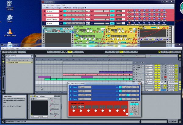

Hey hegeldas and mickeyl, thanks both for the help offer. This started out as just a test to see if I could get a usb connection going with the G2 and exchange some messages, but one thing led to another, mainly because it's winter and I have nothing better to do and I also don't have a baby to take care of...
I hope I will be able to have something more or less stable in a month or so, that's only a windows version with the basic functionality. The work now is mostly testing and restructuring the code, when I'm ready with that, I'll post the code and the executables.
Hegeldas, about the graphics, if you want to be able in future to do patching on a touch screen, then I think you need vector graphics, so you can scale them for zooming in and out. I sort of reckoned with that, so all the new graphics I added are all drawn in real time and can be scaled. The drawback is that they are very basic looking. Maybe this could be improved but then your going to need OpenGL or DirectX or something because the graphics are eating most of the cpu now, unless you have another idea?
I've added the function to change morphs in all variations, and also in the vst the function to automate variation changes. You could do that with midi also of course...

Here's some more info about the graphics:
I use module definition files to create the modules, I've included all of them in the zip file.
They look like the following:
<#Module
FileName:"LogicPulse"
Tooltip:"Pulse"
Height:2
XPos:0
YPos:0
Version:208
<Input>
<Knob>
<Line>
<ButtonFlat>
<#TextField
... and so on
The different controls start with <#Knob, <#Line and so on.
The controls that I have implemented in code so far are the following:
Label, Led, Display, Graph, Led, MiniUV, PartSelector, ButtonText, TextEdit, ButtonFlat, Knob, Bitmap.
The Graph control should display a graphical image of a filter or a envelope depending on the GraphFunc parameter and the settings of the parameters, that is one off the things that remains to be done.
The CodeRef refers to the parameter number of the module. InfoFunc don't no what that means yet.
In some cases there are bitmaps embedded in the moduledef. These should be replaced by vector graphic for zooming in, because otherwise it will get ugly.
So when a module object is created, then the moduledef is parsed and all the controls become child objects of the module.
The module itself is a child object of a scrollbox in which the patching takes place.
My approach thus far is, that when the application needs to redraw a part of the scrollbox, I create an offscreen bitmap. Then the application finds out which modules and control rectangles overlap with this part of the scrollbox. These are rendered on the offscreen bitmap, then over that the cable segments that overlap the rectangle are rendered. And then the offscreen bitmap is copied to the scrollbox canvas.
With the new firemonkey framework of Delphi, it works differently, that's a more generic method because it is meant for windows and also osx.
I've experimented a bit with firemonkey, you can see a result on the screenshot in which I've implemented a bit of zooming functionality.

Ok .. and to install them libusb needs be installed first ... but I see no component tab "NM G2", they are run time only?
Never mind, after chaning projects it now does show up, and the editor project opens fine ... now compile ... ok some version issues ...
D2009 does not have :
Vcl.PlatformDefaultStyleActnCtrls, (unit, just left it out)
FSearchThread.Start; (used resume instead)
So something wrong with :
{$IFDEF G2_VER200_up}
It runs Very Happy
But no G2 device found (which is correct as its not connected)
Again lots of warnings, but looks all fine sofar!

And thanks for the job offer, but I'm not looking for anything else at the moment, still happy with my current job. I Hope you can find someone else there to help you.
- I had to add the dclIndyCore100 and dclIndyProtocols100 in the requirements list of the NMG2_controls_D2007 project because otherwise when compiling it had a confilct with a particular unit. So adding these to the requirements list solved this.
But it can very well be that you can delete them out of the requirement list, since you use Delphi2009
- Then all these warnings, I usually just ignored most of them, shame on me... Embarassed Should take some time to elliminate these.
- Dit you install lib-usb as a -filter- driver on the clavia driver using the wizard? After installing lib-usb you should be able to start this from the start menu.
As long as you install it as a filter driver, not much could go wrong there...
