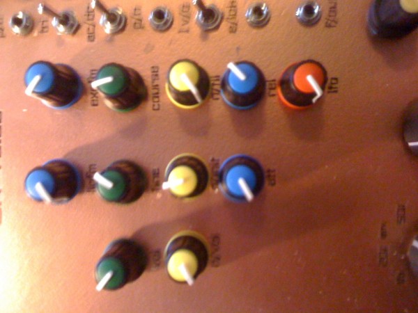

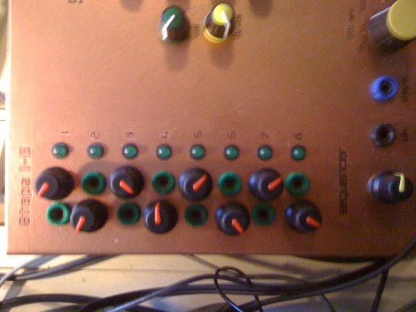

Hi all! I have finally finished my SN Voice standalone module project. dancing
1 SN voice PCB courtsey of Bill from SMS. 1 baby 8 seqencer and 1 Fonik designs SSM low pass filter. All in a lovely copper painted box with decal transfer indicators. The wiring has taken me 3 weeks on and off to get right ( the box it is all contained in is only 25 x 16 x 7 cm...
It is fully patchable via banana jacks with some extra outputs ( filter, pulse/noise output, triangle output) and inputs ( Gate and 1V/oct) using 3.5mm mono jacks. The sequencer has a CV output for the sequence as well as the clock output from the 555 and pulse outputs for each step of the sequence which can range from 2-8 steps. I cant believe the sound output of the SN voice. Very nice especially with the PWM being modulated by LFO or ENV options. The SSM filter I have tuned to my liking and it sounds nice.
I am currently looking into making a simple circuit to convert MIDI information to gate and CV signals and have had some success using arduino duemilanove and Narbotics MIDIVOX schematic ( i missed out on getting a MIDIVOX kit before they ran out) but I have had some luck by breadboarding the basic opto isolator and 4192 DAC circuit and using an M audio midi keyboard ( a little out of tune but I will remedy that when the circuit is stable ). If you connect the sequencer output to the SN voices' EXP FM input and play a key on the keyboard it ARPEGGIATES!!! The sketch is a little unsteady though...
On its own though, some beautiful sound combinations can be made from experimenting with this little beastie.....My partner and I have spent hours with it but still haven't recorded anything.....
Some blurry pictures below of my "SN Voice Lux"...
Respect to Magic smoke and Bill for all help with this.
Some sounds and a video demonstration are on the way ( just very tied up with Uni work at the moment.....)
p.s ( sorry, the pictures came out sideways, just tilt your head for a "real" effect. Smile

SN voice pots
 Filesize:  382.57 KB
 Viewed:  57 Time(s)

Sequencer
 Filesize:  391.09 KB
 Viewed:  48 Time(s)
