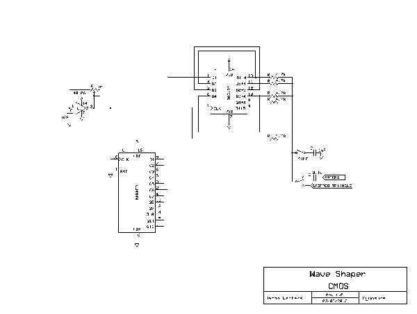

PostPosted: Sat Mar 03, 2012 5:15 pm    Post subject: CMOS Wave Shaper
Subject description: Schematic
I am sure that there are similar schematics floating around the web and some people might have posted them here already, but I drew this up for myself and figured I would share it just in case someone else could use it.
The source sqaurewave could come from anything, but in my schematic it is a 40106 oscillator. It runs a little high and is used as the clock frequency for the shift register. The same signal is also divided with a 4040 and used as the base input for the shift register. I do this dividing so that the spacing of the steps changes along with the pitch.

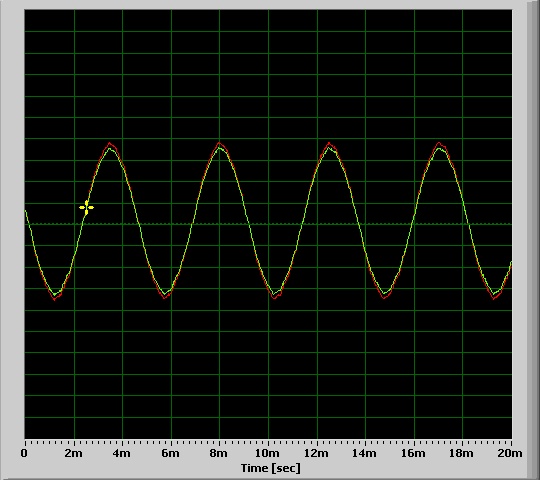

I added a couple of option at the output for more shaping. A cap to ground rounds it off into a nice sine wave. Passing the sound through a low value cap acts as a highpass filter that turns each edge of the step into a spike.

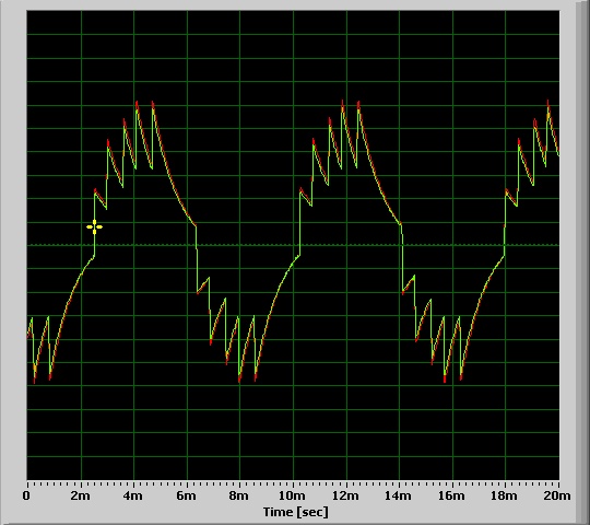

You could probably do some really weird wave shaping by using separate low or highpass filters on each output from the 4006. This might almost allow you to draw the desired waveform with a bit of practice.

Sine wave.

Spiked steps.

well, if this works, then its very interesting.
might breadboard it up tomorrow. Very Happy
nice work
_Richard_ Smile

Cynosure, that looks very nice, especially those spikes Smile. Does it perform with other input signals as well, or is it square in only?

This is very interesting indeed, Jake. I will try it out. It would be great to have an adjustable wave shaper module to accompany my 40106 VCO.

Sodium - It might work with other waveforms if the peaks go over the CMOS threshold, but I think for optimal performance you will want to use a comparator to create a squarewave if you are using a different wave as the source.
Sonic - I was actually thinking about your vco when I was making it. It would be a cool module.
I was playing around with it today adding more or less of the shift register outputs, and changing the mixing resistors for diodes or small caps. You can make some very unique waveforms, but it is kind of difficult to predict how it is going to look and sound until you test it out.

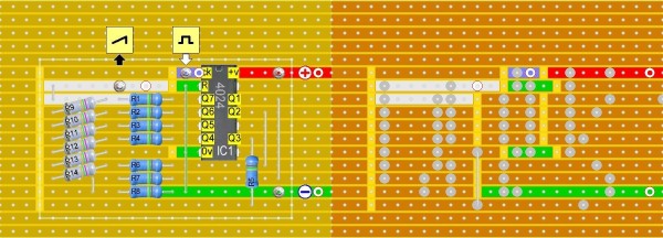

4024 7b ramp oscillator stripboard (veroboard):

Can I substitute different resistor values? 150k and 75k are odd values that i do not have in quantity.
Would 47k and 100k work?

The ratio is important: R/2R. 47K is half of 100K, minus 6%. With an error of 6%, your error term is as large as your fourth bit (1/16th == 0.0625, ~6%). That means that you may as well only build a three-bit R/2R ladder.
See https://en.wikipedia.org/wiki/Resistor_ladder#Accuracy_of_R-2R_resistor_ladders

but 47k and 94k (ie, 2 x 47k in series) would work...[/left]

Consider to use only 100k resistor. 2x100k in parallel = 50k.
Accuracy of R-2R resistor ladders for 7 bits is 1/127=0.79%
Discrete resistor should be 0.5% tolerance.

Ok, so if I were to make it i would need to by resistors with better tolerance anyway, so i can get the same values.

Yeah, this is the way to go. Especially easy if you've got a bin full of 100k 1%'s.
