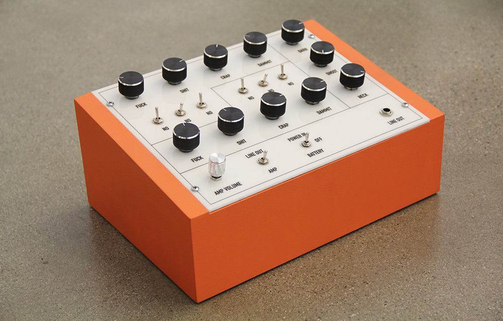

Although I've had some other basic electronics experience, this is certainly my first synth DIY project, and what a pleasure it was to build. I also must add that I was as inspired by this community as I was by Ray Wilson to get into this, so a big thanks for that.
I decided to make mine a bit angry, as the WSG can be known to make some excellently profane noises...
Some questions I'm hoping someone can answer:
I added a basic amp using an LM386, and I was having a lot of trouble with ground noise in that circuit. I'm running ground to it from the panel, but should I be grounding it somewhere else like on the pot where most other grounds are running from? I was able to make some good progress here by running a 10uF cap between + and - in that circuit, and a 0.1uF cap between the + and - rails on the 386, but is there anything more/different I should be doing here?
It doesn't sound terrible, and most of the ground noise seems to be gone, but it just doesn't have the clarity that the line out has. Am I foolish to expect more from a basic 386 amp, or are there any good tactics for increasing the quality? The amp circuit I used is below:
Yeah, or on your power supply even, but the idea of a "star point" certainly applies here and any ground current running trough the front panel would mess things up in a way as you experienced.
You could just take a ground wire and experiment a bit to find a ground spot that gives least trouble .. its not so easy often to see where the currents actually flow.
And thats a damn nice looking box! I'd listen to any audio you'd post here Wink
o . and welcome of course Smile
