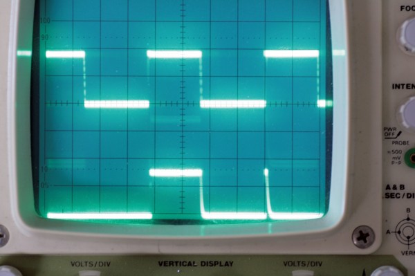

Hi running into a brick wall on this one
A] anyone know the timing of the outputs of a 4017 and can confirm or repudiate the following
going off the timing chart on the data sheet visually it appears as if they overlap each other slightly ie output one only goes low after output 2 goes high and so on however the data sheet only states that the outputs are held high for one full clock cycle , now during physical testing of a particular cct i see some 50 micro seconds overlap which is massively longer than the less than 100 nano seconds or so i would have expected
hence my doubts as to the validity of the result and this question.
some back ground
I came across this working on a sequential switch using cd4017 / DG412 bsically the same as fonik's switch just 8 steps not 4 it is switching clock signals to 8 of hexinvertors sympleseq's . now obviously if the 4017 is holding each of its outputs for 50 microseconds after the full cycle clock pulse you get an extra 50 micro second pulse from the start of the next clock pulse into each sympleseq causing a double step of each sequencer
this is very much unwanted behaviour, So now i need a way of removing that pulse or at least circumventing it . Any and all idea's on how to do that are most welcome.

yeah i agree about propagation delays, max all up should be less than
200 nano seconds for the particular cct in question however i dont think it is a question of propagation delays here what is concerning me is an overlap in the stepping where each 4017 output remains high even after the next output of the 4017 has switched high and remains high for far longer than expected well [50 microseconds or so]
schematic of seq switch and very simple block diagram of use attached
note the sequential switch is based on fonik's very nice design
now on my scope what i am seeing is this
probe A is measuring the main clock signal in - a 50% duty cycle clock at roughly 300 hz
probe B is measuring the clock signal entering symplseq 1 [ they all test the same i checked]
the divider is at div by 1 so each clock tick should step each symplseq once and also step the sequential switch one step so each symplseq should only step once each in turn [ the divider has been calibrated and the cct has been tested with out the divider in place - no differance]
ON probe B I see the clock signal fine but also see another pulse in line with the start of the next clock pulse, of about 50 microseconds in duration and of equal voltage to the the main clock , each sequencer naturally double steps- not good
mulled this over in my head for a while and rechecked as much as possible and came to the conclusion that the most likely cause is an overlap of the 4017 outputs hence the original question
50 microseconds seems a very long time for a cct output to from high state to low
i have never seen any schematic here showing pulldown resistors used on 4017 outputs but perhaps i should try that ?

PostPosted: Mon Apr 09, 2012 3:55 am    Post subject: Reply with quote  Mark this post and the followings unread
Hi mate.
Hmmm - a puzzler...
Couple of ideas..... If you haven't already, try measuring the incoming CLK and the Q outputs directly on the 4017, and comparing them on the dual sillyscope. That will show if the problem is there, or in or around the DG412s.
One way to do that might be to hook up say, the 4017's Q1 and Q2 outputs to an AND gate and look at its output. That will show if there's an overlap at the 4017 Q outputs, or more specifically, if Q1 is slow to return to zero.....
I don't think pulldown resistors on the Q outputs for the 4017 would help. CMOS fanouts are large, and I can't see any floating inputs on the DG412s, so that *shouldn't* be a problem.
Another thing to try is to temporarily disconnect the RESET input sub-circuit with the transistors, and the extra manual RESET and CLK circuitry to the 4017 to see if they are having an effect on things. Basically simplify the circuit as much as possible, and see if the problem remains/changes.
(From memory, a 4017 with several connections via diodes to the RESET input can be quite picky, although that may just have been the way the M2C was wired up when I was testing it).
Finally, see what happens when temporarily bypassing the 4 x 40106 inverters on the clock line, and see if (where) the problem moves.
It can often help lots to temporarily remove sub circuitry, so as to rule it out of the equation (or not!)
Good luck - keep us posted. Smile

It looks to like the propagation delay through the CD4017 is causing the problem. The clock running through those 4 invertors is getting to the final stage before the enables are ready. So you get a little bit of the next clock pulse on the output.
Normally I'd suggest retiming some of your signals but the only thing you've got to work with is the clock you're trying to output. That makes it pretty tricky.
You might try (and you didn't hear this from me) inserting a small RC time delay between two of those inverter stages to see if you can add a little more delay into the clock line as it heads to the DGs. Yech!

PostPosted: Mon Apr 09, 2012 5:20 pm    Post subject: Reply with quote  Mark this post and the followings unread
Dave all good ideas
you are correct about the pulldowns - no effect
proved the issue last night to the 4017 just as the way you suggested
also tried miminalising the cct - so not the reset circuitry
dont know the reasons behind designing the 4017 with such a massive overlap on the outputs but there it is. I must go with the empirical evidence
something to remember.
Banjo I doubt we have the same issue with just a straight sequencer
what i am looking at would not be an issue with that sort of circuit
post a schematic of what you have and we can go over it.
Mongo the 4 invertors are being used to delay the switched clock some 240 nano seconds to allow for the propagation delays inherent in the 4017 approx 170-200 nanoseconds + a small amount
however since it seems the outputs of the 4017 hold for far longer than i expected they do not acheive their intended purpose . I originally tried removing them and i also tried increasing the delay right out to some 1600 nanoseconds its just not enough .
So i either need to insert a cct that does not effect the pulse length to delay the incoming switched clock pulse by more than 50 microseconds
[a small BBD cct perhaps came to mind] harder or i need to provide enough slew to the start of the pulse so that it is under the 50% level trigger point of the cmos for greater than 50 microseconds and then recondition the clock pulses again after the DG switches though this would of course have a small shortening effect on the pulse length
if i put it where you suggest would it not turn the next invertor into a one shot. giving me a short trigger pulse only ? I think better after the invertors and before the DG's and then recondition after the DG's
or perhaps i am wrong.
EDIT: had another thought i can do it before the invertors with a little rewiring i have a break point i can utilise on the board for it ,thank god i had the foresight to put it in there, no board kludge required will try it next
chance i get just need to work out the required RC circuit and buffer it

I just looked at the picture of your scope, and the spike is at the low to high transit point, and not the high to low. I am guessing that a pwm would work with that as well if my theory is correct.

both solutions would affect your sequencers gate out length, though.
Yes but only a very small amount "shh" I dont think anyone will notice. Wink
make the pulse as short as possible but long as necessary.
I was thinking make the pulse as short as necessary and as long as possible Laughing different perspectives its all good.

some success last night eventually yay
I hate breadboards even more now though Evil or Very Mad
did eventually get rid of the double stepping though
will try to draw up a board tonight
very small only a TL072 and a few componants

for a moment there i had a thought of a proper way of removing the overlap of the 4017 outputs directly the way matthias suggested but not sure which chip may work the way i want
if the 4017 outputs are each put through a one shot cct to create a trigger
and then that trigger is used to trigger a chip xxxx while the original clock
signal is used to latch said chip xxxx then the resulting output should be only as long as the original clock signal is in a high state this can then be fed to the logic in of the relevent DG switch. would need to be one cct per 4017 output used so in my case 8 ccts
I am showing my complete ignorance here as i dont know of a chip that does that, suggestions anyone ?

maybe trigger flipflops? these could then control the analog switch?

AH sorry tim that last posting of mine is really more of a bit of an excercise to find a better solution to the 4017 overlap issue
Matthias's earlier suggestion got me thinking along different lines
I already do have a way round it that will work for my sympleseq64 build but it is more of a way of sidestepping the issue really. Acceptable to me for my build, but perhaps a better solution is possible . someone may read this one day and find some usefullness in it.
Matthias indeed a flip flop. I was thinking of it wrongly originally as with a flip flop some impetus is needed to change the Q state back to low
and i saw no place to get that from of course if the flip flop also has a reset input, that can be used to force Q low and if the reset pulse is derived from the falling edge of the original clock pulse that should fullfill the requirement .
so in summary the flip flop Q output goes high in response to a rising edge trigger taken from the output pulse of the 4017 output and then is forced low again by a falling edge trigger from the clock pulse signal into its reset pin . result should be a usable pulse almost exactly matching the original clock , excepting some propagation delay of course and yes it would be a very good signal to then control the analog switch with .
EDIT: half of a cd4013 D flip flop per 4017 output and some extra circuitry to get a falling edge pulse from the original clock signal to send to the reset pins, should work fine i think.
