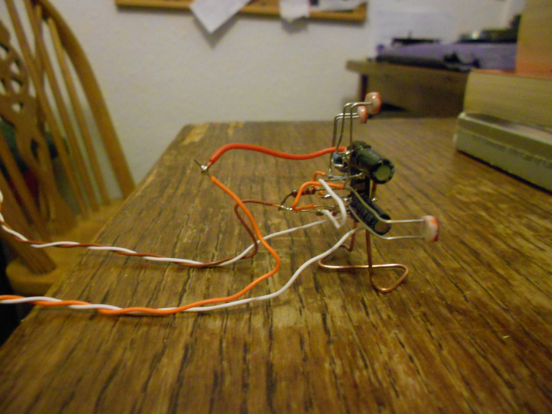

How long was I gone? About 2 hours? I think that's a pretty good conception to completion time Wink Three LDR controlled oscillators on a 4093 chip, two are heterodyned with one of the remaining gates and then used to gate the third higher frequency oscillator.
The wires coming out of it are the output and power connections. It is powered by a 3V coin cell and output was through a resistor voltage divider so it wasn't giving full 3V output (I thought that might be a bit much for my computer's line in) after the voltage divider it was more like 300mV, it was happy with that Smile
I think I'll call it Graxnorgrath; "The thing from another world, of junk"

This is the sound it makes.
