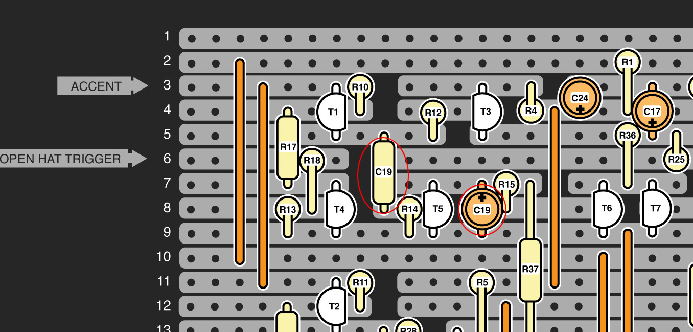

-minus- wrote: | Check that your components are in the right holes. |
I have updated the diagram on page one now. It should be correct. With that jumper as it was, there would be no pull up resistors (R21 and R22) from the transistor bases of T1 and T2 to the +V. They were being pulled to GROUND! |

Hurm.
I have some medium-large stripboards (4" x 5") that I'm using and I've mapped out how to put all 4 circuits onto 2 stripboards. This first one is the sound source + the hi hats, next I'll put my attention on the cymbal and cowbell....
I have the closed hi hat working fine, but the open hat is not getting any envelope, it's just constant noise. I did have some shorts earlier that were causing R1 to burn, but those are resolved....I will have to see if perhaps I've messed up some transistors.... Need more study of the original schematic, apparently |

OK good. At least you have the closed part working. I'm fairly certain the layout is correct, although of course mistakes can happen. I can always double check with my working stripboard if you get stuck. |
Joined: Mar 20, 2012 Posts: 2177 Location: Chicago
Posted: Mon Apr 01, 2013 4:47 am Post subject:
What I found before going to bed ridiculously late was that even with T3, T6, T7, and T8 removed, I have nearly 15V at the emitter of T3. This should not be; removing those guys removes all the active paths that get me to 15V, so there is not a bad transistor. And I just checked and there is a dead short to the 15V rail, so....just gotta find it.
Edit: And 5 minutes later it's trivial: insufficient cut between this section and the +15 that went to the collector of T8. We have hi hats |
