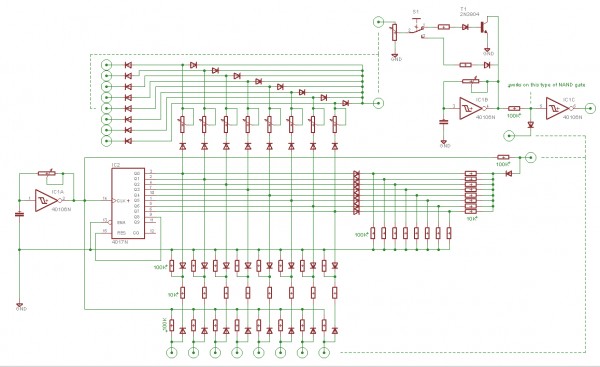

PostPosted: Thu Oct 18, 2012 5:02 pm    Post subject: Reply with quote  Mark this post and the followings unread
Made a few adjustments to the controller I posted previously. I added external inputs and a 4017. I also removed the transistors for a de-bounce circuit with a momentary switch. I added some pots to the output which give me some variety on the output, it doesn’t do much when I run it out to a gate input but it works for the frequency modulation.
I find the LED to ground with a 1K resistor are needed to get the gate that I want on the osc's. I was able to step through a 4017 with the output set up to the clock input by touching the momentary switch as well, I really liked that.
wondering if I need a 100K oull down to ground on the paths from the 4017 to the 40106's inputs?

Having a bit of trouble with building a sequencer for the oscillators I have, I start with the baby 10 thinking that is simplest place to start. The sequencer that I current have working, only in 4 steps, I’m attaching below perhaps others will have a better way to accomplish this.
The problem that I am having is getting the gate to work at one output. I eventually have what I am using through trial and error, no theory at all. I made an AND gate at the end just to give it that punctuation on each gate from the 4017. I would like to change that out to a CD4081 but I’ll have to order it, but I’ll wait until I see if there is a better solution. I was only able to get the sequencer to work with NAND logic sent into the input of the 40106. This is what I have my oscillators using as a gate anyway, but I’m unsure if it will work with anything else, as I don’t have anything else at this time.
I’ve tried several schematics I found online but none of them seem to really do it, individual gate will work fine but a linear sequence no, most likely due to the way I have the oscillators set up, and the ones that I’m sure would work are more complicated then I want for this, I want to keep it as simple as I can.
I didn’t tie the pots to ground as I didn’t like the way that work for my oscillators but I have to try it again seeing that is how most schematics seem to do it.
I still have to figure out how to get LED’s in there but my breadboards have no room left.
since it is working with the osc that I have I'm thinking maybe I just keep it, and change the AND gates to the 4081 or at least see if they make it easier when I have to actually solder this up...
Im still running at 5V so I don't know if it will work at at 9v or more.
being a noob is fustrating...

I'm not entirely following what you're trying to do. The core is straightforward enough, as are the blocks above it, but once I get into the upper right, I lose track of things.
Questions occur to me like: do you mean to have a pull-up resistor on that transistor? That would make it invert the incoming signal.
What are you trying to do with the 100k & 10k resistor and diode banks to the right and bottom?
If I just focus on a single pin out, it looks to me like one of the diodes bypasses the other leg of the circuit, see the attachment. the left path is the diode & resistor to the right, and the other is the first diode going down.

The far top right is the oscillator itself that I was testing everything on. The dotted line is just there to point to which input and outputs I was connectinh them to. After the 4017 there are three paths that break off to folded, the top is to modulate freq, the right is all 8 gates to a single output, the bottom to output single steps. At the end of each gate the is an AND logic with incoming signal from the path and the clock input. The pull down resistors are the only way I could get it to work without the LED's...no theory just trying stuff till it worked, I'm sure there is a better way to do it. Just having the OR logic with AND at the end didn't work for me.

You can think about current like water. That single diode offers a lot less resistance to the flow, so most of the current is going to go that way, and almost none will go through the one with the two resistors attached.

I wasn't thinking that a pull down to ground with a resistor after it was the same as two resistors in series.
I'll re-draw only a portion of it tonight to just test one part of it.
