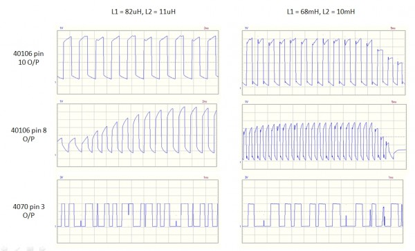

PostPosted: Fri Nov 23, 2012 9:01 am    Post subject: Experiments So Far... Reply with quote  Mark this post and the followings unread
I've been trying out your oscillators on my PC scope, but I'm not sure if I've discovered anything too exciting yet! I've been using two 40106 oscillators to work the trigger and accent, but they are not synchronised.
The problem is that, although the waveforms pre-4070 look like they are being filtered somewhat, the output post-4070 has been squared-up again. There may be subtle phase-shifts going on, but I haven't yet spotted any radical signs of it. I've tried changing L1 and L2 to 68mH and 10mH respectively (about 3 orders of magnitude higher) and it does affect the outputs at pins 10 and 8 of the 40106, but the output at pin 3 of the 4070 doesn't look substantially different. I've recorded a bit of each for you to listen to, to see if you can spot the difference. I will try some variable inductors next, as it may be more easy to spot the difference as you alter the inductance.
Anyway, that's all I've done for now.

Posts: 4742
Audio files: 51
PostPosted: Fri Nov 23, 2012 3:14 pm    Post subject: Reply with quote  Mark this post and the followings unread
Wow,
Thanks heaps for doing those scope shots Gary.
I would have thought that all those holes in the 4070 trace show that there is alot of phase cancellation going on. Remember, I don't want these inductors to "filter" the output. Simply to create more delay, and hopefully add more strange artifacts, especially when the other half of the 40106 is setup as the second oscillator. The phase delay will be more obvious when the tune is adjusted, I hope.
Everything will go through the WSG filter after this.
