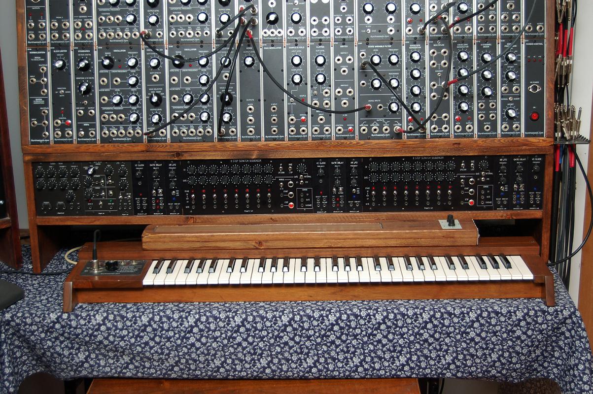

I finally got around to finishing my row of Frac modules, the modules are all of my own design, panels are from FPE.
1x Tuneable Noise, base on my pcb layout for the Liquid Hi Hat
1x Gate Delay (New version)
1x LPG, my own layout
3x Gate Delay (old version)
3x Voltage Controlled Clock, based on the Aries clock module
3x XR LFO, LFO based on the XR2206
2x 8 Channel Sequencers
The old version of the Gate Delay just delayed the start of the gate, it still ended when you released the key, I wasn't happy with that,
so I redesigned it, the new version has 4 modes,
Normal - works the same as the old version
Extended - Delays the start of the gate, and lets you extend the gate past the point where you release the key
Manual - delays the start of the gate, and lets you set a specific length, regardless of whether the key has been released
Timed - delays the start of the gate and keeps it on for the same length of time as the key was held down.
The sequencers can run of an internal clock, or the length can be set individually for each step, they also have a Cascade output so you can chain them together,
the time between triggering the next sequencer in the chain is adjustable.
I am currently working on a couple Midi projects (I'm using blue panels on them), and a cv keyboard retrofit for the cheap (M-Audio) Fatar keyboards
I am also in the process of building a CNC engraving machine, so I can start doing the panels myself.
