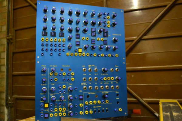

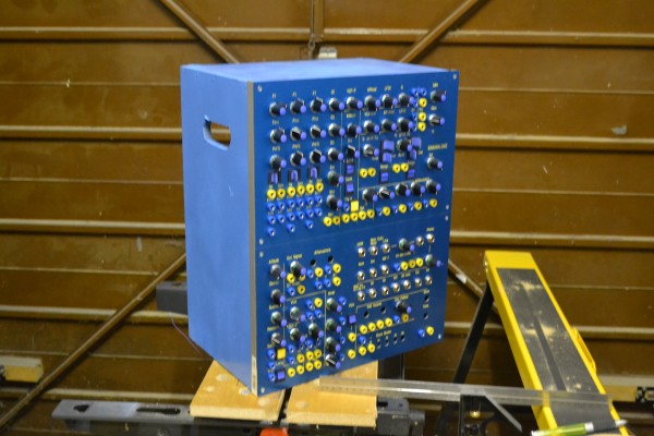

ashleym
Joined: Aug 20, 2009
Posts: 157
Location: uk
PostPosted: Thu Dec 27, 2012 12:44 pm    Post subject: Reply with quote  Mark this post and the followings unread
I put both into one cabinet. (The cabinet has been finished for a while but I have only now had the time to mate the two. Not the best fit but I have zero woodworking skills so any result is good. I was cutting and drilling today to make some speakers and if I can make a square box anyone can!!). I would think twice about transparent cabinets because they will look very busy with all the panel components and wiring. I think this will hinder easy "reading" of a patch etc- just my opinion and SDIY is about getting what you want so ignore me if you want Cool

olledahlberg
Joined: Nov 28, 2012
Posts: 17
Location: sweden
PostPosted: Thu Dec 27, 2012 2:59 pm    Post subject: Reply with quote  Mark this post and the followings unread
That one piece of nice front panel! I think its ok to build a transperent case since my front panels will be aluminium (bought the ultimate from Ray and making the expander panel my self).
ashleym
Posts: 157
Location: uk
PostPosted: Thu Dec 27, 2012 4:04 pm    Post subject: Reply with quote  Mark this post and the followings unread
Thanks for that.
I have made up 2 panels. They are just mounted in the same box. One as the regular Ultimate and the bottom as an expanded Expander. I have an MFOS sequencer made to the same panel size and when that is up and running I will post some more pictures.
