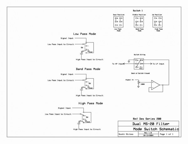

PostPosted: Sat Jul 20, 2013 10:09 am    Post subject: Reply with quote  Mark this post and the followings unread
hiya,
I built this and it works great (a few modifications to the layout to get it working) now I would like to add a 3 way switch to change LP HP BP
I have a slide switch (shown below) can anyone translate the wiring diagram for my switch...my brain hurts
cheers.

I project to make this MS20 filter clone, so I do a new vero layout (smaller, and without the mistakes). I'll post it very soon.
But I don't understand why there are these 100nF (C6 to C9) between +15 -15V and ground, and why put it 2 times ? They are not present in the schematic.
Thanks
It's an old post, hope someone follow it yet.
Snaper
Joined: Feb 28, 2014
Posts: 202
Location: Hungary
PostPosted: Tue Mar 03, 2015 8:14 pm    Post subject: Reply with quote  Mark this post and the followings unread
I think they are fot stabilizing the power. I usually add 2 10u and 2 100n.
Thelonious
Joined: Mar 03, 2015
Posts: 5
PostPosted: Wed Mar 04, 2015 4:15 pm    Post subject: Reply with quote  Mark this post and the followings unread
Ok thanks snaper.
I finish my layout.
I made 2 versions, one "normal" and one with hoyager's mods.
But I have some questions.
For the "normal" version :
What is the value of C4.1 ?
Switch A1 and A2 are connect to ground, and A3 without connection ?
The DPDT is ON-ON (B1 is Lowpass input, and B3 is Highpass input) ?
For the hoyager version :
Don't understand this : "use an 8.2k resistor from the res3/out to the lug 3 of res pot (as per ms20) " ? (It's a bit confused)
And this : "add a 47k resistor from the hi pass input (gnd end of C4) to gnd ." ? (If I understand, he want to put a 47k in serie with C4 before to go to ground).
I can send you my layouts if you want.
Thanks
