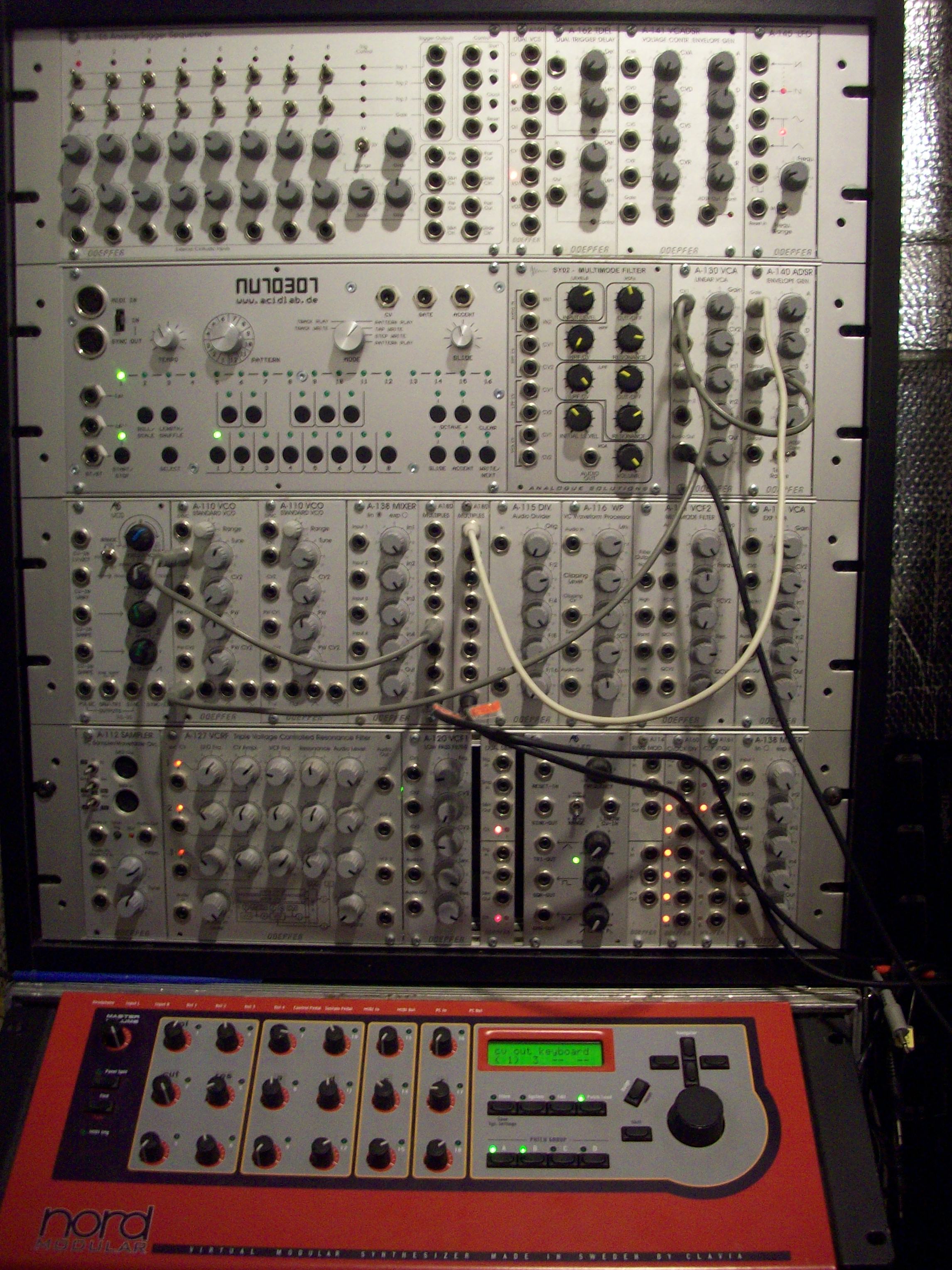

Nucleus
Joined: Dec 27, 2012
Posts: 4
Location: Minneapolis, Minnesota
PostPosted: Thu Dec 27, 2012 10:06 am    Post subject: nord modular G1 CV out
Subject description: voltage doubling circuit
Is there a simple control voltage amplifying circuit that would increase the 2.41volts (positive and negative) max signal that I measured before the coupling capacitor up to close to the 5 volts+- signal that would be more friendly with Doepfer modules?
The power supply in the nm1 rack has +5v -5v +3v and +9v.

varice
Joined: Dec 29, 2004
Posts: 626
G2 patch files: 46
PostPosted: Fri Dec 28, 2012 5:36 pm    Post subject: Re: nord modular G1 CV out
Nucleus, welcome to the electro-music.com forum Exclamation
Yes there is a simple amplifier, an opamp configured as a non-inverting amplifier. You might try searching the net for specific circuit examples, or ask for examples in the DIY forum here at electro-music.com:
http://electro-music.com/forum/forum-112.html
But, it might not be a good idea to try to install such an amp in the NM1 because the power supply voltages are so low (would be much better to have +-12 or 15 volt rails!). You could use an LM324 opamp with the NM1 -5 and +9 power supply rails, but you would run the risk of clipping the -5V CV output.
When I modified my G2X to get a DC CV output signal to control the cutoff of my Moog MF-101 Low Pass Filter, I also ran into the problem of the G2X CV signal being too low. My easy and cheap solution was to modify the CV summing circuit in the MF-101 to increase the sensitivity of the external CV input. If you haven’t seen it already, that is discussed here:
http://electro-music.com/forum/topic-12266.html
So, the easiest and cheapest solution may be to just modify the desired CV inputs of your synth modules.
Or, for an off the shelf (but expensive!) solution, add a Doepfer A-183-3 module for each CV that needs to be amplified.
Good luck and please share with us the results of your work. I also have a NM1 Rack and have thought about doing a DC CV mod of the outputs to control an analog mono synth… Very Happy

Nucleus
Posts: 4
PostPosted: Sun Dec 30, 2012 3:53 pm    Post subject: nord modular c/v out Reply with quote  Mark this post and the followings unread
OK I've been working on the c/v out plan, found some simple opamp circuits on howtobuildarobot.com web site. I was about to order some parts then thought I would check output voltage again and I was able to get 4.78v. I headed to Radio Shack to pick up a couple 1/8" cables with stripped ends and 1/4th watt 470 ohm resistors. The varice mod only took about a half hour. I tried playing the keyboard, not only was it not 1v/octave but the higher up I would play the lower the oscillator would go! The output voltage is inverted! That was a bit mind bending. Once I used the voltage inverter part of the InvLevShift module it sounded better. Maybe this is what 3phase was referring to when he wrote about the NM1 signal not being scalable or useable. I have gotten in the 4+ volt range by inserting an amplifier module and cabling the output to the same channel of 2 separate output modules. I haven't figured out what settings yield 1v/octave yet.
It is exciting being able to control my modular with all these nord virtual modules!
note: These are not instructions for someone to follow and blame me if they blow up something. Confused
Some pictures:
[img][/img]
Soldering to the small solder pad in front of the coupler capacitor was delicate. I tinned the end of the resistor wire with a little drop of solder.

Nucleus
Posts: 4
PostPosted: Mon Dec 31, 2012 9:23 am    Post subject: nord modular c/v out Reply with quote  Mark this post and the followings unread
I made a patch with 1v/octave and gate output. All these years the NM1 was a basket case (no midi note or c/v output). Now it has nine yes nine octaves of c/v and gate output: -4.4v to -3.409v to -2.394v to -1.379v to -.364v to +.65v to +1.665v to +2.68v to +3.68v to +4.65v. When I bought my NM1 in I think 1998 I set it next to the Doepfer modular and wondered how I could interface these two. Thanks to varice and 3phase's posts I finally did it!
Here is a picture of the patch:
and the rest of the patch:
