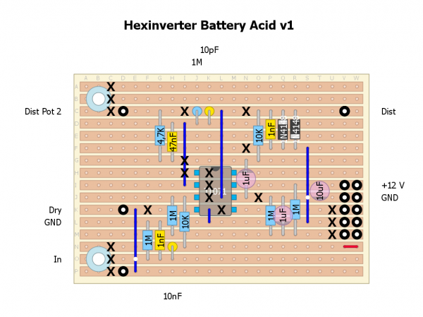

Updated layout attached, tested and working!!!

PostPosted: Wed Dec 30, 2015 8:53 am    Post subject: Reply with quote  Mark this post and the followings unread
Hi, Sure, I will try.
Input and output pots are just attenuators, so leg 1 into ground, leg 3 is the input, leg 2 is the out.
About the dist pot and the switch, here is the original schematic :
http://legacy.hexinverter.net//files/projects/batteryacid-v10/batteryACID_v1.0_schematic.png
Leg 1 of the dist pot is not connected leg 2 is to the pad (on the layout), and leg 3 to ground.
As you can see, the switch is a simple spdt switch.
Do not forget, that the white little dots means that those jumpers are joined there, so you have to use two little jumpers Very Happy

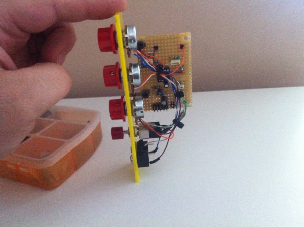

PostPosted: Mon Apr 18, 2016 9:16 am    Post subject: Reply with quote  Mark this post and the followings unread
so i built this and theres something wrong.
when i turn the distortion pot up and down it just turns the voume up and down, there is no distortion to be heard at all.
the signal is travelling stright through without effect. when the switch is switched it only allows the distortion pot to adjust volume.
ive re-flowed the whole board but nothing
any ideas?

PostPosted: Wed Apr 20, 2016 1:10 pm    Post subject: Reply with quote  Mark this post and the followings unread
what are you using as your sound source ?
as Blue Hell mentioned if the level is too low it won't clip, but with the amplification being adjustable to >200x
and the voltage drop over the diodes being 1V that would be a very low signal level (< 0,005V). Another thing, if you are using
a square wave you might not hear the effect. Do you have a scope so you can see what the output level is ? an AC Volt meter
might work too with a simple sinewave on the input but a scope would be much more useful.
You say the distortion pot works as a level control so you seem to have something correct, because it simply adjusts the gain and
that would sound like that if the signal wasn't being clipped. Using the schematic posted here there are a couple things you could check:
1M resistor R4 (if it is too small it would attenuate the input signal)
10K resistor R5 (if it is too big the signal would also be attenuated)
1M resistor R1 (if it too small you won't get enough gain)
diodes D1, D2 (if not connected correctly the signal won't get clipped)
Also since it is stripboard there is a higher change of shorts between traces, but since you are getting a signal out I doubt that is the case.
And last but not least, as Snaper mentioned:
Do not forget, that the white little dots means that those jumpers are joined there, so you have to use two little jumpers.
If you didn't do that the circuit probably wouldn't have worked at all though, but I noticed that one of those connects the diodes to GND.
on a side note, the 1M resistor R8 seems useless to me. It is parallel to the 100K pot and too large to make much of a difference. scratch

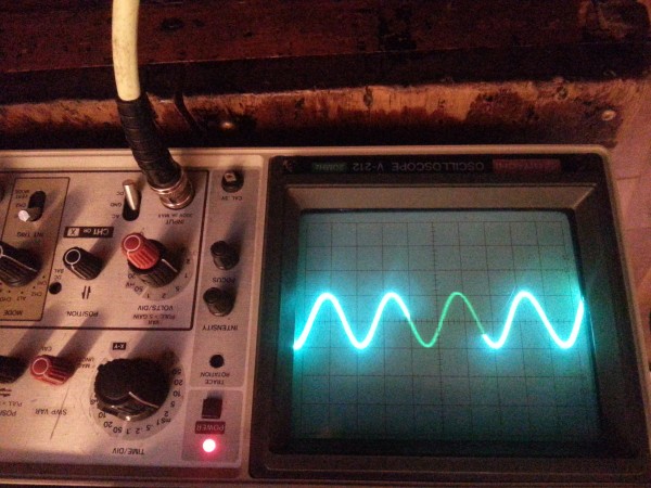

If you didn't do that the circuit probably wouldn't have worked at all though, but I noticed that one of those connects the diodes to GND.:
Foniks 555 TH VCO is my source, tried with a scope and although the sine shape is being affected (slightly) but there is no audible change.
I'm pretty sure all connections are correct, all values have been triple checked and reflowed numerous times. im starting to suspect the IC, or even the stipboard itself.
ill rebuild on better quality stip and see what happens.

PostPosted: Mon Apr 25, 2016 2:11 pm    Post subject: Reply with quote  Mark this post and the followings unread
Here are a couple of pics. First one straight from the sine output of the 555 vco
Second one is with all pots cw. Input and output pots adjust level as expected. Distortion switch and pot do nothing , sorry this is different from what I thought I had observed in that the dist pot doesn't work at all. Even when bridged at the lugs with a wire to test.

PostPosted: Wed May 25, 2016 2:27 am    Post subject: Reply with quote  Mark this post and the followings unread
oh dear almost forgot about this. Maybe you already built a new one but what I see on the scope is petty much what I would expect.
but since you can't control it you probably get full distortion all the time.
Could there be something wrong with the pot ?!
