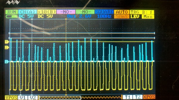

I'm working on what I want to be a variable clock circuit, generating triggers rather than gates (i.e. pulses instead of square waves).
Step one: simple LFO with a 40106, check.
Step two: condition the output with a trigger conditioner. Fail.
I've tried this both with the one that Fonik has in the baby-10 sequencer schematic (upper right: http://modular.fonik.de/pdf/baby10.pdf) and the simpler one from Thomas Henry's Electronic Drum Cookbook (although I didn't swap the LM358 for a 741 when I simplified it, but a single sided op amp is a single sided op amp... for this purpose anyway). The simpler circuit omits the first 100k, the diode, and the 47k from Fonik's schematic.
Both of them exhibit the behavior illustrated in the photo. Yellow is the output of the 40106 osc, and blue is the output of the trigger conditioner.
1) I have a nasty >5V triangle wave across the top of it, limiting my amplitude.
2) I am periodically getting triggers on both the rising and the falling edges of the clock signal..
If you look carefully, you can see some distortion in the 40106 output that maps exactly to the triangle wave (and it's 180 degree mirror).
I've also noticed that the apparent triangle is insensitive to the time scale. Switching from 50ms as pictures to 200, the triangle appears to have the same shape-- it doesn't compress like the width of the pulses, for example. I've seen it before and always written it off as an artifact of my scope. It also doesn't change if I use the 10x setting on the probe, or if I move the probe (I thought at one point I was injecting it from the scope, and the glitchiness in the square wave was causing the variability in the trigger pulses).
Now, I'm not in a pristine RF environment, but 5V?? I don't see that in the ground, or V+ lines. Bypasses don't make any difference. Grounding all the various unused inputs doesn't make any difference.
I *am* using full length leads on several of the resistors, rather than cutting them to length for the breadboard.
But I'm lost here.
Any ideas?

Pretty interesting.. it looks like your conditioned triggers are being modulated by another LFO. Just curious, but do you get that same triangle wave shaped artifact when you scope a different signal.. like one of your operating VCOs or LFOs? IOW, is it something from within your scope? Seems to me if it's not affected by the channel timebase it's something internal, maybe somehow related to the screen power... maybe you could isolate it using the scope's block diagram or schematic. The weirdest part is that the triangle and its mirror are actually visible on both channels (I didn't notice it at first in the triggers, but see it now... strange...)
If it doesn't show up when you scope another module that would mostly eliminate the scope itself as the culprit (I would think). The curious thing for me is that it's a constant relative to the screen and not the signal being displayed (at least that's what I take from your description...).
I'll be anxious to hear what it finally turns out to be. By all means, keep us informed if you make any progress with it.

I guess your signal is fine and your scope too slow Smile
( see wikipedia "aliasing" )

Yep, scope artifact. A well-known commercial vendor once told me one of my trigger outputs wasn't working right. When he switched to an analog scope it suddenly was fine.

Do you think that's true of the double triggers as well?
I've tried slowing things down and see similar results, which in the past has solved more obvious aliasing problems.
Any suggestions for how to test in the absence of a handy analog scope? Smile

You could clock a toggle flip-flop or a counter with the trigger pulses. That would give an output clock at half the rate of the original clock. You'll probably see any errors easily. You could compare it to the original clock divided by two as they should be the same.
Alternatively, you could make a poor mans comparative counter with a couple of CD4040s or similar, common reset, gate the clock inputs with a common signal, clock the two counters with your original and conditioned signals and if the counts are off by more than one over any period you've got a problem.
This doesn't address the voltage level issue. You could do the same tests with a voltage comparator on the clock input and adjust the threshold to see if it craps out before you'd expect. I'd think this unnecessary.

you should try the opposite direction: use a gate pulse width that is only3..5
times the trigger pulse width. Then you can use a much faster sampling frequency with your scope and the aliasing effects will go down

Ok, that's basically doing the same thing I was trying to do with the comparator, which is where it appears to be getting double triggered. I'll give that a shot. This is all on breadboard at the moment, for exactly these reasons.

Looking at the scope shot for the third time, it is pretty obvious you have double triggering. I think you need some hysteresis (positive feedback) on the comparators. I'd try 1M to see if that fixes it and go down by 50% steps if it doesn't.
