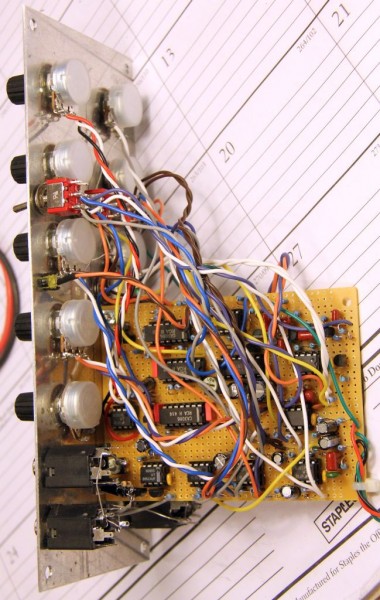

PostPosted: Sun Apr 28, 2013 1:06 pm    Post subject: Reply with quote  Mark this post and the followings unread
I perfboarded the SDS-3 circuit several months ago and was able to make all of the sections work. The "Factory" schematic is full of errors and missing components. I did a lot of research about the SDS-3 in order to determine why the circuit does not work when built according to the schematic. The perfboard is pretty ugly and is kind of a "furball" but it did allow me to test everything out.
One of the biggest discoveries that I made was that the filter/osc design is Moog, but indirectly. It is really almost identical to the ARP 4035 module. In fact I found a small story about Dave Simmons and it mentioned that he used an ARP-2600 synth to test his idea and create the prototype.
This info helped a lot because I was able to debug the schematic when compared with the 4035 filter design. The only real difference is that the pins on the CA3086 ICs have been swapped around.
The schematic is so full of errors that I wonder if it is really a "Factory" schematic, or if it is, I wondered if the errors were placed there on purpose to mislead and prevent copying.
Here is a list of errors, corrections, and additions that I made to make everything work:
1.) The biggest error is that pins 2 & 3 of IC3a are swapped. This prevents the filter from operating completely. Pin 2 should connect to the junction of R51 and R53, and Pin 3 should connect to the junction of R50 and R52.
2.) The control voltage to the filter is overdriven and a 3.3K resistor needs to connect from the base of T2 (Junction of R24, R23, R28, and R33) to ground. This effects the total control of the filter and the value may be adjusted as desired.
3.) Capacitor C20 (0.47 uF) should connect to the collector of T13, not the emitter of T9.
4.) The bottom side of the 22k resistor R81 (junction of R86, D9, R87 and R88) should connect to -15V.
5.) The junction of Pins 3 & 6 of IC7 and R73 (LFO) should be connected to ground.
6.) The 22k resistor connected to Pin 5 of IC10 (Run generator) should be 2.2k.
7.) All of the LEDs are connected backwards.
8.) The 470k Decay Time pot should be audio taper.
9.) The 100k Run Time pot (92) should be audio taper.
10.) I modified the circuit to match the noise bleed-through mod in the bottom right of the schematic, but it still would be better with separate noise and Tone level controls I think.
11.) These changes should make everything work, but I'm sure further improvements could be made.
I was going to enter the schematic into Eagle and make a PCB but I have to may other responsibilities right now. My idea was to make a PCB with the LFO and Run Generator included, make four boards and only populate the LFO and Run Gen on one of the boards. This would create a full SDS-3 module.
Regards,
Theff

Moogah
Joined: Dec 26, 2007
Posts: 26
Location: USA
PostPosted: Sun Apr 28, 2013 2:11 pm    Post subject:   Reply with quote  Mark this post and the followings unread
Wow! Very cool man, I'd noticed the many errors in the ladder filter and was coincidentally using my layout for the arp4035 as a starting point for this hah.
My SEM filter boards are just now getting into peoples hands and helping people get going on that will be my #1 priority for a little bit, but I could have a prototype layout ready pretty quickly now with the info you've found!

PostPosted: Mon Apr 29, 2013 4:01 am    Post subject: Reply with quote  Mark this post and the followings unread
I had Fonik schematic layed out in eagle so I added Tim's corrections to it. I think i didn't omit anything. I'll make a prototype this week (board is already done) and report back.
I've added the bleed thru mod also but i'm not to sure of the R58 (22K). Is the down arrow means it goes where it was previously meant to go or does it connect to -15V ?
If anyone finds errors before I etch, please report back.
