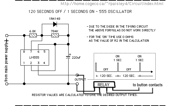

I read that one person on here was able to defeat the dreaded auto-power off on the Casio SK-1 with a simple 555 circuit.
http://electro-music.com/forum/post-266638.html
I went to the store to buy the parts, however the clerk told me that I needed the specific voltage relay in order for it to work. Does anyone know what this voltage would be?

OK then. Err by the way, why use a relay ? I used optocouplers to electrically simulate the press of a switch on mine, and Top Top used 4066's (I even suspect a transistor would make it)… I must be missing something.

I'm not sure really. That was the only success story I've heard from this mod (besides the jumper one which didn't work for me). And, this circuit seems pretty simple with a 5V relay. What would you recommend?

hey guys,
does this seem to be the right way to hook up the relay to the circuit? Also, where would I get the input power from? would it be the main dc in jack?

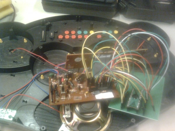

does anyone know if the casio SK power off function works the same for the casio MT? I have a casio MT-52 and MT-35 and these also have this power off function which is not suitable for live situations.
lately i have successfully disabled the "battery alarm bell" in a bontempi drum pad (1992), by disconnecting pin 10 of the chip (see picture). BTW.
now i want to get rid of the auto shut off for casio mt, when i see the previous posts is this not a chip issue?
