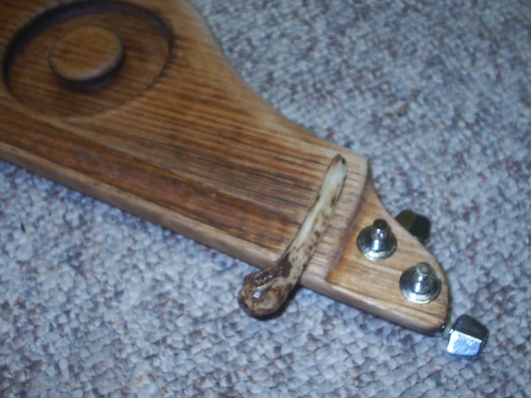

Okay, the pointy end! Everything is good here, but I need a wide, brass, U shaped hold-down, just behind the nut, as the machine heads sit a bit high to guarantee a good hold on the nut slots (when they happen!)

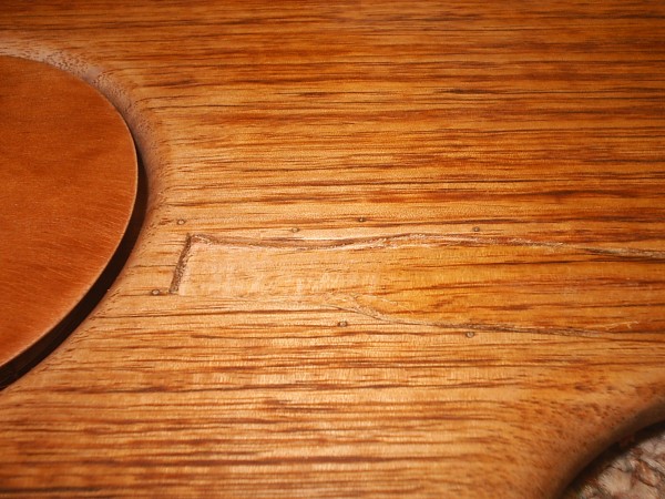

More pics April 2013
This is a really nice shot. Shows the texture of the wood nicely, note the pickup top is Queensland maple, the body is (probably) Tassie oak.
This is where the softpot will disappear into the body. I'll have a small 3way DIL socket here to plug it into.

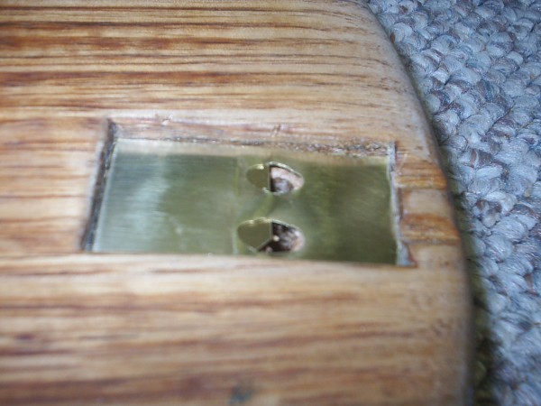

Then it will get covered by this little brass plate.
