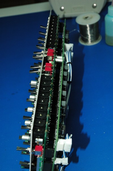

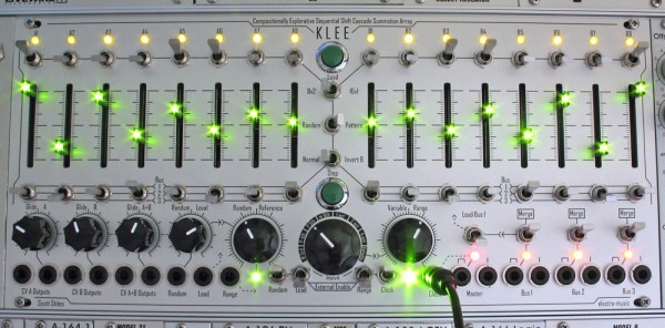

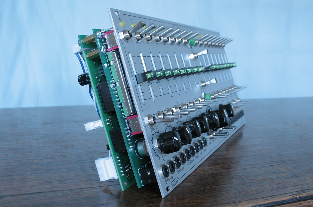

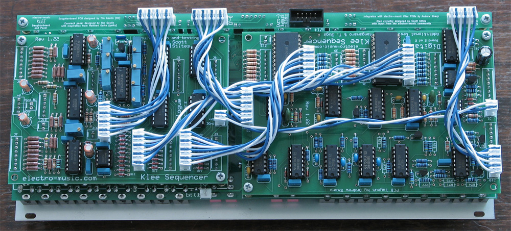

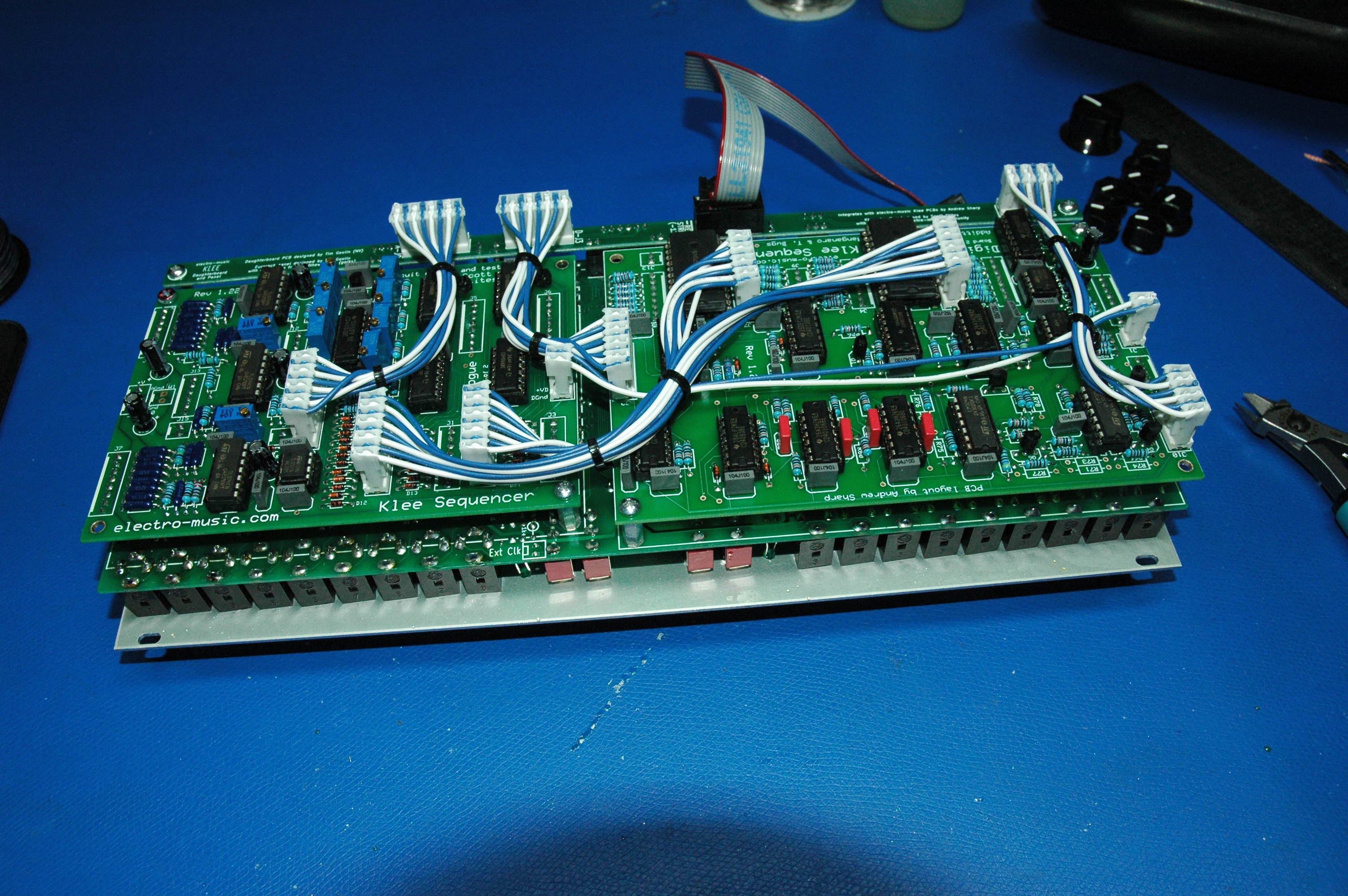

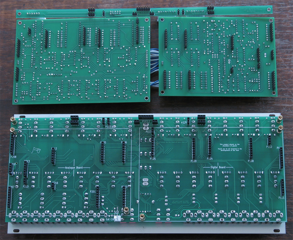

The Klee is one of the most unique and inspiring sequencers in existence. Obtaining one, however, is a dark path - a trial by fire paved with the corpses of 140 flying wires and slick with the blood of 135 ground points. There's also the unfortunate side effect of hearing the lamenting wails of dozens of feet of sacrificial wire insulation echoing throughout the cabinet in which you've placed any hand-wired Klee. This gets loud on weekends.
But today we rejoice, for no longer shall we suffer the plague of a single swapped wire or stare down the lone forgotten ground point buried beneath a swarm of spaghetti.
This is an order thread for a Eurorack format Klee front panel, accompanying daughterboard, and panel component kit. The front panel is a 56HP milled and anodized panel matched to a daughterboard to which every panel component is soldered. The daughterboard mates with the electro-music Klee PCBs via SIL pins and headers, allowing the Klee boards to plug directly into the daughterboard. The exceptions are the board interconnection cables and three additional cables running to headers on the daughterboard, but fortunately for those of us with the MTA handtool permanently imprinted into our palm these cables are already prepared and included with the boards. This means not a single cable to build or wire to run for one of the most wiring intensive projects in SDIY.
To place things into perspective, after completing the main analogue/digital Klee boards it took me more than a week of working several hours each day to hand-wire a 5U Klee. When I built up this kit it took me 3 hours.
The daughterboard is secured to the front panel via the numerous panel components, allowing the use of illuminated sliders for the programming pots. The boards make a secure fit with the headers alone, but two additional mounting points are provided for threaded standoffs on each board to make sure everything stays put. As a result of the SIL header integration between the Klee boards and the daughterboard, the total depth of a completed module comes in at 48mm - shallow enough for most Goike skiffs.
This iteration of the Klee accommodates all of the optional features listed in the Klee documentation, as well as a handful of additional modifications listed below:
  • LED driver indicating the input of the external range function.
  • Normaled random voltage to allow for use as a persistent load on/off switch in the absence of an external input.
  • Internal system clock normalization option via a header connected to the switching lead of the clock input jack (expected number of people utilizing this: 0)
Included with the panel and daughterboard is a panel component kit consisting of everything you'll mount onto the daughterboards except for the LEDs, pushbuttons, and knobs - these were left out to allow for customization on the builder's end. The knob dials come in at 17mm, 21mm, and 24mm diameters, and the pushbuttons come in 4 different colors - red, green, yellow, and black. The panel is drilled for standard 3mm T1 LEDs.
The sliders are a custom variant of the Alpha LED slider - custom in that the lever is a longer 20mm and the center detent is eliminated. The LEDs on these sliders come as green but they can easily be swapped for any LED equal to or less than 3.2mm wide - nearly any standard T1 3mm LED will fit, and a dab of glue will secure any that don't. Additionally the slider LEDs can be set as either constantly on or synchronized with the bit LEDs above. The switches are of the flatted variety, which are as satisfying to flip as a miniature switch can get. The jacks are the same stereo switching jacks from my prior group buy and are in my opinion the highest quality jacks currently in euro. The pots are 12mm Alphas, the rotary is PCB mounted with a smooth action, and the wire is imbued with unicorn hair. In short, these are all quality parts to which the board and panel have been tailor fitted.
Additionally the kit includes all of the SIL sockets, pin headers, MTA headers, and mounting hardware needed to integrate the daughterboard with the main boards, as well as pre-built cables for the few remaining MTA headers and for connecting to a Eurorack power busboard.

This...is FREAKING AWESOME!
My Site
Posts: 24075
Audio files: 277
PostPosted: Mon Mar 11, 2013 5:43 pm    Post subject: Reply with quote  Mark this post and the followings unread
Too easy, can't be a klee Shocked Laughing
sorry
it looks great I mean, lots easier to construct and nicely compact too, good job!

The panel measurements are 284.15mm x 128.4mm. The daughterboard PCB measures 111mm x 284mm once assembled (the thin top board is initially attached via an easily separated v-score).
The depth from the panel to the PCB is 14mm when built in the "shallow" way, with a max of about 18mm if you don't use the 3.5mm jacks and really push the switches out to the end of their pins and threads. However, the space allowed horizontally for each jack is 11.25mm. In other words, a bit too tight for 1/4".
However, all of the jacks are mounted along the bottom and use large pads that can easily fit up to an 18awg wire. In theory you could build another 1U panel beneath it to mount all your 1/4" jacks and run some wires. The silk screening for each jack footprint is clearly labeled so it should be easy to figure out what goes where.
elmegil wrote:
I grok that Synthcube's kit covers 15V operation for the Klee boards themselves, but will your stuff also operate at 15V?
Everything in the kit will operate just fine on 15V operation. The only thing you may want to change will be the 4.7k resistors for the slider LEDs - these were chosen to match with the 4.7k LED resistors that would be used on the main analogue/digital Klee boards for 12V operation. For 15V operation 6.8k is a better idea on the main boards, so change the slider resistors to 6.8k and everything should be fine. If you're going with the option to have the sliders lit in unison with the bit LEDs then a jumper is used instead of a resistor - unless you're using crazy LEDs. This will be covered in the build manual which I'm currently working on and will have up before the kits begin to ship.
The kit includes a 1k resistor which determines the maximum brightness for the external range LED indicator. I went with 1k on this because it allows a much wider range of brightness to more accurately indicate the voltage. The LED will last just as long with 1k at 15V, but if you want a perfect brightness match you could go with another 4.7k or 6.8k in that place.
Other than that the kit has a header for euro operation (10-pin IDC ribbon) but there's plenty of space around the pads to attach some wires to run to any header you prefer.
The analogue/digital Klee boards will need to be built for 15V operation as well, which just means using the proper resistors in the LED and Gate sections.

I had to remove the MTA headers on my original build as well. Here's my technique so you can benefit from the agony I went through:
  • Don't try to remove the entire header at once - do one pin at a time
  • Grip the pin you're removing on the component side with some needle nose pliers
  • Heat up the joint on the solder side with your iron
  • Pull the pin through with the pliers - it should slide right out of the MTA plastic with just a little effort
  • Repeat for all the pins of that header
  • Put the board on its side, heat up the solder still left in the joint, and use a solder sucker on the other side to suck it out
Once I figured out the pin-at-a-time technique it didn't take long for me to remove all the headers necessary. I spent like a half hour removing ONE header before figuring that out. Be sure that you know which headers remain as headers and not pins - these are...
Analogue board: J2, J4, J9, J11
Digital board: J1, J3, J6, J7, J10
The kits include MTA headers for these positions, so if you accidentally remove one don't worry about it.

I took the time this holiday to build my Euro Klee ! Tim did a fantastic job on the build manual and everything went together perfectly. The illustrations and step by step instructions are top notch ! The trickiest part of the build was the daughter board alignment with the front panel and all the panel components. With patience and careful handling though, the job will get done successfully Cool
I do recommend that all the panel components be checked before installing them since it will be a big job to replace them if you find one or two bad after the build. The completed module has a bit of mass and weighs in at 2 lb, 1 oz (.94 KG).
This Euro Klee sequencer, along with my new Tip Top Audio matrix sequencer (scheduled to arrive at my door this coming Monday), will be a nice addition to my Euro style synthesizer project.
