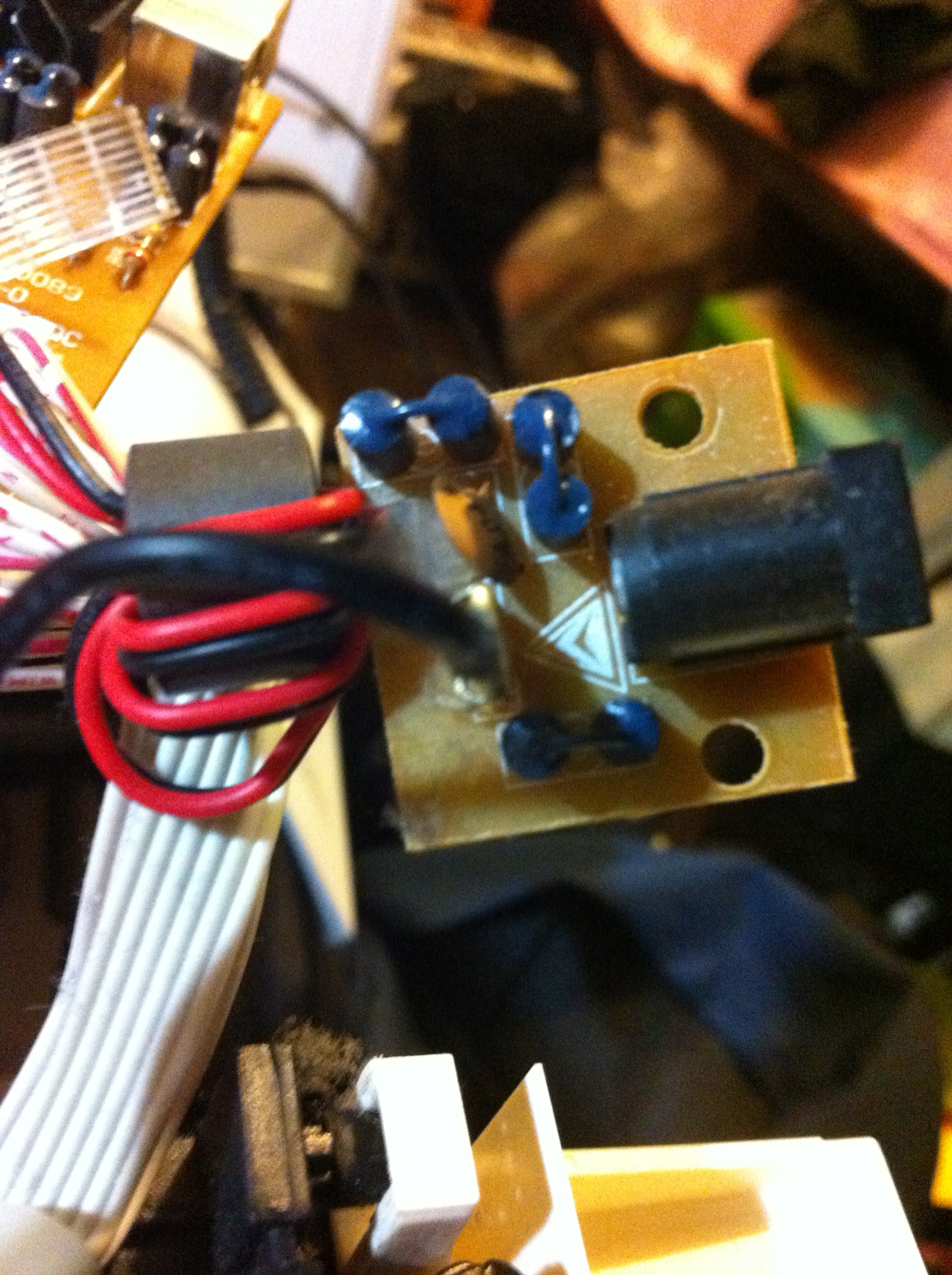

Am I allowed to post circuits of the keyboard my friend lent me to be sacrificed for this project?
I've got some questions as to what I've found and would like to know if anyone has come across this circuit and how I could transform it into a 1V/Oct input for my VCO(s) as well as pull out some trigger and gate signals. It has some built in mod wheels and buttons and is connected via USB, but also can receive DC power as the main source.

I'm thinking about donating the project to his garage and adding it to our little crew's arsenal for taking the music world over by storm..or something similar.. haha so in a sense, yes, he does expect to see it again, but this time, evolved.

Rest of the pictures.

Ok, somehow I was thinking Schematic, not literal circuit.
Both sides of each board are important.
Some idea how they are connected is important.
What is the keyboard? I think you'll get the most bang for your buck looking for a service manual.
