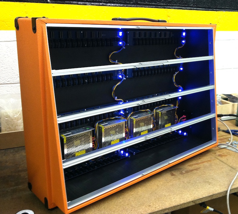

I was very interested in Monorocket's modular cases (a bit on the expensive side, but they look stunning)... what's putting me off is the use of Switch Mode PSU's.
I always believed that they introduced all kinds of nasty noise... has anybody had experience using them instead of a regular linear supply?

Don't be so quick to judge. For example, The Buchla 200e series uses a switching PSU... as do a lot of modern synths and audio pedals.
What matters is the actual specs of the PSU: ripple, switching frequency, smoothing caps, etc.

With high switching frequency comes EMI. These do appear to be well shielded though.

Out of curiosity I bought a Mean Well T60B, I have to say that it looks very similar to the Monorocket PSU's
It outputs +5 (5A), +12 (2.5A) and -12 (only 0.5A).
I've temporarily put it into the modular I'm currently building, and so far it's been great - it's just a shame that the -12v supply is only 500ma.
