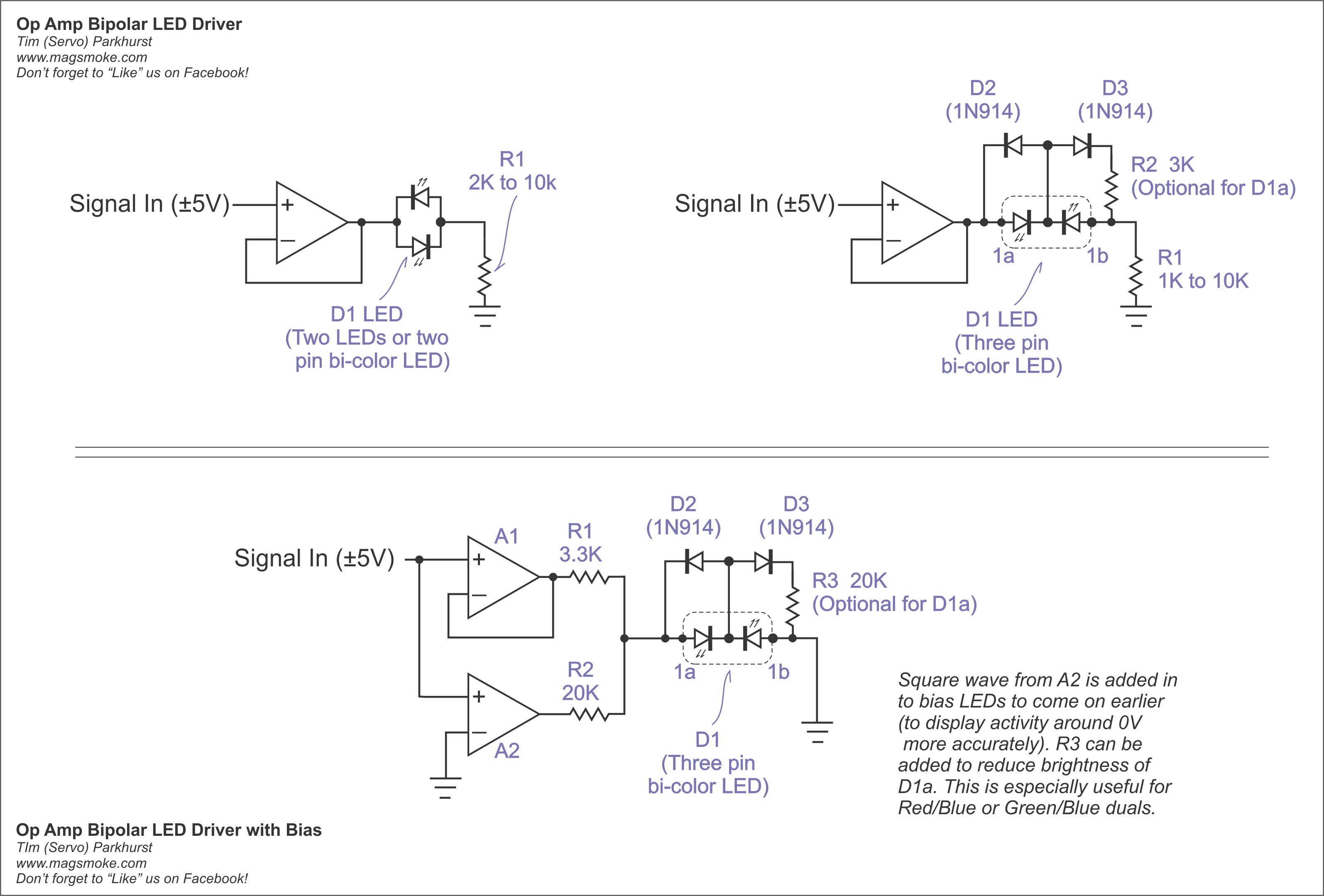

PostPosted: Mon May 06, 2013 6:00 pm    Post subject: A Collection of LED Drivers
Subject description: A driver for three-pin LEDs
Hi All,
Circuits for three-pin dual LEDs? Well I just happen to have something. Wink
First off, here's a slightly different design using an op-amp this time. The first is essentially the same as the one presented earlier. However, I build on that for the second design, using a couple of 'steering diodes' to route the current properly through a three-pin bi-color LED. Note that since you have different current paths, you can use a separate current limiting resistor for the second LED. Very handy for those red/blue or green/blue pairs where the blue LED always seems too bright. Note that this design is for a common cathode dual LED. To use this with a common anode part, simply reverse the direction of the two diodes. Also, you can use 1N914 or 1N4148 diodes.
Now with the first two designs, we get back to the same old problem I originally wanted to address with the transistor based versions: I want something that shows the full range of the input waveform, including activity around the 0 volt region. To get around this, I created the third design. This one uses A1 as the standard buffer, and A2 is set up as a comparator. The signal from A2 is added to the signal to bias it up for the positive half of the input, and down for the negative half. This makes the LEDs come on a little earlier (normally they don't come on until you've reached the forward voltage drop - anywhere from 1.7 V for red up to a little over 3 V for blues). Play with the values of R1 and R2 to get the results you like (one example, 4.7 K for R1 gives a smaller region around 0 V where the LEDs are off, although the on/off transition is a little less smooth). Of course, you can use this design with two-pin duals or even two separate LEDs.
Of course, these are good drivers if you don't mind throwing an op-amp or two at the design. Most of the time that's not a problem, but I am working on a dual LED driver using transistors. With two transistors, it should be fairly easy, but I'm going to see if I can do it with one. Stay tuned (also, I usually post these on the Magic Smoke Facebook page first, so you can see them earlier there if you're really in a hurry). Smile
Tim (I'm a good driver a very good driver) Servo

PostPosted: Thu Sep 03, 2015 3:32 pm    Post subject: Reply with quote  Mark this post and the followings unread
hi -
i came to this thread to look for a circuit that can drive an LED with a bipolar input. i see what seems to be two solutions: 1. a half-wave rectifying LED driver that only uses one polarity of the input voltage and 2. a circuit that splits up a bipolar input across two LEDs.
is it possible to use a +/-5v signal to drive a single LED from off-to-on?
thanks..

promocode
Joined: Sep 03, 2015
Posts: 5
Location: usa
PostPosted: Sun Sep 06, 2015 12:34 pm    Post subject: Reply with quote  Mark this post and the followings unread
Yeah, my understanding is that a vactrol is an LED and a LDR. General vactrols mainly work for a single polarity and most LED driver designs are for a single polarity (or split between two opposite-going LEDs).
I'm trying to figure out how to drive an LED, with -15v being "totally off" to +15v being "as bright as possible".
Is there a way to do this?
wackelpeter
Joined: May 05, 2013
Posts: 461
Location: germany
Audio files: 10
PostPosted: Sun Sep 06, 2015 12:58 pm    Post subject: Reply with quote  Mark this post and the followings unread
maybe with an opamp amplifier with negative gain or negative amplification or whatever it is called.. reducing the voltage swing from the +/15 on the Input to maybe +/- 2,5V at the Output... and then some positive Offset to the Output Signal so that it swing effectively between gnd and +5V...
but in that case you would have when you say put an LFO with +/-5V Amplitude into this only an output range of 0V to 1,8V that would drive the LED i think...
