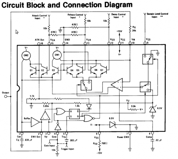

The caps I'm talking about are on the gate buss and pins 4&5 of the CEM3310 chips. I don't think they are bypass caps but I can't say if they are timing caps...
What do you think?
Here is a detail of the schematics (but as you can see on the picture posted above, these chips are 10nF in "real").
Edit: and a detail of the datasheet.

EDIT: well, on the datasheet they put a 3nF in this place... so is it critical to use 10nF?

Ah, much better.
Pin 4 is the gate input, pin 5 is the trigger input. Gate fires all four stages in sequence, trigger is used for multiple trigger and re-triggers the DR stages. For systems that do not use a separate trigger signal (such as the OB-X) you can simply couple pin 5 to pin 4 via a cap. The cap simply converts the gate signal to a short pulse for trigger.
Probably the only difference between the cap values is the lower value cap (1nF) is better for fast playing.

@ Real MC: thanks! so I've stuck to the schematics with 1nF caps.
