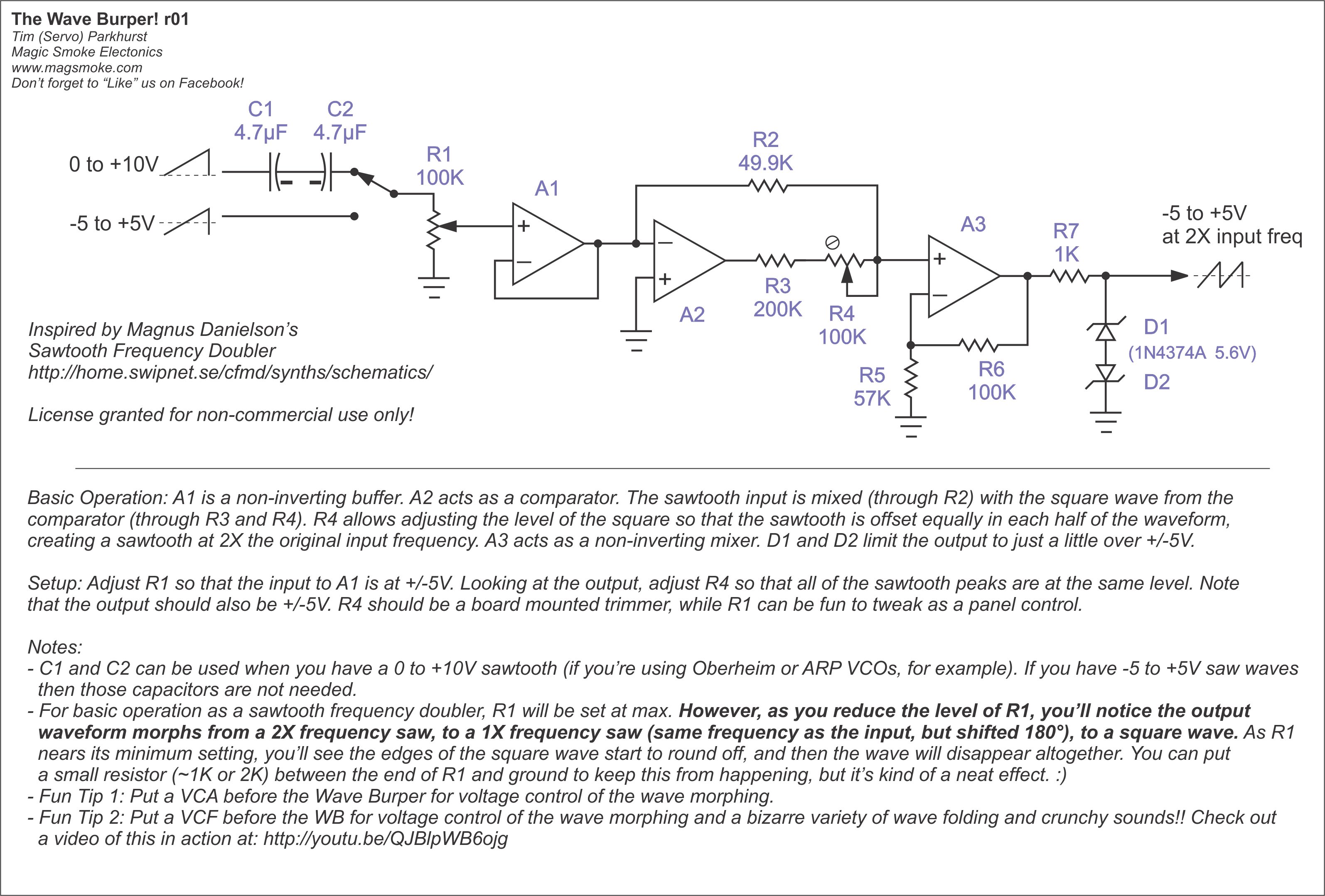

Here's a weird little circuit I came up with the other day. I started with a sawtooth frequency doubler designed by Magnus Danielson, and made a few tweaks of my own. The result is a mangler that I have dubbed "The Wave Burper." I made a video of it in action at
http://youtu.be/QJBlpWB6ojg
It will normally act as a sawtooth frequency doubler, but as you vary the input level, the output will morph from 2X frequency saw to 1X saw to 1X square. You can put a VCA in front of the WB to get voltage control of the wave morphing. However, the real fun starts if you put a VCF in front of the Wave Burper and turn up the resonance a bit. I used a Mankato VCF in the video (of course). I would think of offering a PCB, except it's such a simple circuit that you can knock one out with a bit of perf board in an afternoon (or less!). Have fun!
Tim (Expert Burper) Servo

A couple of notes on the Wave Burper schematic:
1. The vaules in the schematic are for +/-12V operation. For +/-15V, you might want to increase R5 a bit to keep the output at +/-5V. I think I used 75K, but you can experiment to see what works for you.
2. The zener limiters on the output (D1, D2) aren't absolutely necessary, but I found that with some VCFs in front of the WB (especially the Oberheim SEM in Band Pass mode) could produce occasional peaks that went WAY beyond +/-5V. I put the zeners in there to tame those, and I also like the smooth clipping they give when the signal level jumps up.
I hadn't really thought about two Burpers in series... could be fun. Smile

magneticstripper
Joined: Jan 12, 2009
Posts: 25
Location: San Francisco
PostPosted: Mon May 27, 2013 3:44 pm    Post subject: Reply with quote  Mark this post and the followings unread
Super cool Tim!
i built it with 5.1v zeners and 68k for R5. Looks like it is still in the +-5v range. i used a 1.2k between R1 and the Ground, pretty solid square on the waveform start. Once again, Great unit Tim! Thanks!

Tim Servo
Joined: Jul 16, 2006
Posts: 924
Location: Silicon Valley
PostPosted: Wed May 29, 2013 12:17 pm    Post subject: The Wave Burper! Reply with quote  Mark this post and the followings unread
D'oh!! Yes, that's supposed to a 1N4734A, 5.6V Zener. This is the 1 Watt version, which is way more power than this diode should ever see, so you could also use the 1/2W version if that's what is available. As noted by Magneticstripper, the 5.1V version seems to work okay too. It probably just begins to clip at a slightly lower level.
