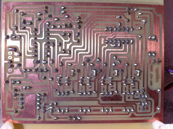

I don't really have anything else to offer except that almost all my problems with boards I've etched have been the result of accidental solder bridges or gaps in traces (which can be very small and hard to see with the naked eye). I tracked them down by testing continuity with my multimeter on anything that didn't look perfect. A magnifying lamp or microscope is a great thing to have too.

i took some pics outdoors this morning, hope they are better.
 Filesize:  2.14 MB
 Viewed:  105 Time(s)
 Filesize:  2.32 MB
 Viewed:  105 Time(s)
 Filesize:  1.84 MB
 Viewed:  115 Time(s)

Well I checked the board and it looks all good.
So as you asked, it might be a problem either due to a defective LM3900 or a bad matching of the BC557 pairs.

ok, i found the problem after tracing the audio path.
it was a "bad" TL074!
i tell you... those Chinese ebay sellers Evil or Very Mad
now its not buzzy any more.

Hi Yves.
just wanted to let you and the guys that the weird non symmetric sine wave was coming from the same TL074.
its TI chip and i upload a pic for you and the guys just to see and not use them!
when replaced the TL074 to other brand (ST) the sine wave was perfect!
thank you for your help.
 Filesize:  493.66 KB
 Viewed:  105 Time(s)
