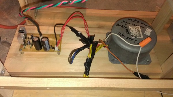

Posts: 2057
PostPosted: Tue Jul 02, 2013 12:37 pm    Post subject: Reply with quote  Mark this post and the followings unread
The 36V CT transformer used for the 15V supply is salvage. As such it has a number of secondaries that are other values that I'm not using. It had fuse holders in line with the primary and some of those outputs including the center tap of the 36V CT secondary, and I retained those. The main fuse is listed as 5A and the 36V secondary fuse is listed as 3A. This is as it was when I bought it, so I haven't felt I needed to change the values. I've included a photo below.
As stated before, I have no other in-line fuse holders, and no easy access to them (I haven't looked at Radio Shack lately, but their selection is generally poor for anything but the most common of items).

Osal
Joined: Aug 16, 2011
Posts: 147
Location: Here
PostPosted: Tue Jul 02, 2013 2:36 pm    Post subject: Reply with quote  Mark this post and the followings unread
Interesting transformer! I have some questions if you could check it:
Is it full encapsulated also in the other side?.
What is its current rating?
Could you measure the actual AC voltage across the secondaries?
This must have a mistake. I explain how to calculate it in the second post here
Since you are using the LM7815 regulator you don't need a fuse in the secondaries. The regulator has already short circuit protection.
You could use that fuse holder for the other transformer!
electronic-sea.net

Posts: 2057
PostPosted: Tue Jul 02, 2013 3:45 pm    Post subject: Reply with quote  Mark this post and the followings unread
Osal wrote:
It is fully encapsulated, there's a sheet of metal on the other side as well.
I've made notes on the top as you can see in the photo, those were taken from the spec sheet I got with the transformer, written on there simply to make it more accessible.
So I have 36V CT at 5A, 4V CT at .5A, and 28V at 5A (no, that .5A is not a typo, it's listed as 500mA on my sheet)
I measured them with no load to distinguish for certain--the sheet says "yellow red/black/yellow red for the set I want, hence the "YBY" on the top--and the color difference left me uncertain so I measured them all. It's been a while, but the values were sufficiently close that it was clear which set was which.
You cant read the label clearly in the photo, but this is a TPZ81V001M by some japanese company.
One other oddity: the primary has a third tap as well, it is drawn as being close to the orange tap. The primary winding is white to orange.
I went ahead and attached a photo of the sheet....

piedwagtail
Joined: Apr 15, 2006
Posts: 283
Location: shoreditch
PostPosted: Tue Jul 02, 2013 4:22 pm    Post subject: Reply with quote  Mark this post and the followings unread
That has to be the biggest transformer used in Synth-diy!
I'd use both the 36V centre tapped and 28V secondaries you've got two supplies there.
x1.414 they are both capable of +/-15.
You must have enough current for anyhting you'll ever build!
Surprised the regs stood up for so long having to drop such high voltage without heatsinks.
I'd use large screw terminal household block to replace that black modernist sculpture of tape seen in the picture.
Robert
mmm, that sheet doesn't seem from the manufacturer. The transformer is big, but I don't think that it is big enough for these specifications. I would test it to be sure of its real current rating.
Due that the transformer is manufactured in Japan, it could be to use it with the Japanese mains voltage (100VAC) or with 120VAC
I can only say what I have in my information and what it says on the fuses. Smile I'm fairly sure these are not slow blow fuses, if that makes any difference.
Try to replace them by slow blow fuses.
I definitely do not know the overall VA rating of the transformer.
We can determine it. Just a few power resistors and a multimeter reading AC RMS voltage. In addition a K-prove or an infrared thermometer would be great.

elmegil wrote:
The only other chunks of metal I have are all sheet metal, mostly aluminum plate I use for panels. Not sure how much mass I need to dissipate the heat though...
I measured the temperature of LM317/LM337 packages in my PS1. Using an anodized aluminum sheet of 425mm*260mm*2mm, I estimated that the maximum current that the power supply can produce is 0.8A. (Considering the following worst case situations: 40C of temperature ambient and a 10% of high fluctuations in the mains electricity)
You could use a 3mm sheet and reduce the area by say 2. I guess. It need measurements.
The other way is to calculate it and use a commercial big heat-sink.
