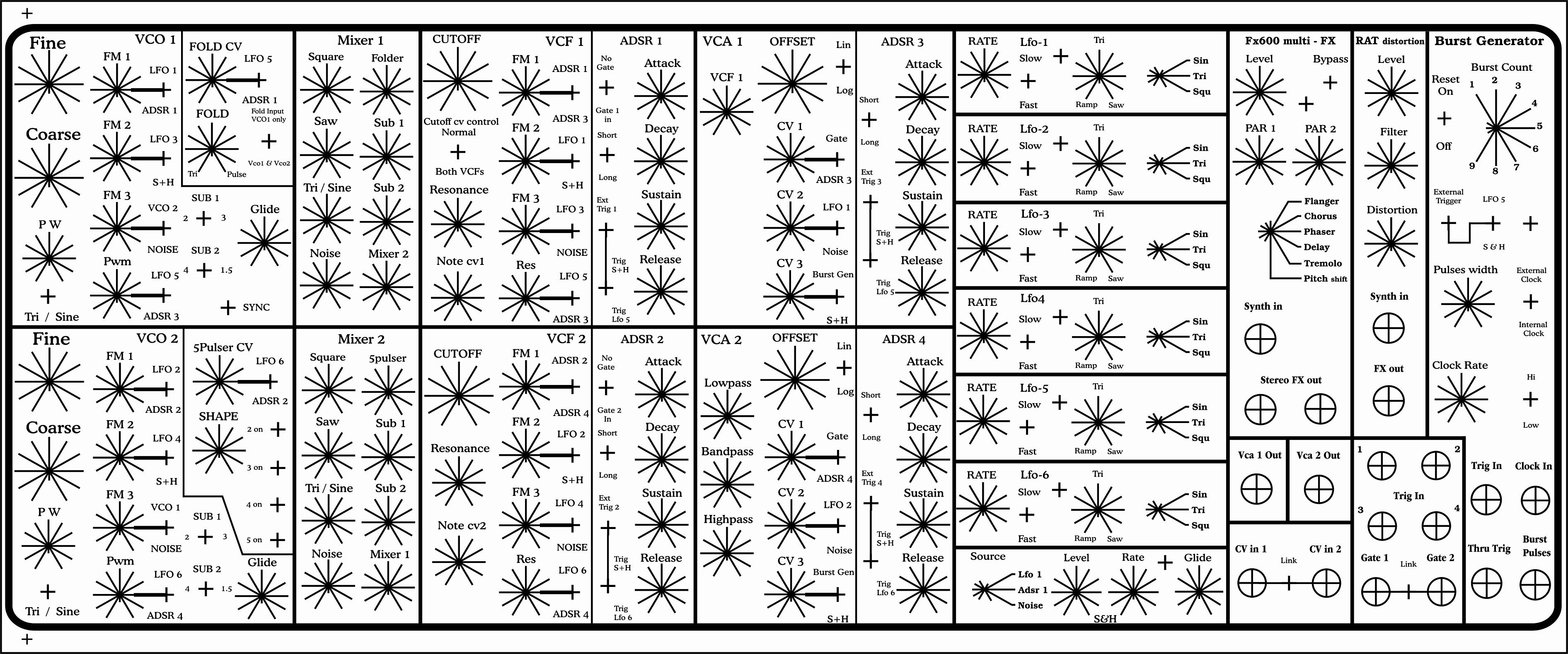

Hi Ash , i've got +/- adsr on my ASM-2 synth i built a while ago , im going for what i've got so far , thanks for the link tho , cheers.
Here we have the final Panel layout , going to mull over it this weekend to see if i've missed anything Smile
Dave.

Hi.....
Fixed a few alignment mistakes and i have double checked that the jack socket & switch retaining washers & nuts do not foul any text .
A few things i've squeezed in at the last min.
Two level pots for the input to the lockhart wavefolder.
A switch to cut the gate in to the filter ADSR's 1&2 so they can be triggered seperate from the VCA- ADSR's 3&4.
I think i've ironed out all the little errors now , the final final panel before vinyl printing Cool

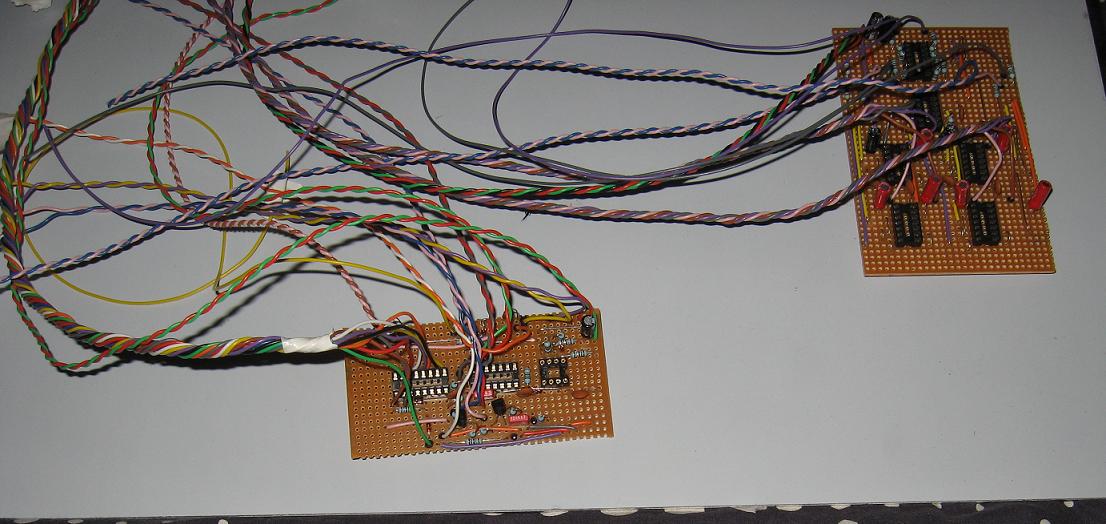

Some of the smaller stripboard circuits , CGS burst generator and Roman Sowa frequency dividers, now wired and ready to test , all the main modules are coming from the modular.

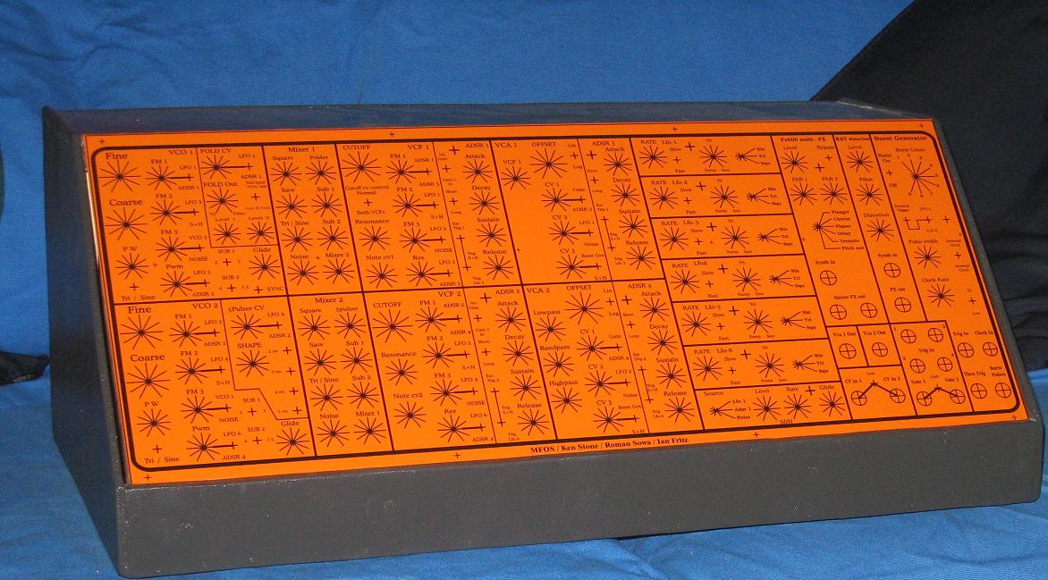

After doing some tests with the light purple vinyl and the black text i decided on the orange colour for better contrast of the text & dials.
After getting home from the printers shop with 2 prints of the panel (it was quicker to do the drill template the same colour) , the good finishing print is lying in wait for the drilling to start over the weekend Smile
A quick pic of the drill sticker'd aluminium sheet sitting in the wooden case.
Dave.

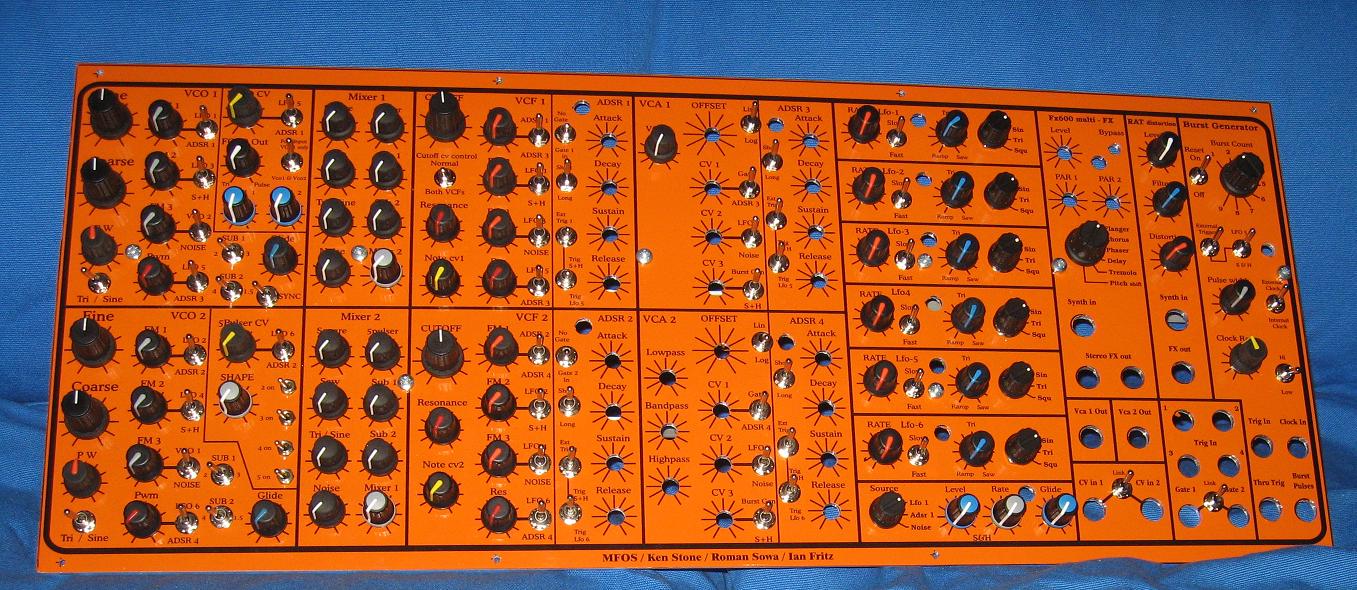

PostPosted: Sun Sep 22, 2013 1:16 am    Post subject: Reply with quote  Mark this post and the followings unread
Out of bed early this morning to start fitting the toggle switches , starting to take shape now Smile

PostPosted: Sun Oct 06, 2013 4:58 am    Post subject: Reply with quote  Mark this post and the followings unread
Hi , slowly coming together, been chipping away after work , built the noise circuit from the mfos ultimate on stripboard, some buffers to distribute cv's & gates to different areas of the synth , and ive stripped down 2 vco's / 2 vcf's & 2 ADSR's from the main modular , need to lengthen the wires going to the new panel.
Also sorted out my wedge case power supply.
The panel so far ....

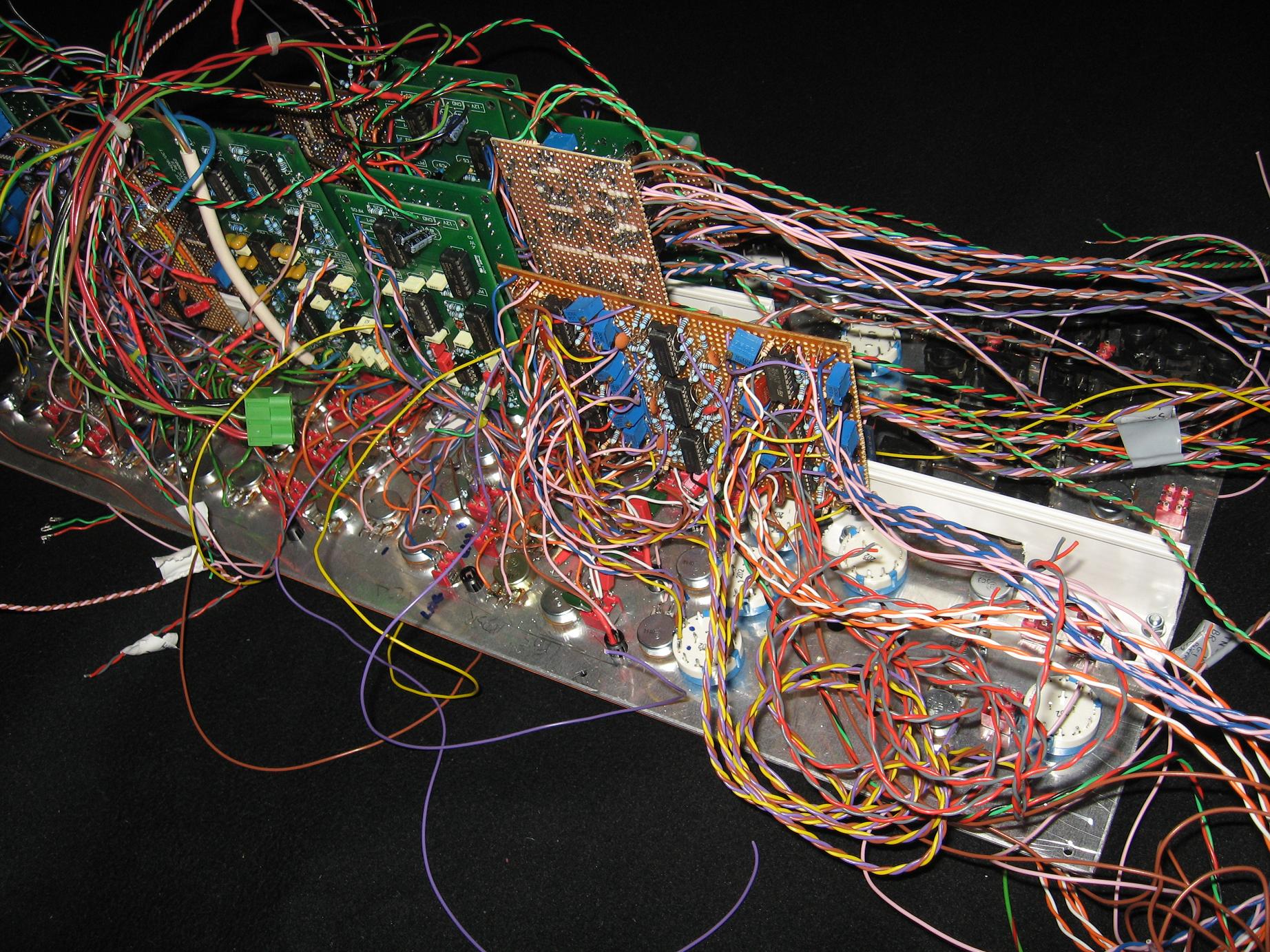

Wires wires wires , just enough room to fit boards 18 / 19 & 20 on the white "L" bracket (2"x 2" Electrical containment pvc trunking sawed to length & bolted to panel) .
Couple of silly faults found only on my veroboard circuits .... 2 surplus isolator holes , bridged now and a resistor leg in the wrong hole, fixed now , and a red faced moment when the 6 lfo's were pulsing crazily and randomly , yes, i had not connected the 0V ground tail wire for all the pots to 0V at the supply , deary me , heh , nevermind .
Here is another pic at the latest stage , getting busy round the back of the panel now.
Dave.

2 more boards fixed in , a Ken Stone burst generator , hooked it up to the scope after no-chip test & "is the chip/chip's getting hot" test , passed both Smile Smile and it seems to be bursting with trigger pulses quite good , and the other board is the level converters for the stompbox fx circuits.
Next job , de-box & dismantle a Behringer FX600 pedal & transplant into the synth , this and the Rat distortion have to be patched on the panel , i thought about hard wiring them but there was room for sockets Smile
another pic of round the back
 Filesize:  369.3 KB
 Viewed:  292 Time(s)

PostPosted: Wed Oct 23, 2013 11:49 am    Post subject: Reply with quote  Mark this post and the followings unread
How are the boards supported? It looks like it might be a lot of weight on the larger boards if they are only supported at the front.
JacobWatters.com
Posts: 1196
Audio files: 155
PostPosted: Wed Oct 23, 2013 12:21 pm    Post subject: Reply with quote  Mark this post and the followings unread
Hi Jake , the boards don't flex when it sits in the box ( i've peeked inside with a torch Very Happy , i was curious last week ) , each has 2 fixings per board to the bar , there is not a huge weight in a populated board and the wiring acts as soft brace , it will never go on the road because it's power supply comes from the blue monster's substation Very Happy

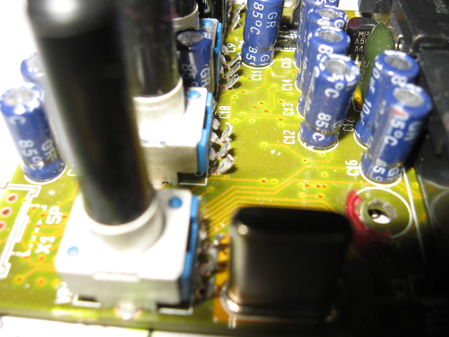

FX dismantle & wiring this weekend Smile.
I have taken the pcb out of the stompbox case and it looked quite difficult to take the pots off the manufactured pcb without damaging tracks so, i decided just to snip the pot legs with cutters , leave the pots in place but not connected and run wires from the snipped legs sticking up from the pot thru holes and sleeve them with heatshrink , this allows me to re-assemble the stompbox if i ever need to , unlikely Smile.
All the pots are 47K , easy job , but the fx type selection is operated by a pot , im going to change this to a rotary switch with resistors between the poles to emulate the fx select pot action.
the last board , hurrah ! Smile
