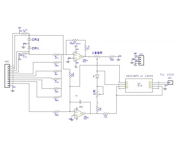

Subject description: I built a Bernie Hutchins sawtooth VCO and can't get it to work properly
Can anyone help me out here? I'm losing the will to live.
My 3rd attempt at building an integrator + reset sawtooth VCO.
I'm following the schematics for the ENS 76 VCO option 1:
http://www.synthsource.com/ens76/vco2.htm
But for the exponential converter I'm following Ian Fritz' Sawtooth VCO schematics:
http://home.comcast.net/~ijfritz/sy_cir2.htm
It doesn't make any sense: all I get is a vaguely trapiezoidal wave at ~200KHz. Panel controls don't make any difference.
Sorry about the DesignSpark schematics - I've tried to make them as readable as possible. Panel controls are on a separate board and are not shown, but they closely follow the Ian Fritz schematic with the addition of an extra exponential FM control+socket.
And this is the exponential converter
 Filesize:  78.08 KB
 Viewed:  199 Time(s)

Ah. Ouch!
Too many variables, but I'm determined to get a reliable design together. I'll try a linear current source with it. I've been going down the road of gradually splitting everything into it's component parts, which is why I'm only building the core of the VCO here.
JFETS - they do seem like a poisoned chalice in terms of reliability and specification. I am thinking that maybe a fast analogue switch like 1/4 of a CD4066 would be better.

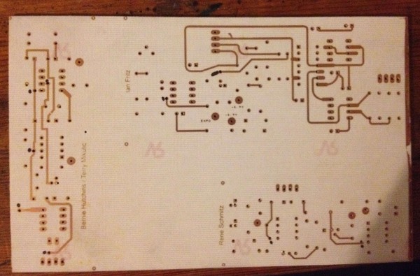

OK. I'm beginning to realise how critical the choice of op amp is for many of the designs I find out there! Apologies for using the "TL071" symbol in my schematic - it was a means to an end to get a working symbol/PCB component. I realised I had a fairly bogus Eagle op-amp library I imported into my CAD package with the wrong pinouts, and had to go with the crappy downloadable part spec from the software makers :-/
So, the TL071 is actually an LF351 in the circuit. Forgot to mention it, sorry! I was going with what Bernie Hutchins wrote that "You can also use an LF351 for the CA3140. You can also use an LF351 for the CA3130, but it would be run on the bipolar supply, and without the 39p compensating capacitor." (source: http://www.synthsource.com/ens76/vco4.htm )
It seems that this is incorrect. It didn't work.
So...I've bought a load of components: CA3130 and CA3140, OPA2132 (can't seem to get the OPA132 in the UK) LM311 and LM319 comparators, LM329DZ precision regulator and a bunch of other tightly spec-ed components (2N4391, 2N4859, 60K4 resistor etc). And, I've made a board with three different saw cores on it which (if my kids let me) I'll solder and test over the weekend.
Hutchins / Mikulic (ENS 76)
Rene Schmitz
Ian Fritz (with the other half of the LM319 used for PWM)
I still have the expos I made from Ian Fritz's design so I'll plug them in once I know the saw cores work (I'll knock up a linear current source to test them first).
Only top copper is shown. If they all work as intended, and if there is some interest, I'll make the design available here.

PS jackdamery, thanks for your tips. The most useful here. I need to understand the relationships between reset time, slew rate and capacitor value. I'll experiment with what I've got.
Thanks,
Ed
