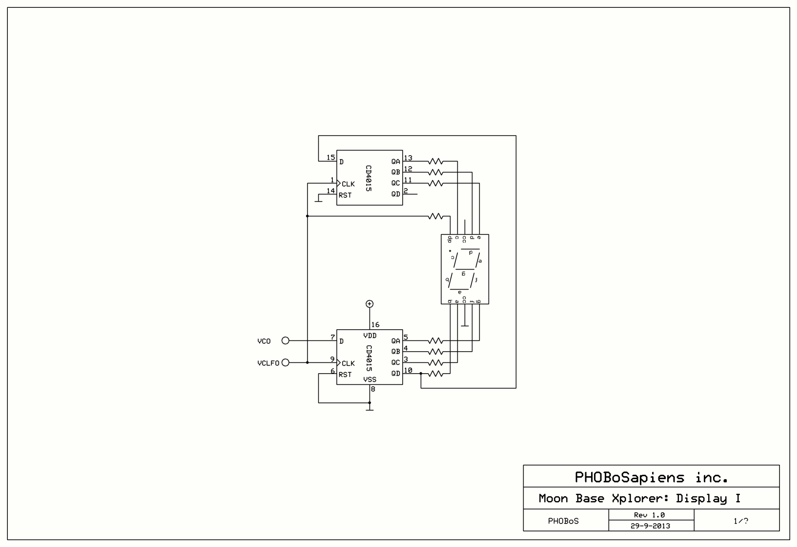

PostPosted: Sun Sep 29, 2013 10:59 am    Post subject: The Moon Base Xplorer
Subject description: LED display I
connecting a 7 segment LED display to a shiftregister and feeding the Data input with a fast oscillator and the CLK input with a slow one gives a nice
result Very Happy.
I also went through my collection of electronic toys to see if I had anything usefull. Most of it wasn't but I found one nice toy with 7 different sounds that
I like. It allready has a transistor to drive the speaker and by replacing the speaker with a pullup resistor to 12V (the circuit runs on 3V) I get a nice
(PWM) squarewave out. The sounds can be triggered with a connection to GND so that's easy to work with, allthough if I use it I probably won't add
anything but just some switches. It also has a resistor to control the pitch Cool .
 Filesize:  36.43 KB
 Viewed:  958 Time(s)

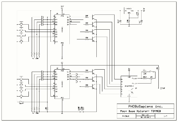

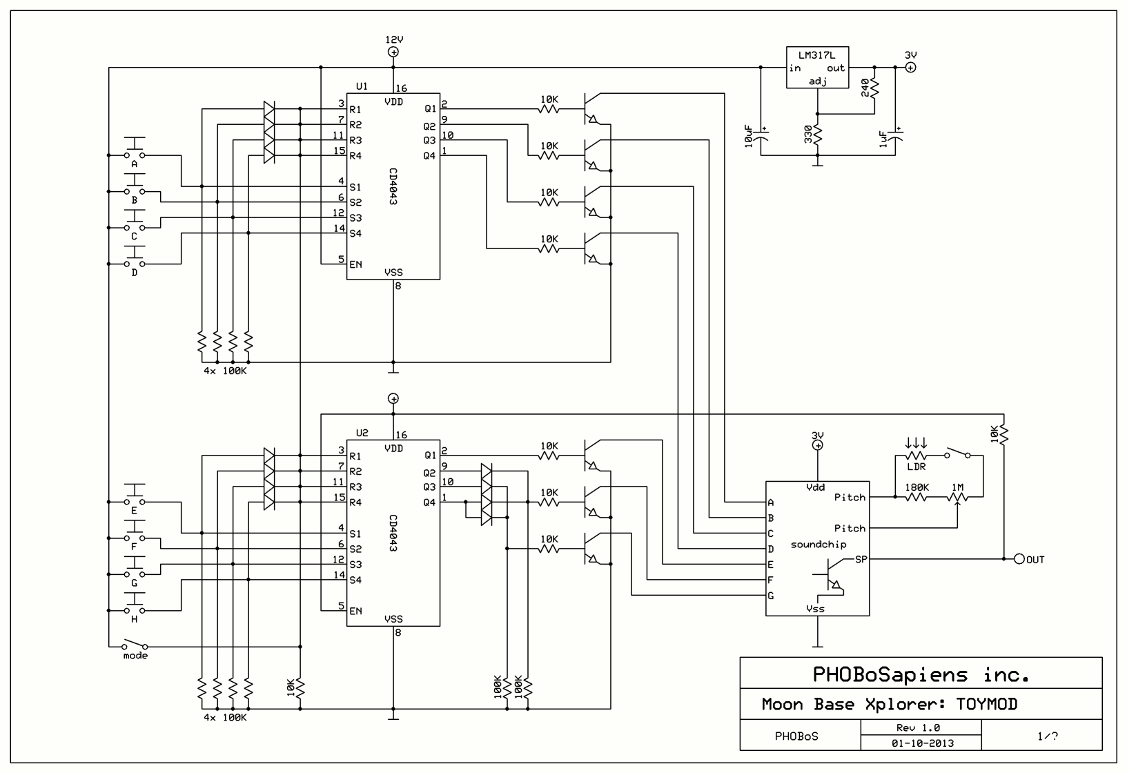

PostPosted: Tue Oct 01, 2013 10:49 am    Post subject: The Moon Base Xplorer
Subject description: TOY Mod
...if I use it I probably won't add anything but just some switches...
well, I am gonna add a little extra circuitry. A nice thing with this toy is that the sounds keep repeating if you keep a button pressed. So instead
of just some momentary switches it would be nice to add some on/off switches aswell. But the problem with that (besides needing more
switches) is that you would have to turn a sound off if you want to turn another one on, which is a bit of a hassle especially if you do it with one
hand. If you turn more then one on at a time you'll just get one of the other sounds*.
So that's where the circuit comes in. With the mode switch closed the buttons work like normal momentary switches, but with the switch open
they work like those on/off 'radio' switches. Which means that if you press a button it will turn the other ones off, and it stays on untill you press
another button or close the mode switch.
Because the sounds are triggered with a connection to ground I added some transistors that switch the inputs to ground. An LM317L takes care of
the 3V powersupply needed for the toy circuit. I cut the part with the chip off and left that part with the buttons intact so It's still functional. Maybe
for a midicontroller or small synth.
The electric typewriter I salvaged the buttons from had 1 on/off switch so that's great for the mode switch Very Happy The buttons I choose were on both
sides of the actual QWERTY keyboard so I left that intact for now (might come in handy for a timemachine if I can ever get that damn fluxcapacitor
working Wink). Maybe I'll add some LED's or just one connected to the reset inputs, so it goes on when a button is pressed or the mode switch is
closed.
*there are a couple of combinations that produce an 8th sound, so I used some diodes to trigger 2 inputs at once when button H is pressed.
note: at the moment the output is high when there is no sound so I'll have to invert it.
Moon Base Xplorer: TOY control circuit
 Filesize:  88.74 KB
 Viewed:  795 Time(s)
used toy and salvaged buttons
 Filesize:  93.74 KB
 Viewed:  629 Time(s)
PHOBoS - Moon Base Xplorer - toydemo.mp3
demo of the 8 sounds.
Download
 Filename:  PHOBoS - Moon Base Xplorer - toydemo.mp3
 Filesize:  726.13 KB
 Downloaded:  1400 Time(s)

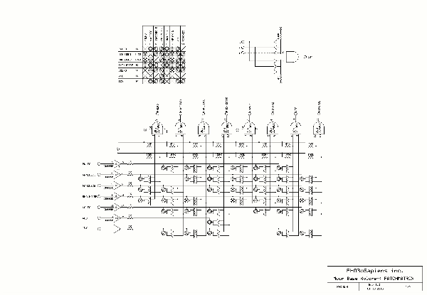

PostPosted: Tue Oct 01, 2013 2:06 pm    Post subject: The Moon Base Xplorer
Subject description: Patch Matrix
I underestimated the number of possible connections for the patchmatrix a little bit but its doable. I was actually thinking of using switches with
build in LED's instead of connectors, but after seeing how many I would need I quickly dropped that idea.
One nice thing about a patchmatrix is that you can easily link an output to multiple inputs, but I completely forgot that it's also possible to link
multiple outputs to one input. However if I would just make a very simple matrix then outputs would be shorted together when connected to one
input. So I need to do something about that. The nice part about this synth is that (sofar) it's mostly digital, so the signals can be added
together with some simple logic.
The easiest thing would be to OR the signals together using diodes and a pulldown resistor. But with a couple of input signals the output would be
high a lot of the time whch isn't very interesting. My next idea was some sort of multi input "XOR" that has a high output when only 1 input is
high. I did came up with a circuit for it, which I might post in the lunetta section, but wasn't really happy with the result. So I thought about it some
more and decided to use AND logic. so the output is only high when all inputs are high. If you connect 2 oscillators then the result is the same as
if one was gated by the other. Smile
I would need 6 input AND gates and I don't know if those are available as CMOS chips (there are 4 input AND's), but even if so than I'd probably
need a lot of chips, and it would be a lot of wiring too. Time for some more Mickey Mouse Logic. It's pretty easy to make a multiple input AND
with some diodes and a pullup resistor but for this use there is one problem, with no inputs connected the output is high. So I connected the
output to another AND gate and by using an OR on the other input the output can only be high if at least one input is high. But with no inputs
connected the inputs of the AND gate are connected to a voltage divider created by the pullup and pulldown resistor. So I choose a smaller value
for the pulldown resistor to make sure the output is low.
I'm planning on changing the NAND oscillators a bit so that's why they both have a gate input in the matrix. This is only the digital part btw.
(there aren't many analog signals yet)
NOTE:The output of the toy has to be inverted and I'll probably buffer it right away so I don't need another 4050 chip for just 1 gate.
first version of the patchmatrix
 Filesize:  118.26 KB
 Viewed:  766 Time(s)
