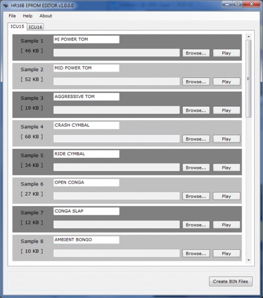

I have just finished an application for generating custom EPROM's for the Alesis HR-16 and HR-16B drum machines. It will allow you to add your own samples and sample names.
A sample package can be downloaded at the link below, which includes the manual, screenshots, and a set of EPROM files created using the application, that will replace the samples in the HR-16/HR-16B with samples from the TR-505, TR-707, TR-727, TR-808, and TR-909 drum machines.

HR16B EPROM Editor Interface
