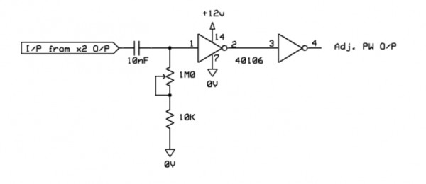

couldn't you resquare the waveforms to 50/50 pw with 2 - 40106 schmitt trigger gates?

PostPosted: Mon Jan 13, 2014 6:27 am    Post subject: Reply with quote  Mark this post and the followings unread
I hadn't ignored this, I was just thinking about it for rather a long time Very Happy . The output of the doubler circuit actually gives very wide pulses (i.e. a large duty cycle). The only way that I could think of using 2 40106 gates here, is to use an edge detector (or "half monostable" as it says in the CMOS Coookbook). I've tried this out (see circuit and scope traces below). I've managed to get a 50% duty cycle output, but the circuit still needs to be tweaked every time you change frequency. Am I missing something (I probably am...)?
BTW, the second gate here is optional, as it just re-inverts the signal (which may not be necessary). Also, due to the capacitor having to charge, there is a phase lag between the two waveforms, which gets worse at higher frequencies.
Gary
