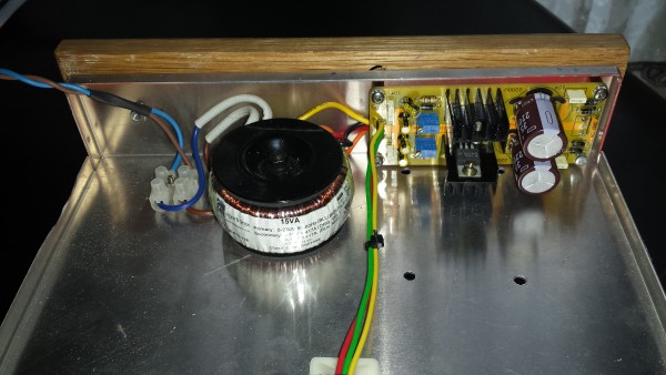

01012k7
Joined: Aug 31, 2013
Posts: 25
PostPosted: Sun Oct 13, 2013 1:29 am    Post subject: Reply with quote  Mark this post and the followings unread
hi guys me and a friend have been working this project we had the nomal problem with the XR 2206 batch 0919 the version I have now is the 0918 not shure if any one had this batch version I got it form littlediode was a round 7 pounds we tested it with a oscilloscope well a friend did as I am such a newbie Smile here a picture we are going to add midi to it I made the case and the box and the oak panels he did the wiring as it was very confusing Sad because he been into electronics for years and is a cad designer he done a cad drawing of the wiring. I try and get him to give me a copy also if we done any thing wrong it would be good to have feedback ..
 Filesize:  2.43 MB

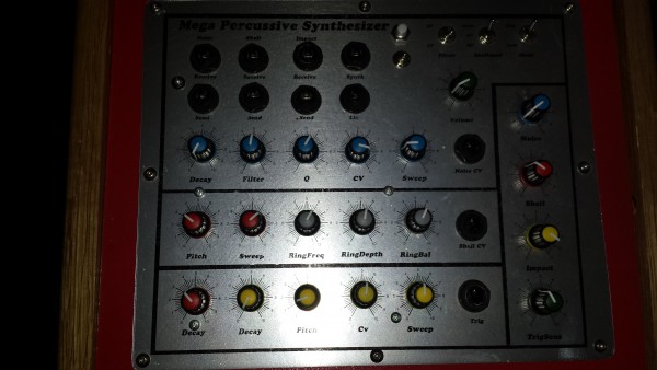

PostPosted: Sat Oct 26, 2013 2:00 pm    Post subject: Reply with quote  Mark this post and the followings unread
still have a few things to sort out like some paint work , screws ad some words for midi learn and midi in and stuff here the insides

Does the MPS absolutely need to be powered by +15v/-15V, or can I get away with using a +12v/-12v supply? I'd imagine there might be some resistor changes necessary. I only am asking because I have a 12v bipolar supply build from a previous synth that is currently unused. I could just get a larger transformer and swap out the regulators obviously but don't have a 15vAC supply on hand. Thanks.
